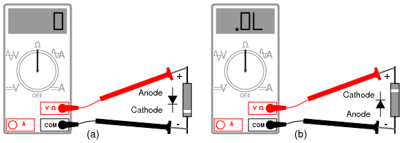

You could possibly detect if that diode is there by unplugging the IAC and the ECM and using the diode check function on your multimeter across the red and grey/white wires at the IAC. Should be able to read that diode across there without any interference from other circuitry.
Like Chris says, probably have not unwrapped the harness enough to find it. Very unlikely it's not there. If it does have to be replaced, something simple like a 1N4005 would work. Anything 1A and over 50 PIV should work.
Granted he didn't walk you through it step-by-step, but this describes what you need to do.
