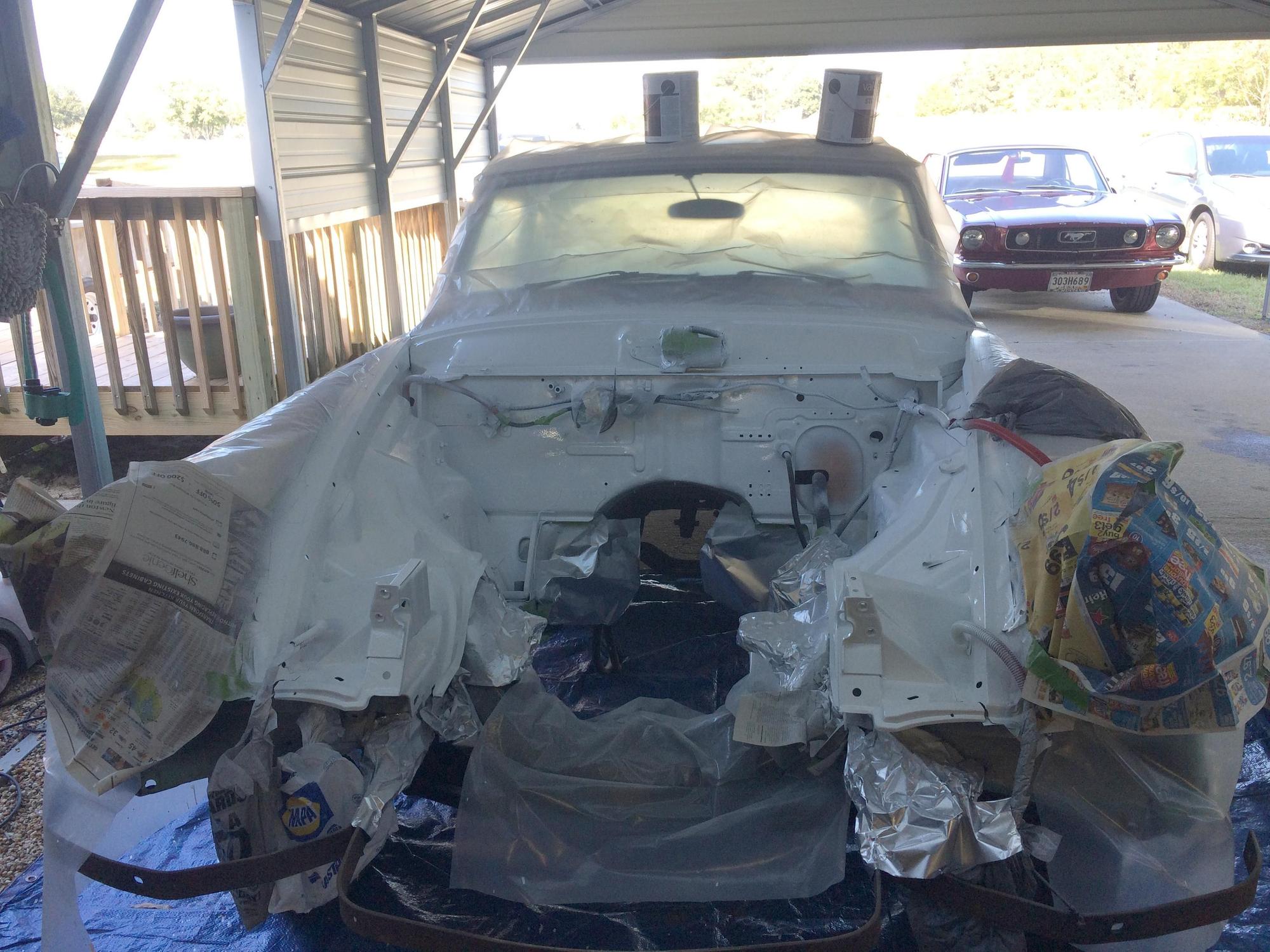

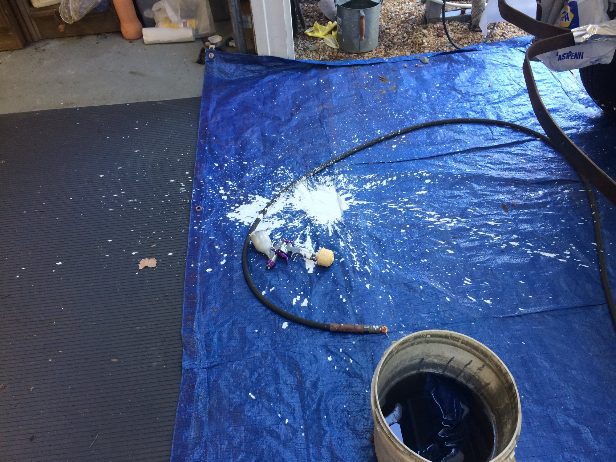

So today I finally got around to painting the engine bay of the Studebaker. One pass with the detail gun to get the hard to reach areas, and then I went to check to see how much paint I had left. Grabbed the lid to unscrew it, but it was not screwed on at all, must have just been a 1/4 turn cross threaded or something. Immediately popped off and the gun slipped from my hand and hit the cement! Paint all over my boots and my leg and in the process of cleaning up, all over my hands and arms. Worse than that, now the gun leaks. Just a cheap Harbor Freight gun that I have owned for about 10 years, so I guess it's no big deal. I was able to finish up the painting with my regular size gun.
What a mess

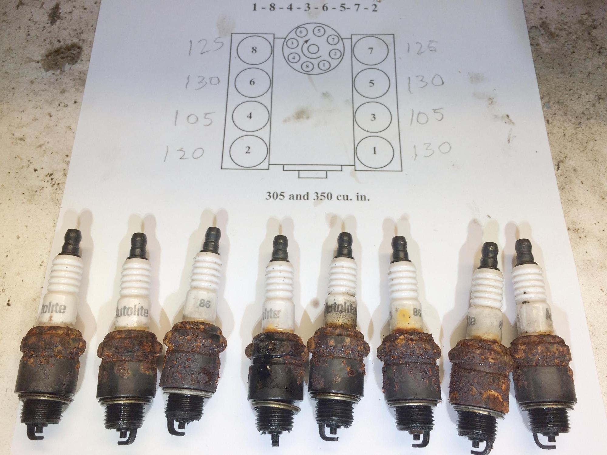

I have the screw in type. It has 14mm size with an adapter for 18mm threads, which is what I have on the Mustang.
Is there a number that they should be? I know you want them all within a few psi of each other. I thought like 10% which would be "close enough". But yeah I would like it if that #4 was 10 higher. Probably a rocker arm tightened a tad bit too much.
But speaking of numbers this was from a compression test on the 55 Chevy a few years ago. Much lower numbers.

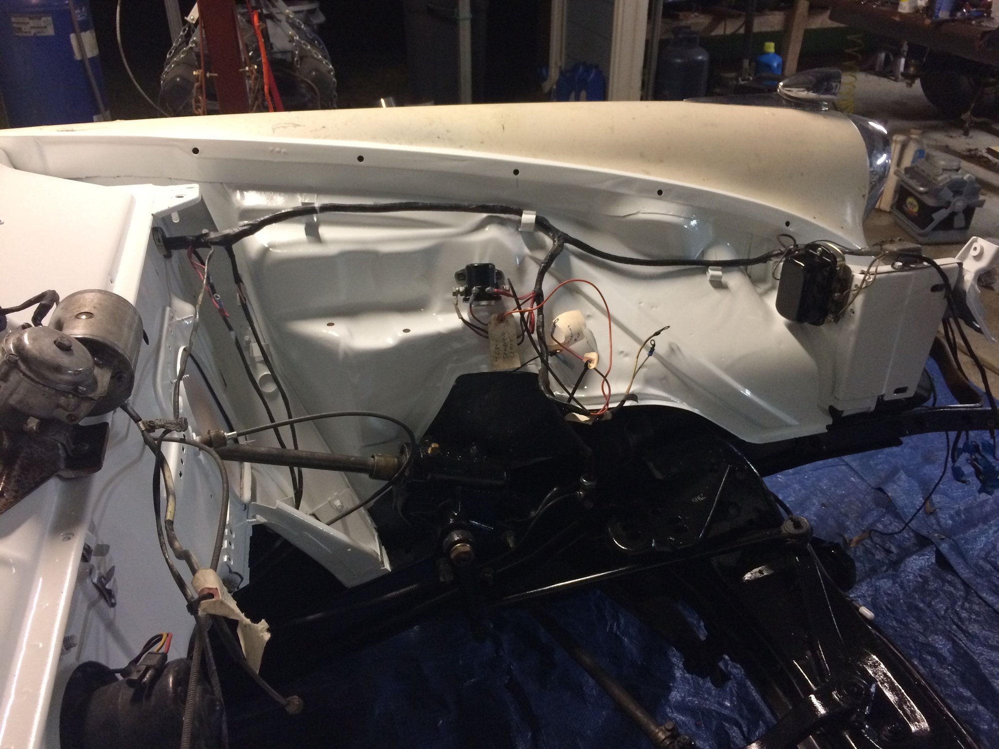

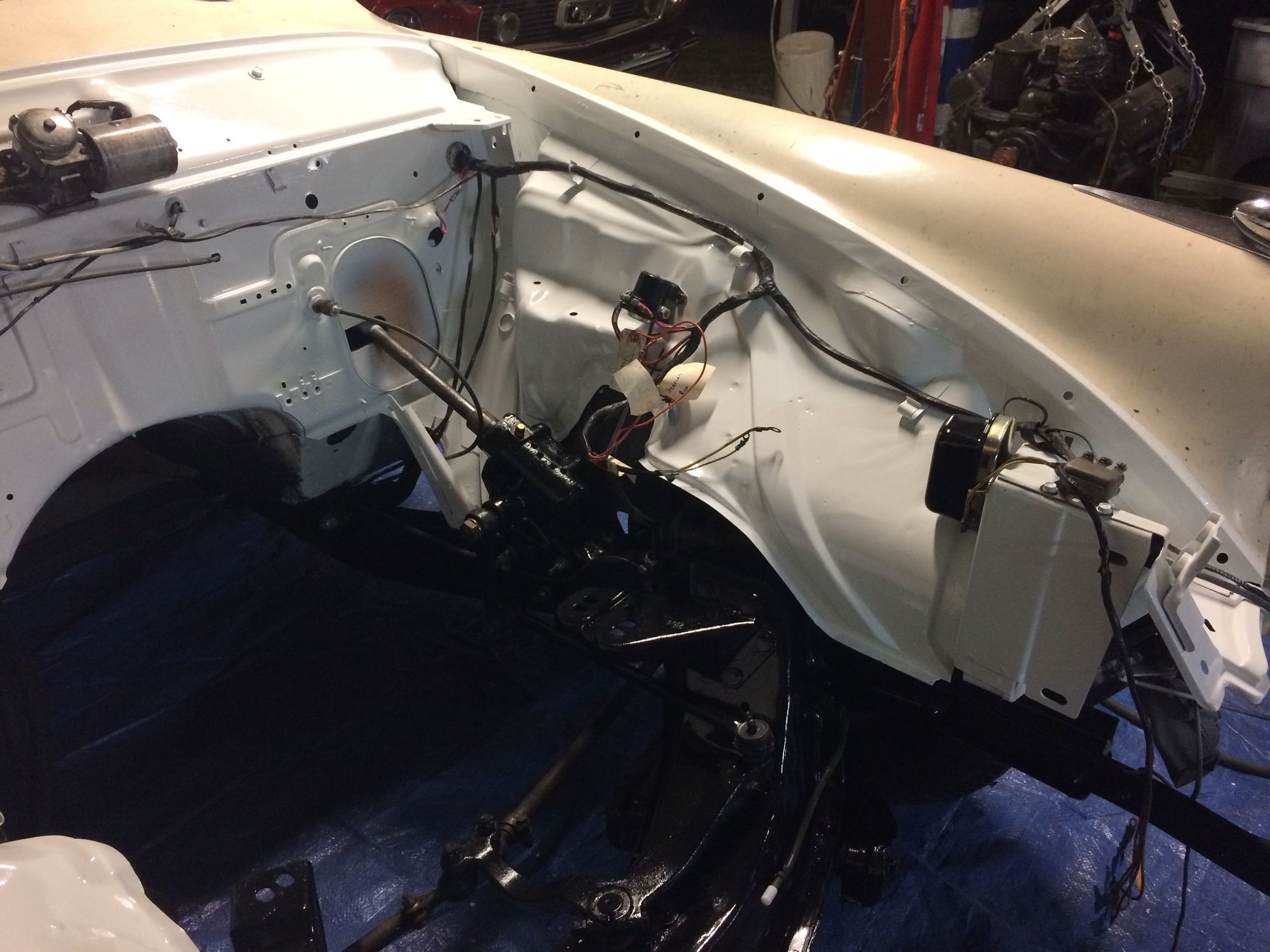

By the way, after the fiasco I got into when starting to paint the Studebaker engine bay, I did eventually finish up. Pulled off all the masking tape and put a few things back on like the voltage regulator and starter solenoid. It looks pretty good, there is some noticeable orange peel but once the motor is in there and all the hoses and wires run I don't think it will be much of a big deal. I went back over the frame and cross member with brush on rustoleum "topside" gloss black afterwards, because I had some overspray in a few spots.
