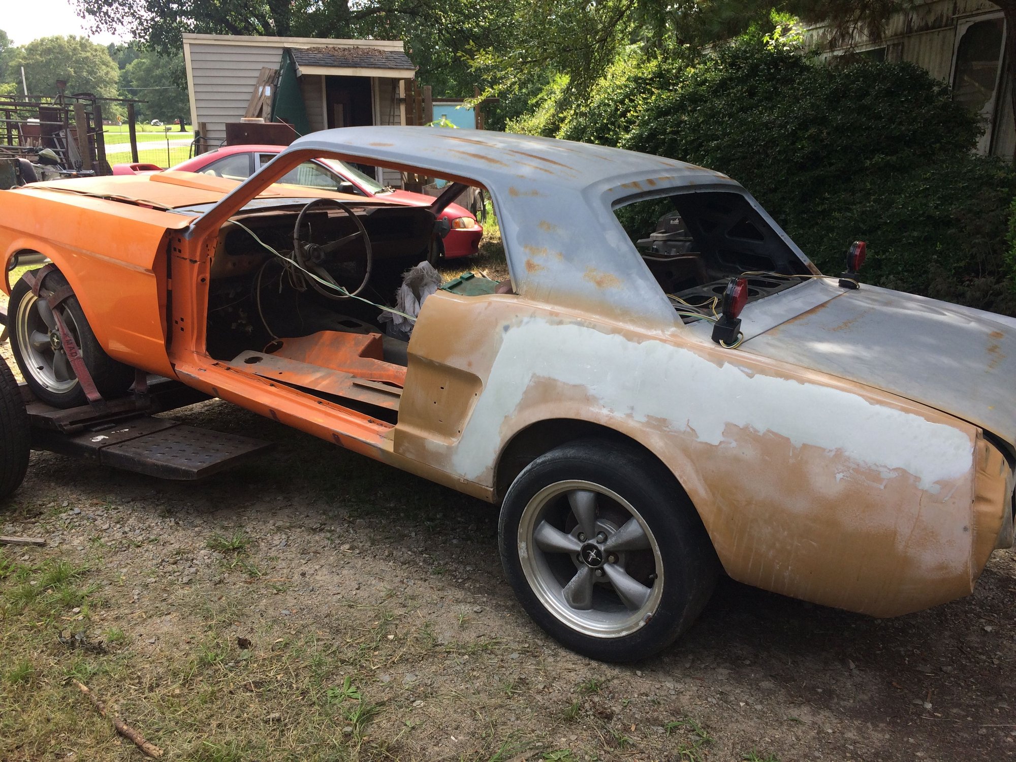

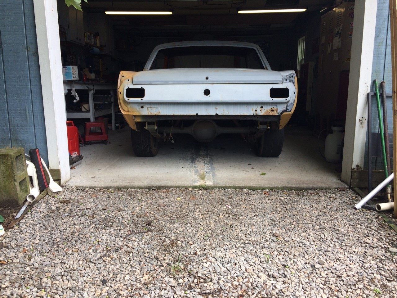

I got side tracked this week with whatever I was working on. Finally went to reclaim my 66 Mustang project. Been at my friends paint shop across from West Johnston since 2008. I guess it is back to square one!
Loaded up on the tow-dolly and heading back home. The hood scoop was not bolted down and started to raise up on the drive back so I pulled over and took it off.
Back where she belongs now. Daddy-Daughter project for someone who is now 30 years old. Shameful
The paint that he did put on 13 years ago is very sun-damaged and weather checked. It will have to be repainted.
I tried pushing the car into my shop but I couldn't get it up the slight incline! I just wasn't strong enough plus the grass was wet and my feet kept slipping. So I rigged up an old driveshaft and used the truck to push it. "There's always a way!"

I did not know the drivers side QT was just about done as the other side was just held on with screws.
The wheels on the car are they from a newer Mustang and 17"?

Actually, I think Danny was saying "I'm just about to ready to burn in that quarter" for the past 5 years. lol

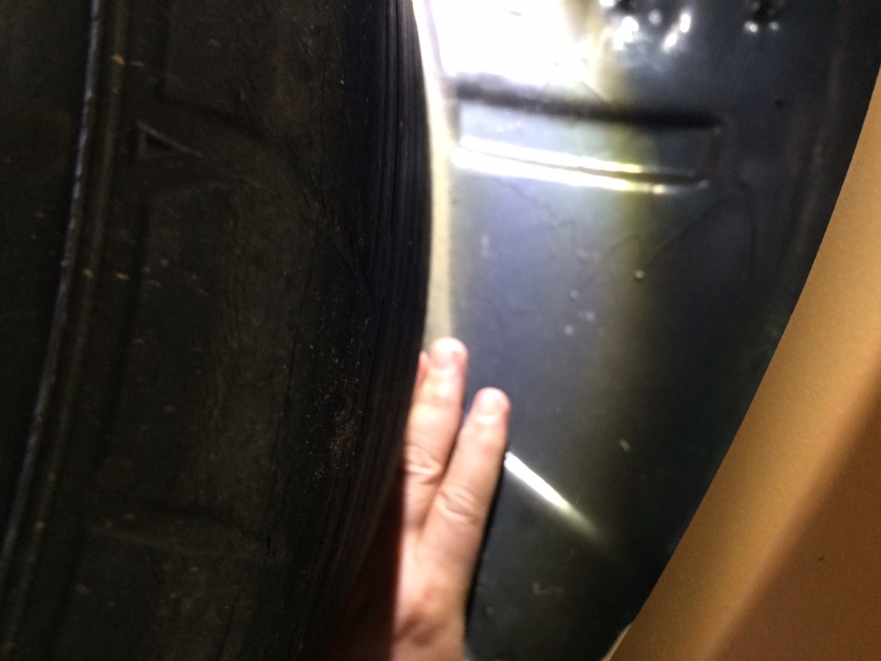

Yes, those wheels are 17x7 from a 2003 Bullit Mustang. Being that it is supposed to be a joint project with my daughter, I had let her choose wheels and that was what the wanted. At the time I tried to steer her towards a 15 that was more along the lines of a classic, like Torque-Thrust D, but she didn't care for them. Now that several years have passed I gently asked again, and she STILL likes those Bullitt wheels best. So I guess I am staying with them, they do look good but I just hate the 1 inch spacer / adapters that are needed to run the more modern wheels.

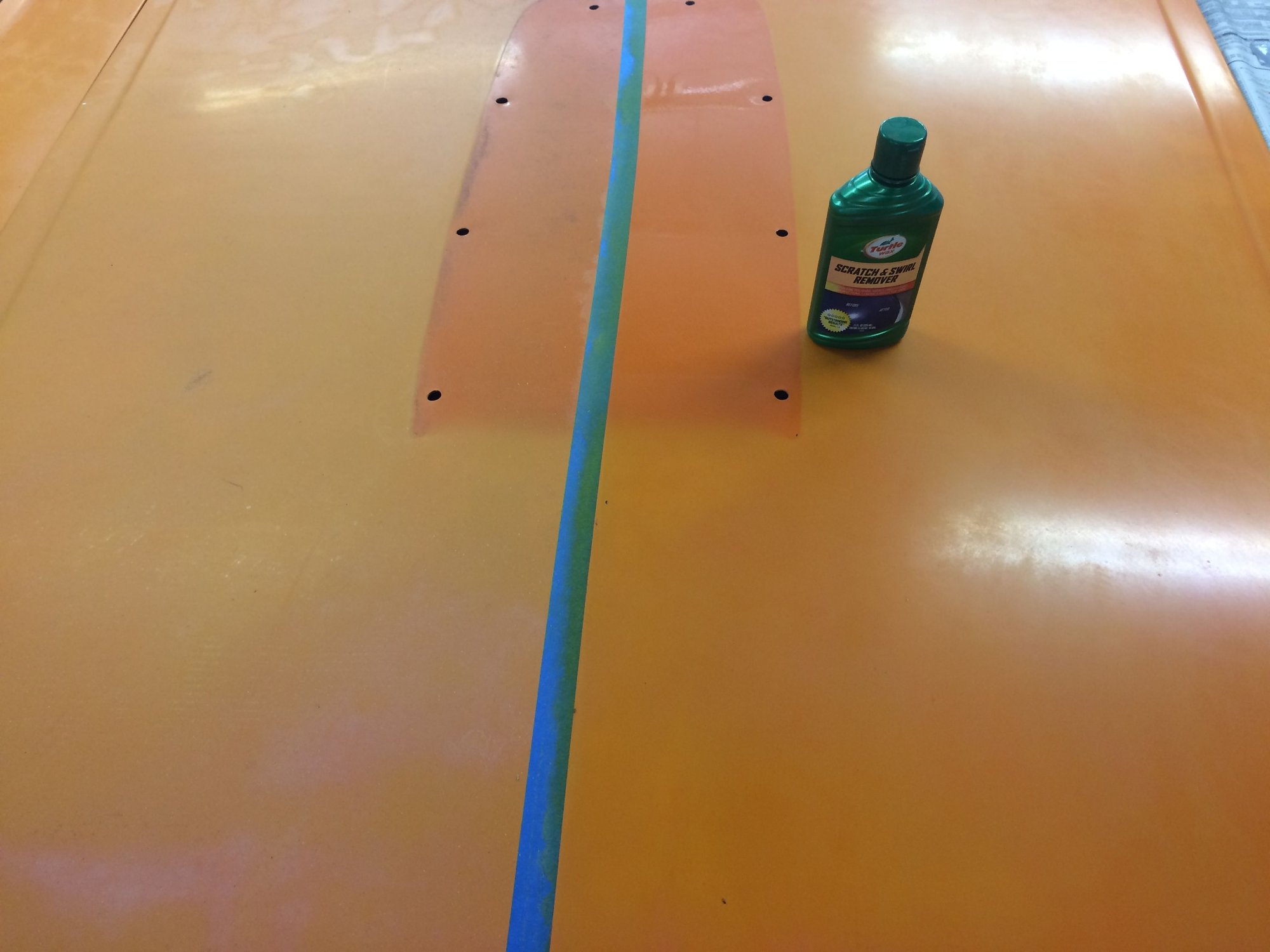

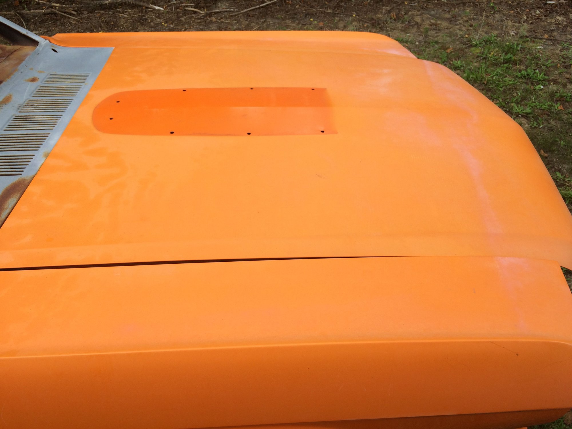

Here is a recap of the hood work that you saw yesterday:
Very dry, rough to the touch, not smooth at all. It will need a repaint, but this is just practice to see how good I am at reviving an old finish with polisher.
Step 1 was scotch-brite. I think I told you that was my second step, but looking through my pics I see that this is what I did first.
Step 2 was wet sanding with 320 and plain water.
Step 3 was scratch remover. I'm not sure is this is more coarse than rubbing compound or not, I may need to research more to make sure I am going in the correct order.

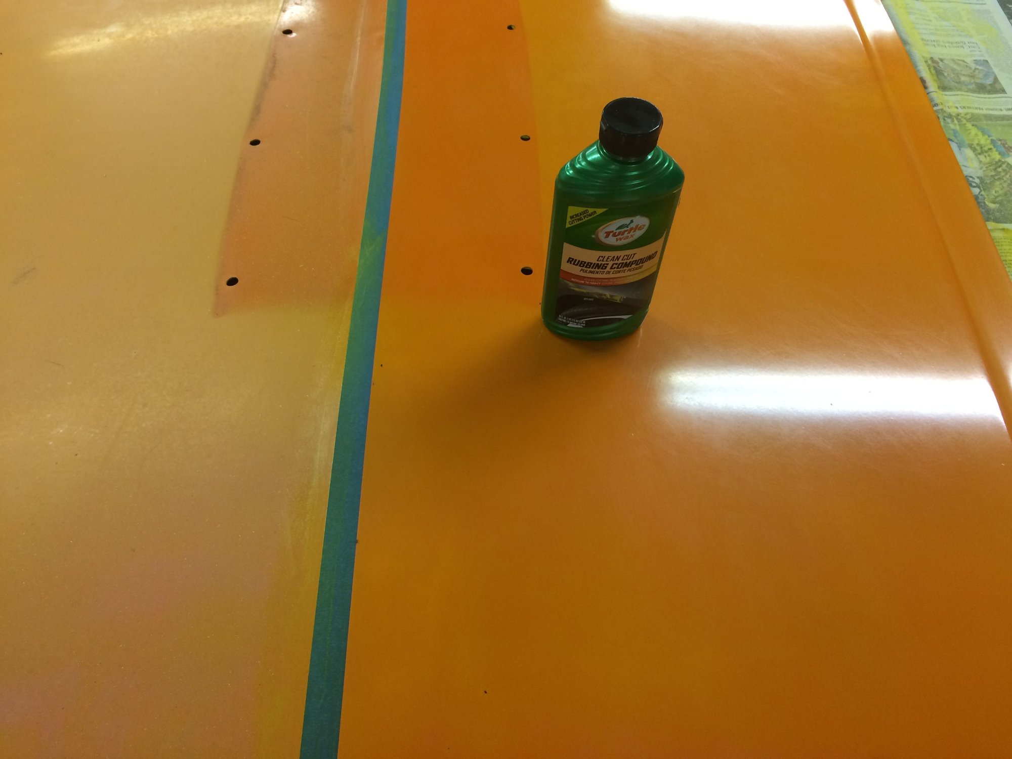

Step 4 is rubbing compound. As you can tell, the smoother and shinier the surface gets the more obvious the swirl marks are from the wet sanding.

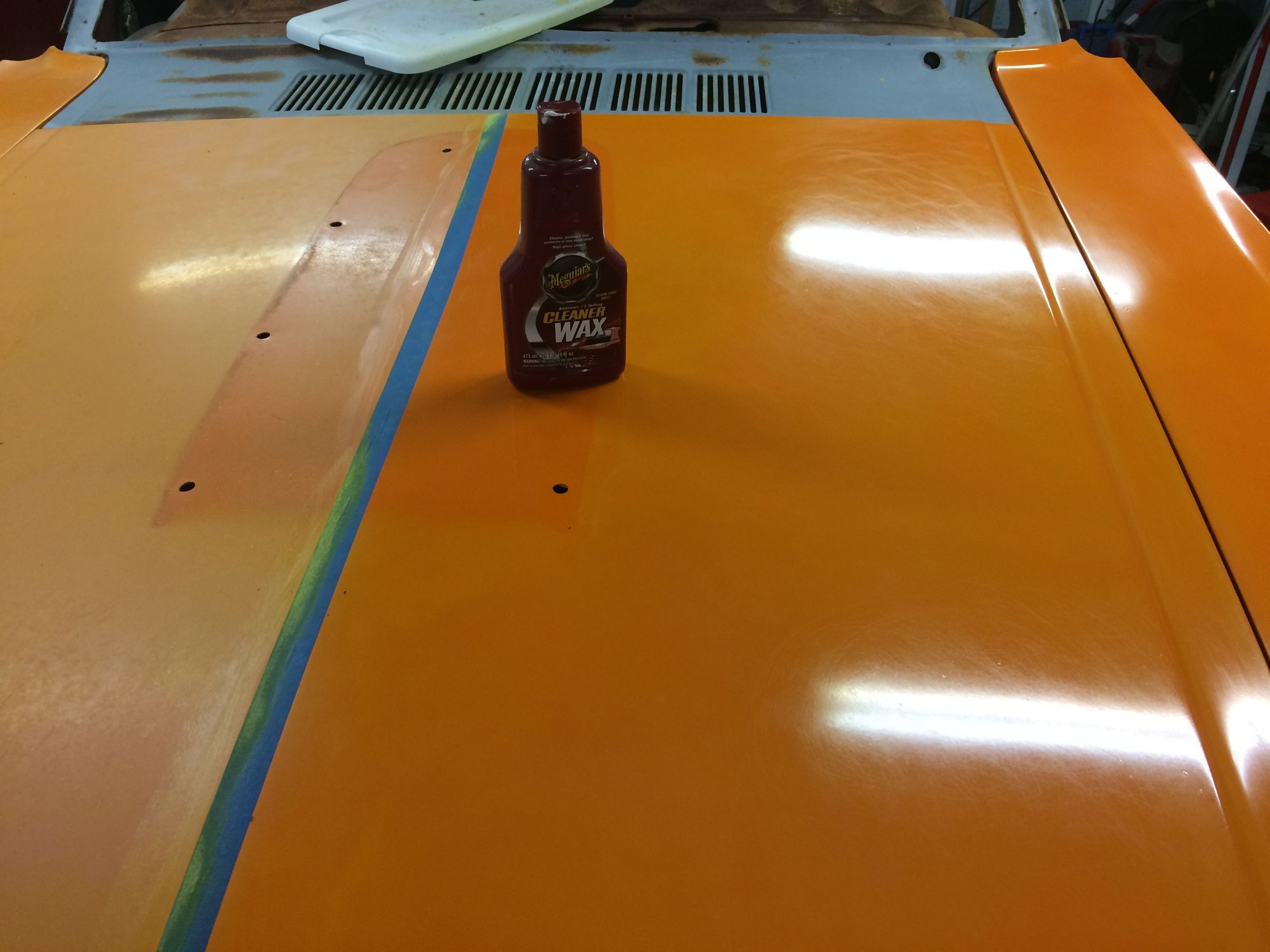

Last, cleaner wax. Very noticeable swirls. I will do the other side following your advice; 500 then 1200, and putting dish soap in the water. You said "Dawn", did you mean that as specifically that brand, or can I just use whatever brand we have in the kitchen?

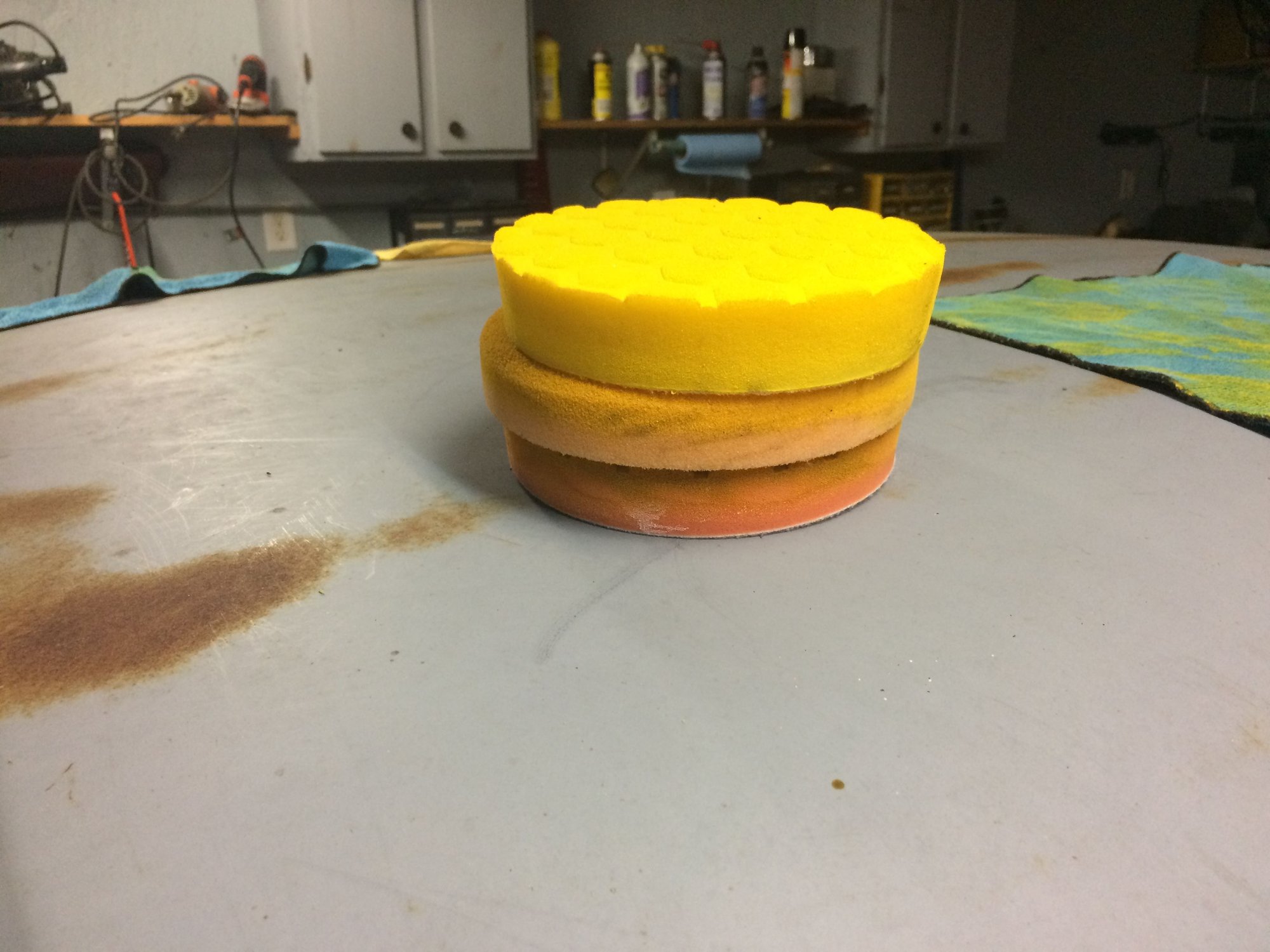

Finally I have a question about the polisher pads. Do you clean and reuse them, or toss them? I generally toss them in the washing machine with my polishing towels, but more than half the time the white felt pad on the back that sticks to the polisher comes off. It doesn't seem to do very well surviving going through the laundry.
I have been using a fresh pad every time I change product, so one for rubbing compound, one for polishing compound, one for scratch remover, etc. Should I just use one pad as I work instead of constantly swapping them out?

On the soap all I have ever used was Dawn. If its safe for ducklings its got to be safe for wet sanding LOL
Dawn also cuts grease & oil, again ducklings, and has been what I have always used.
You can try what ever you have and see how it works. The dollar store should have a small bottle of Dawn and it does not take much added to the sanding water to help with sanding.
I have never used them fancy foam pads when I had to "cut & buff".
I used a large wool pad on a large polisher with rubbing compound.
That would leave swrill marks so we would fit a fine wool pad over the wool pad and use a polishing liquid.
In your case maybe just hand wash the pads but you need to use a different one for each type of compound / polish you used.
On the wheels I hear you on the spacers / adapters.
My Javelin had 1/4" spacers on the front so the TT wheels would clear the 2 piston calipers.
When I swapped the calipers for 1 piston one, cant get parts for the 2 piston ones, I moved the spacers to the rear wheels.

Those buffer pads only cost about $10 for a 6-pack on ebay, or $15 for a 6-pack at Harbor Freight. I think I will try hand washing them as you suggest, maybe that is the key to making them last longer than 1 or 2 uses.
