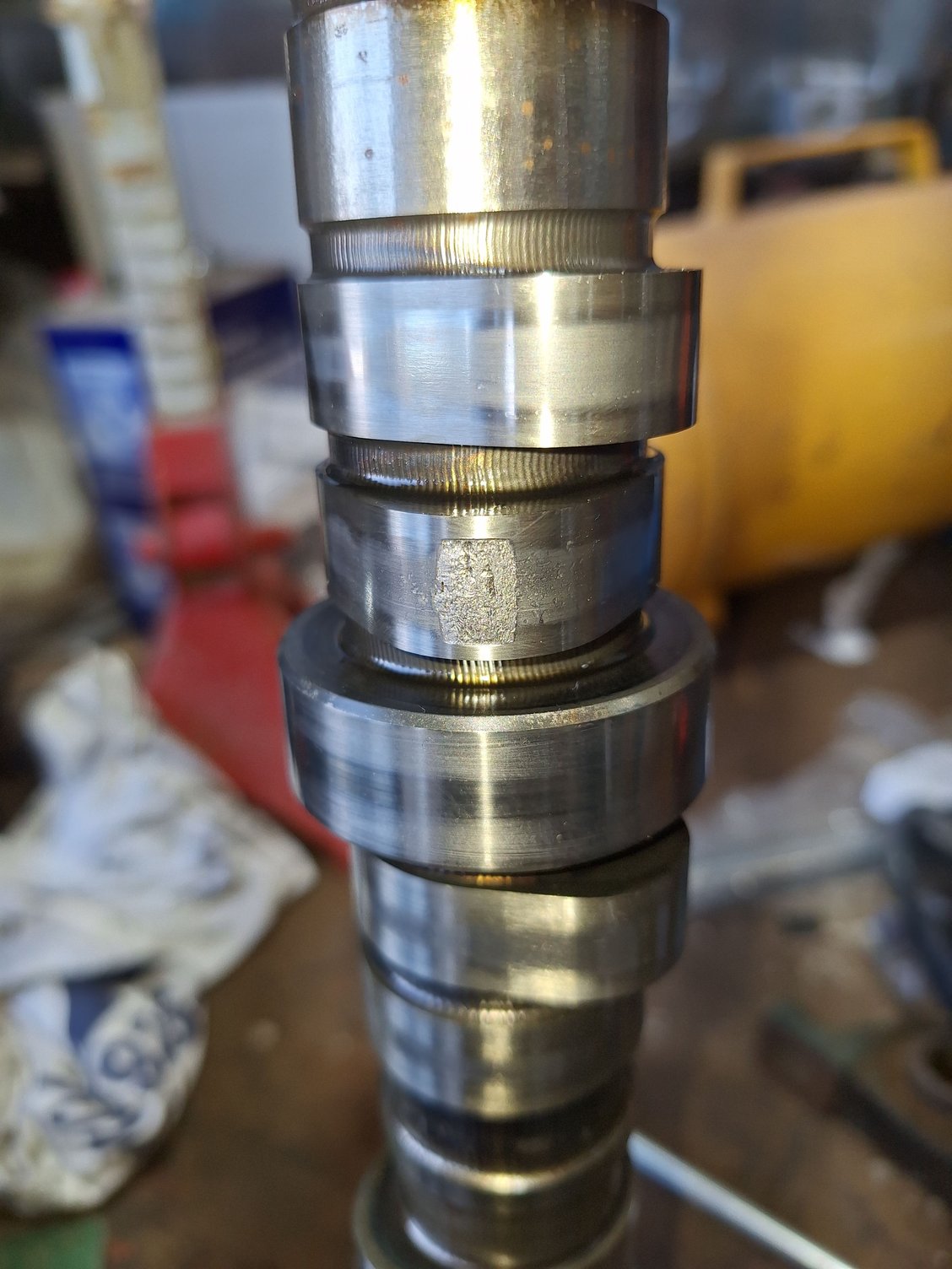

Other engine has a damaged camshaft as well WTF!
The lifter looks good with no damage.

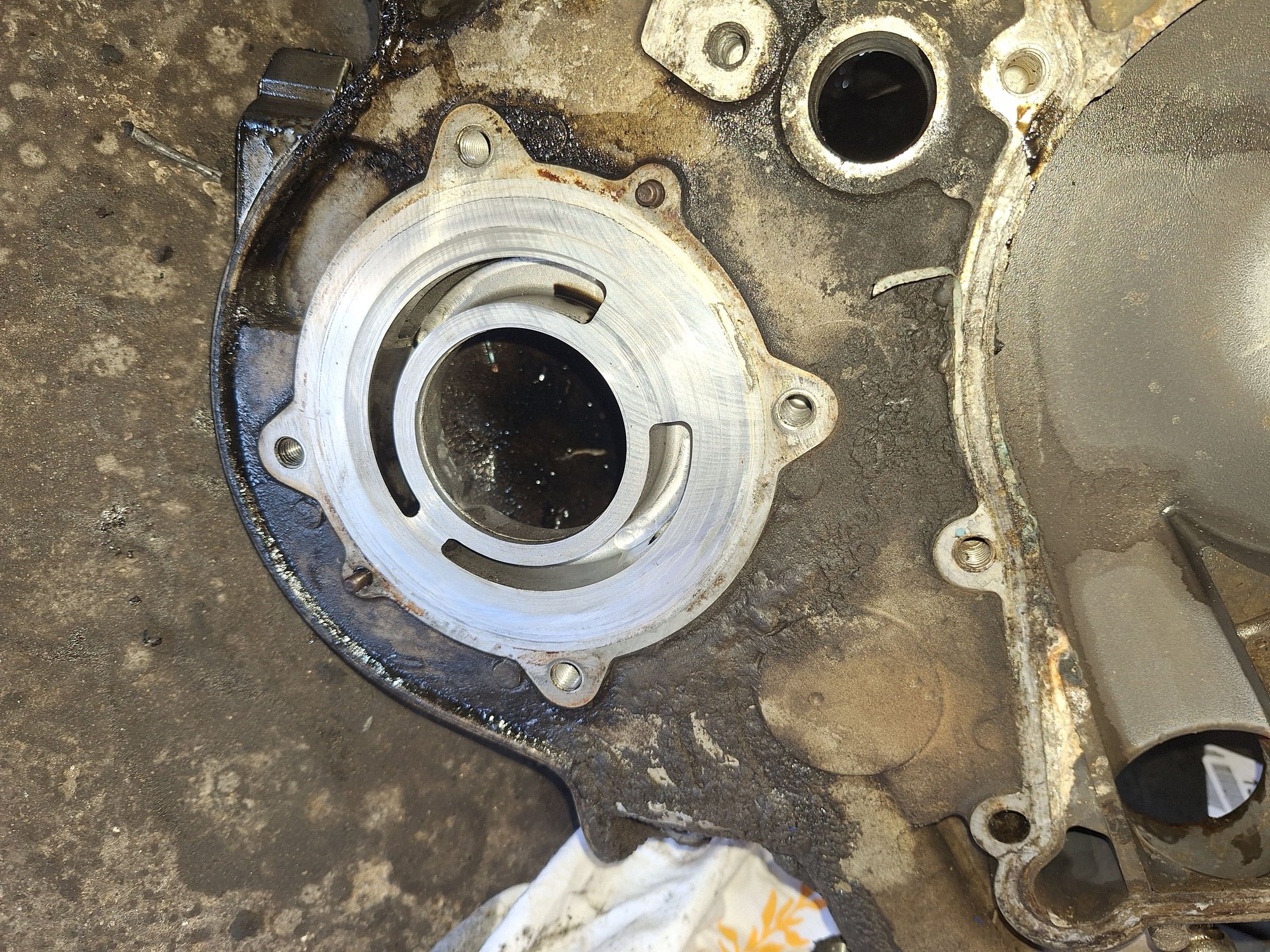

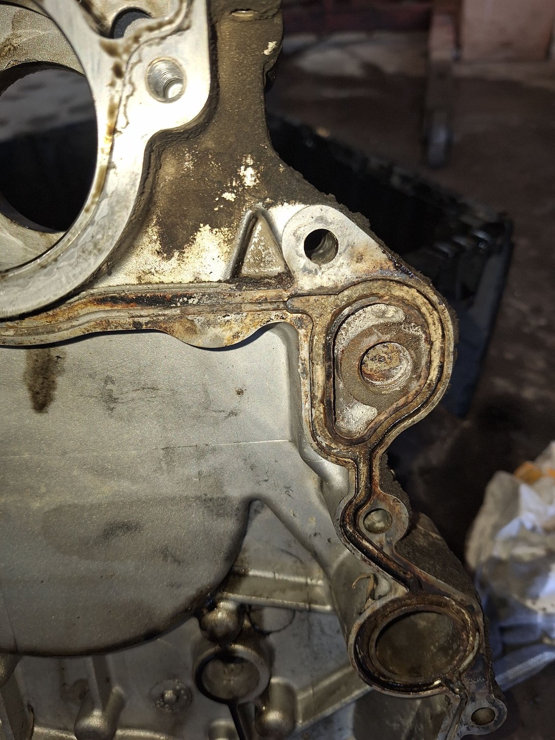

Timing cover on this engine is good little corrosion but nothing major
Pump has some scratches, but never affected to oil pressure on donor engine.

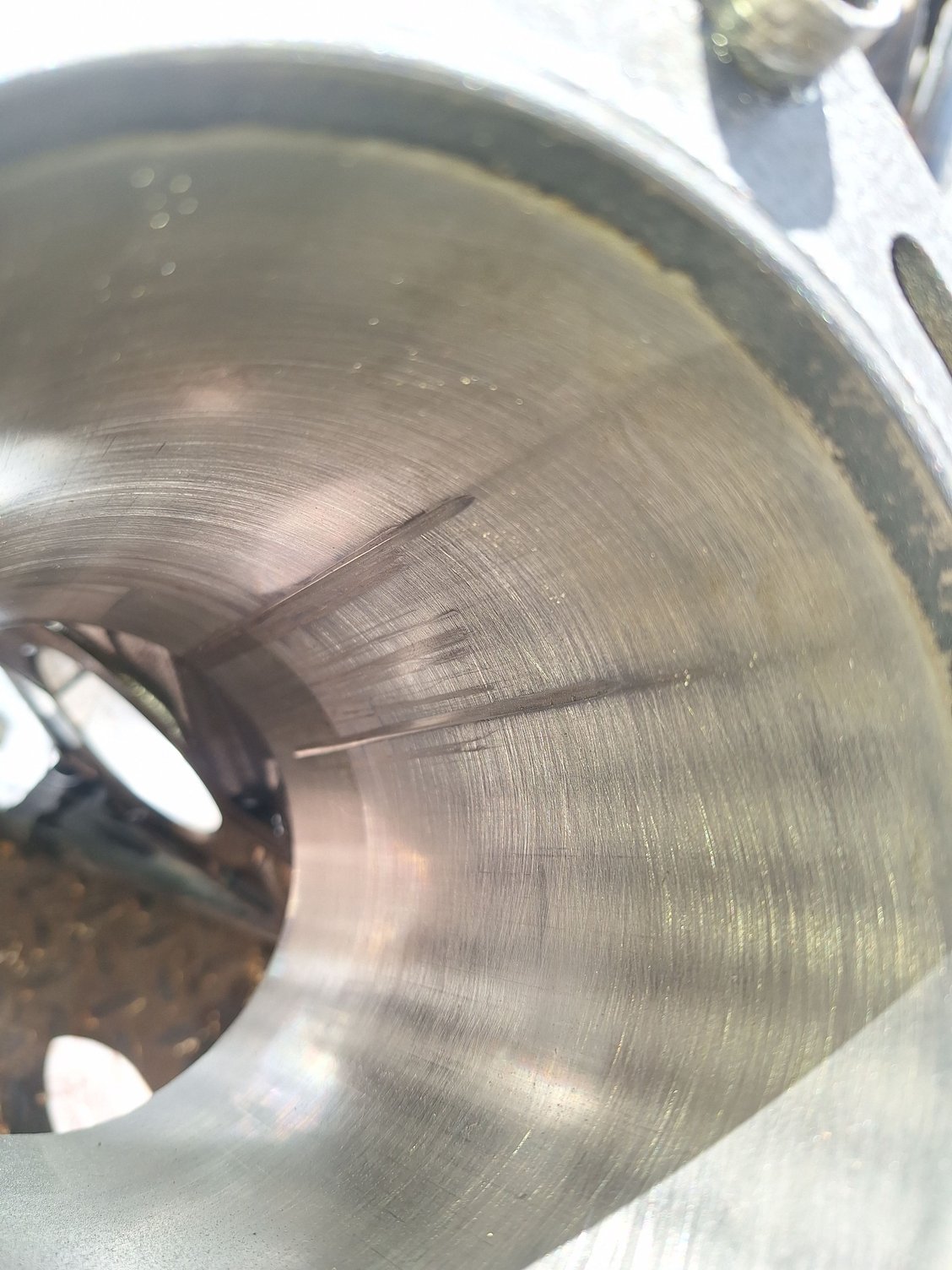

Here's the carnage on the block
Seems the wrist pin bushing or the pistons were the culprits allowing the piston to roam freely inside the cylinder allowing the wrist pin clip dislodging.
I should of taken pictures of the 2 rods those bushings were detroyed as well as the pistons.
Oh well por pendejo lol.

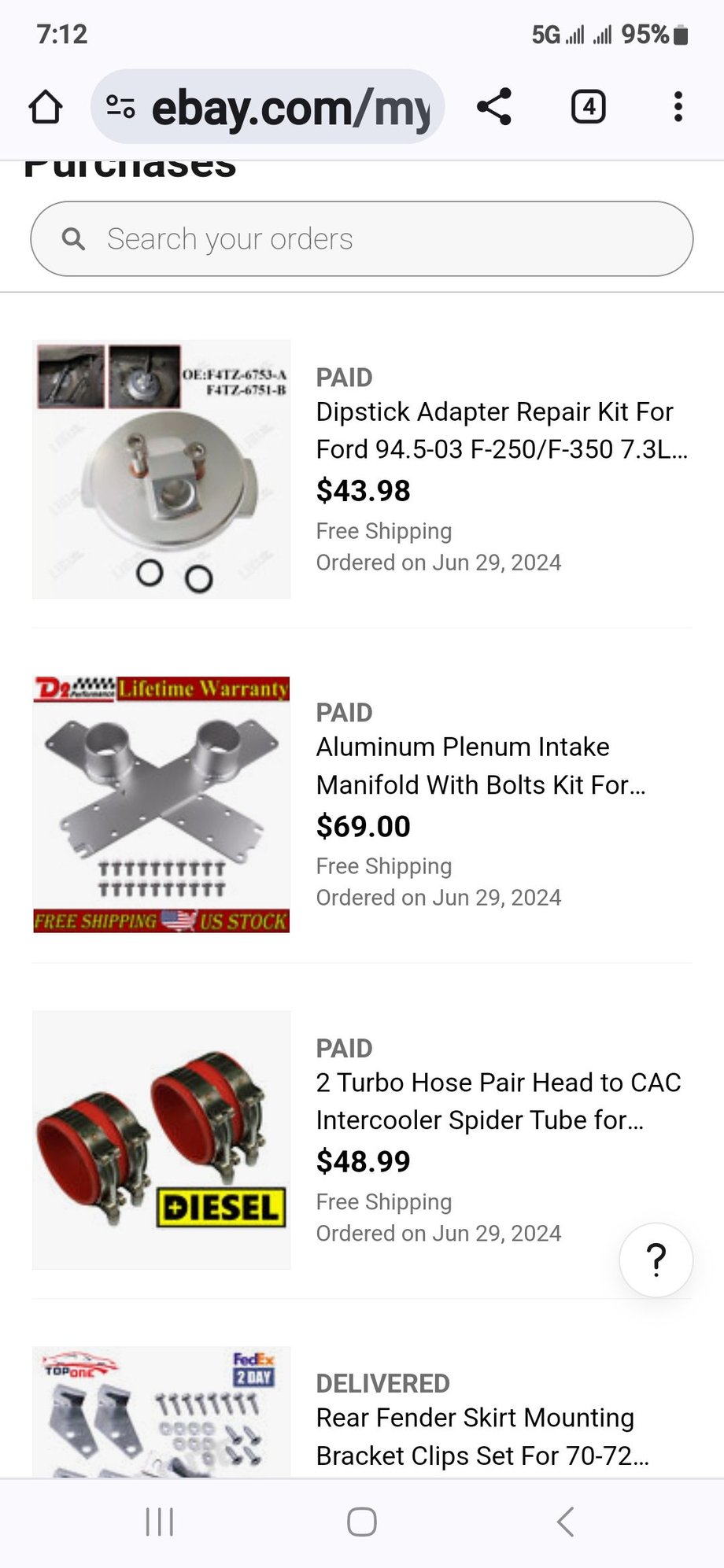

I ordered some goodies as well, upgraded oil dipstick adapter, aluminum plenums and new spider to plenum boots. So no mas dinero for this truck for a while.

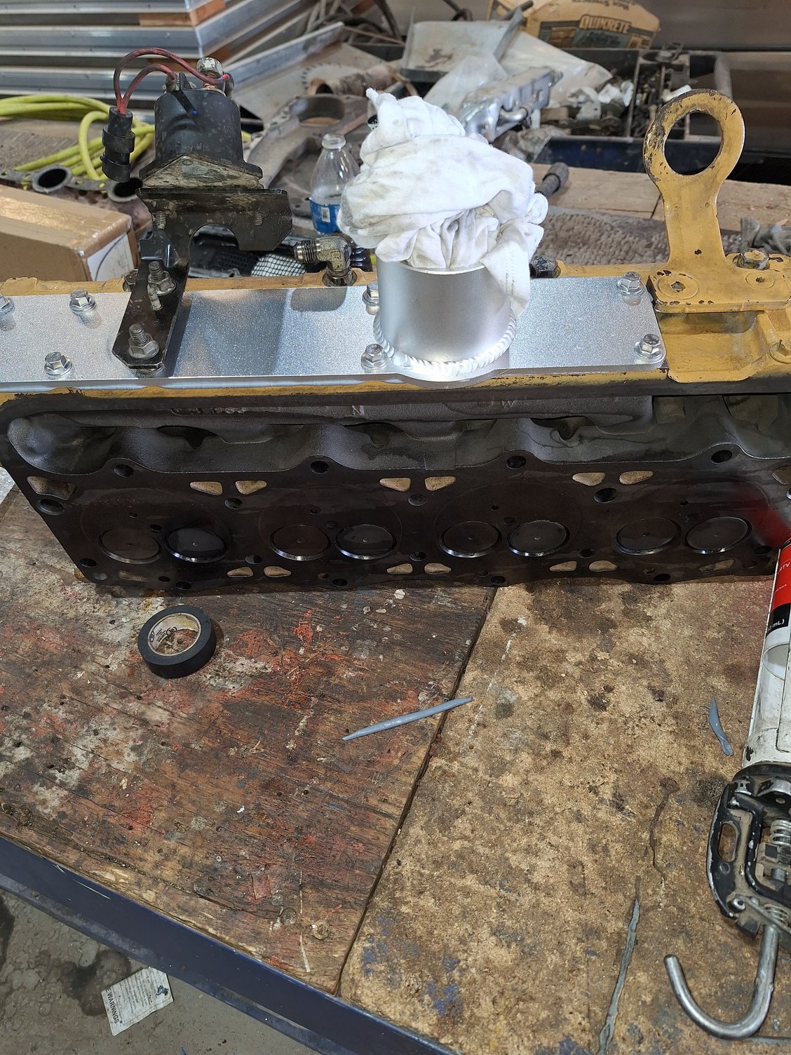

Plenums and boots got got her today.
Just finished installing the plenums on the heads,
Valves dont leak either, now just to wait for the machine shop to finish the block so I can start putting g it together.

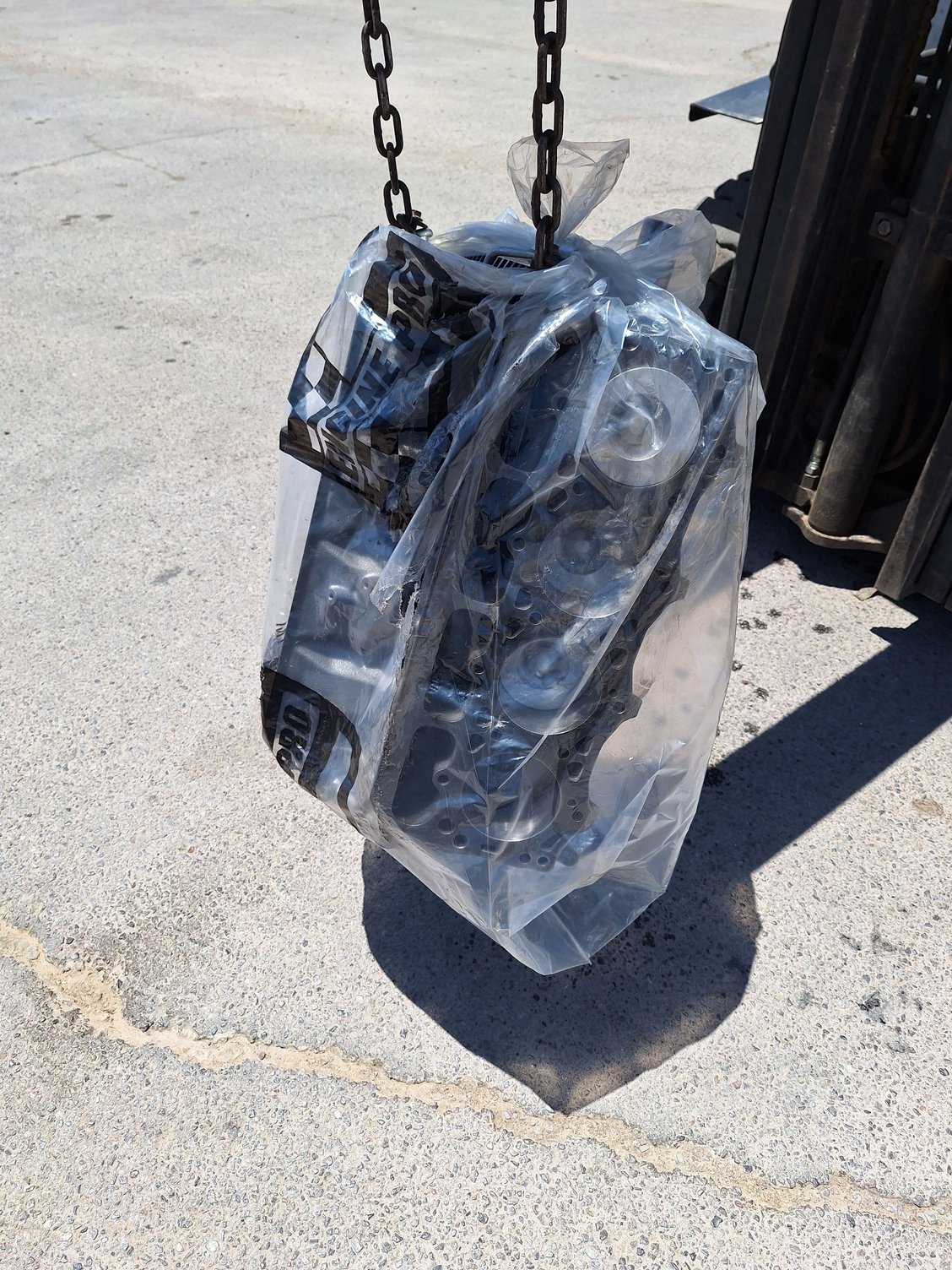

Short block ready for assembly, gasket kit gets here next week.
