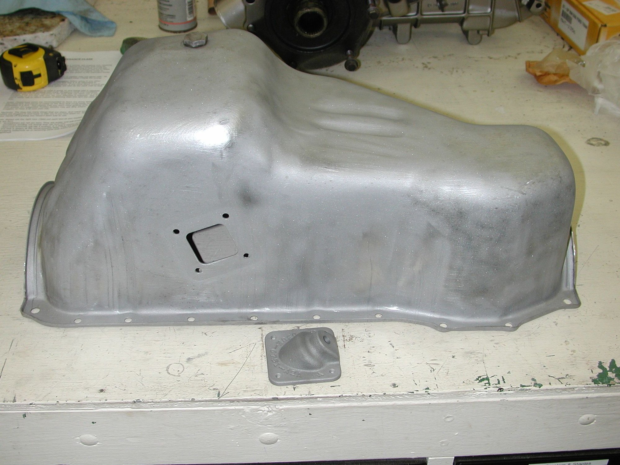

Got the extra media in the blast cabinet today and it helped significantly on the issue where I have to keep moving the pickup. But, it didn't help at all with the issue where the media pulses, as previously described. So, I've started a new thread in the Garage & Workshop forum, and would invite you to got there to provide input.
But, in spite of the issues with my cabinet, I was able to get the pan and adapter blasted today. They are now clean and ready to be married.
And, toward that end I got the thread locker and gasket maker today. As you can see, the thread locker is the red/permanent kind. I reasoned that the adapter was originally put in with rivets, which are designed to be permanent, so let's make the screws permanent. And, on the gasket maker, there are soooo many different kinds that I finally picked one. I debated between ones like The Right Stuff that set up very quickly vs ones like the Ultra series that take fully cure in 24 hours. In the end I wanted the flexibility that the long-cure gives - especially when installing something like an intake manifold that can be fiddly. So, I went with Ultra Black that says it is good for many things, including intake manifold end seals - and none of the others say that.

Ok, I think I see the error of my ways. Ultra Whatever is not going to work for the dip stick adapter. The issue is the thread-locker - if I put it on when I initially put the Ultra on I won't be able to torque the screws down after the Ultra sets up. But, I don't want to take the screws out after the Ultra sets up in order to put the thread-locker on as that'll break the seal between the screw and the Ultra and it can leak at the screws.
So, I'll use The Right Stuff as it sets up even more quickly than the thread-locker.

I'm glad more media is helping your pickup problem.
That sales pitch seems like it may be the solution to your pulsing problem.
I already mentioned I'm not a fan of RTV for things like this.
TRS is good for china wall sealing because of its fast setup you can make book and get it out of the shop.
If I was going to use silicone I would use it for both threads and flange but my opinion of 'lock washers' sits with Carrol Smith', in the words of Mr Sunshine here on the forum "JUNK!"
Get some all metal prevailing torque lock nuts, use a hardened washer. (M6 is nice on 1/4" because the fit on shank is good and the OD reduced due to ISO spec)
Anerobic sealants should not be used anywhere near plastics including nylon lock nuts.
