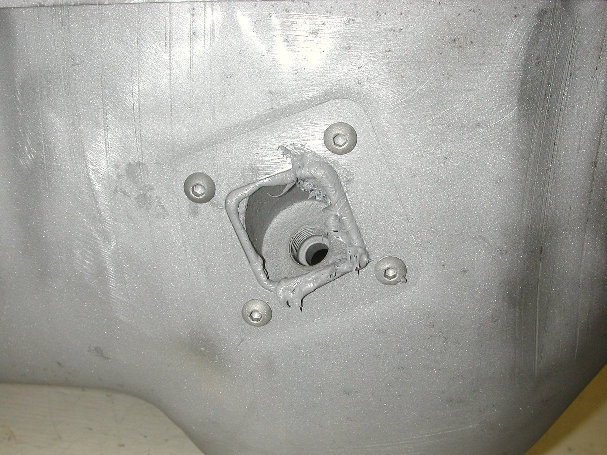

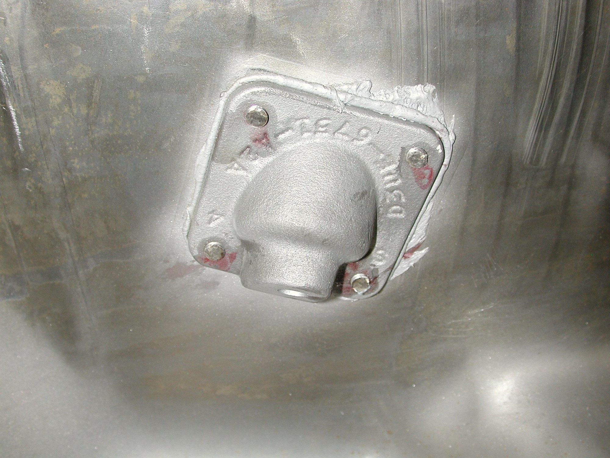

Got the adapter in the pan today. Used The Right Stuff and Red Thread Locker, and I plan to explain why, later. (Get your pillows, boys.)
Here's a shot of the outside right after I got it bolted in. The gasket maker was still a little soft, so I waited a bit before cutting the excess off. Anyway, I like the way TRS swelled to seal everything, as shown with the excess that came out all the way around, both inside and out. So, I'm sure it is sealed.
And, here's the inside just after bolting it in.

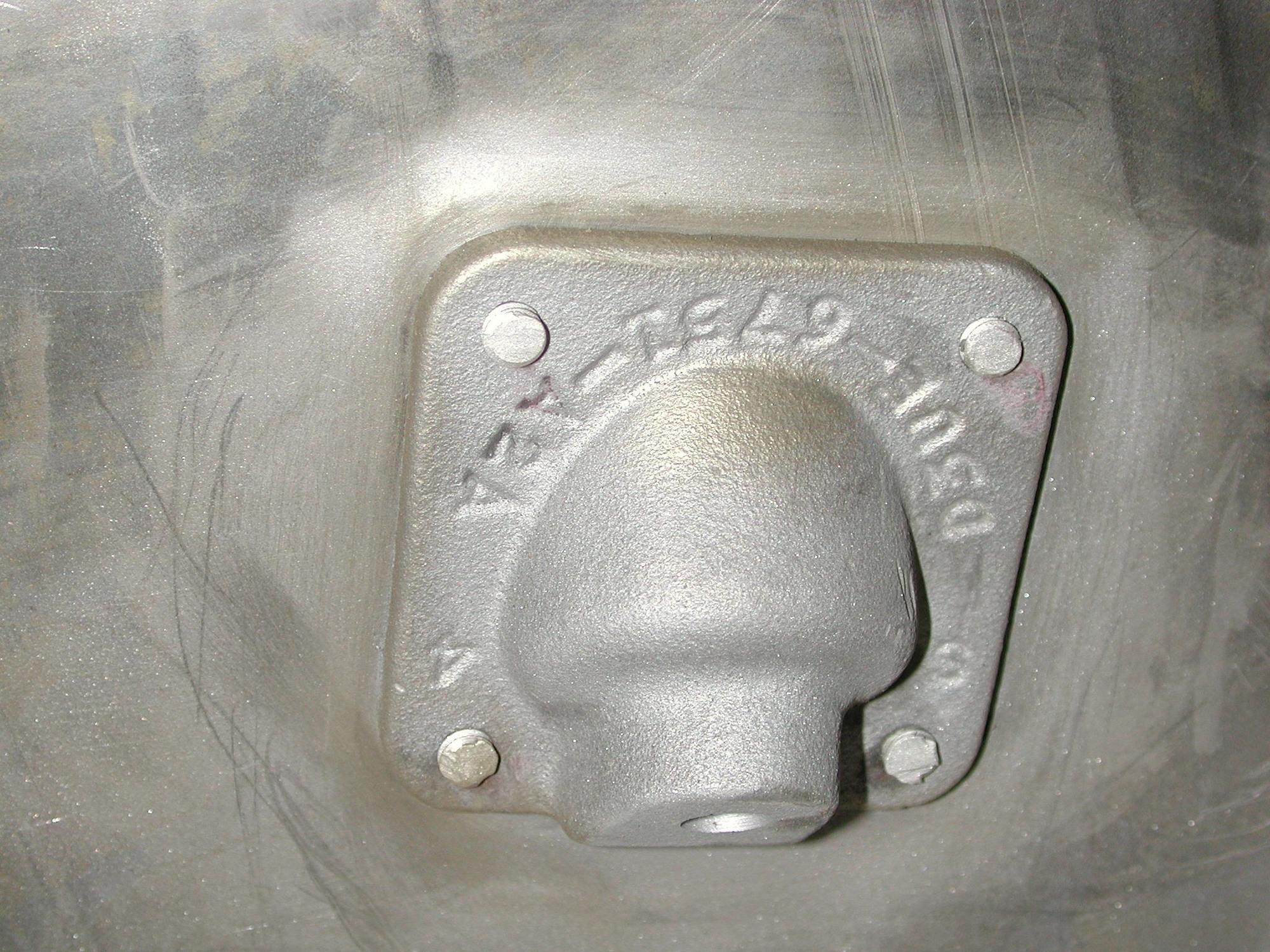

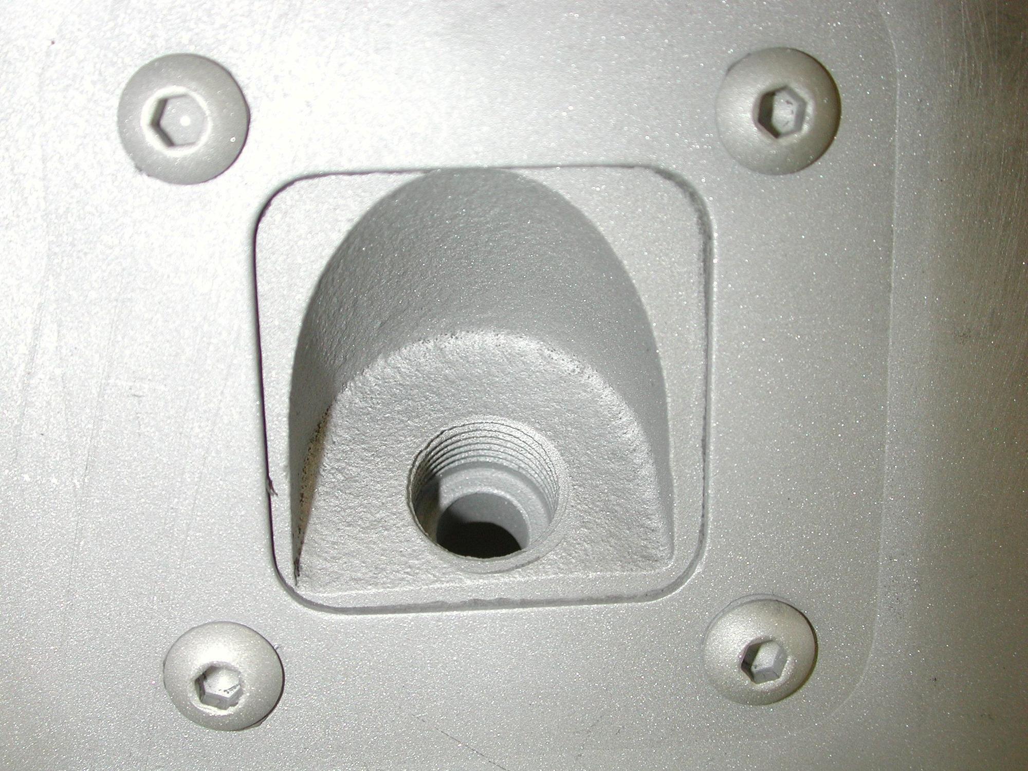

Now, here's the outside after cleaning it up and media-blasting it. (It dawned on me that paint doesn't stick to RTV, so I had to get all the traces off.)
And, here's the inside:

Ok, let me try to 'splain why I went the way I did with gasket maker. First, I've read quite a bit about gaskets, sealers, and gasket makers - enough to get very confused. Then I ran across this Gasket Maker Selector Chart from Loctite. And I realized that one distinction between applications was whether the parts, or mating surfaces, are machined. That seemed be telling me that an application where the surfaces are flat takes one kind of treatment and applications where the surfaces aren't flat takes another. In other words, if there is going to be very little space between the surfaces, and if that space will be uniform, then the job is easy. But, if there are tight spots and wide spots then you need a something that will conform.
An oil pan/adapter junction might be thought to be of the machined variety because, at least in my case, the adapter is machined. However, the pan has only a slight recess that provides very little rigidity, and if a paper gasket is used I would expect it to have a hard time filling the wide spots. So, I opted for The Right Stuff as it expands slightly and fills all the recesses. And, you can see from the pics that it did the job as it pushed out when I tightened the screws down. I'm confident that the whole space between the adapter and the pan is full of TRS, and that the screws are well and truly embedded in it since I circled them with it.
So, I believe the adapter/pan interface is sealed, and if the thread-locker works it should stay that way.

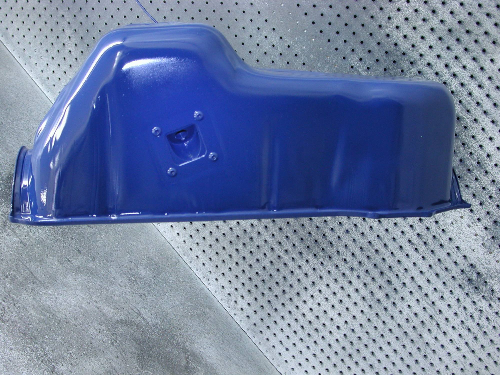

I took several pics of the pan after painting today. But, these are the only ones that came close to showing the right color on my monitor, and even then they aren't quite right. It was painted according to DupliColor's instructions: 2 light coats and then one heavy coat of the primer, and then the same on the color - with 10 minutes between coats.

Well Gary, I think it turned out nice. Is the blue a little darker in person?
