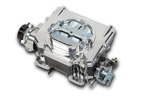

I got "the call" from Tim today saying that the engine parts are on their way. In fact, they may be in for my birthday on Sunday.
But, not everything is coming directly from Tim. The cam and guide plates are coming from Comp, and probably something else but I've forgotten what.
And, he offered me the 750 Street Demon that he bought and dyno'd at my request. It's the #1904 with the polymer body. So, I said "Sure, throw it in." Guess that decision's made. Looks like this:
