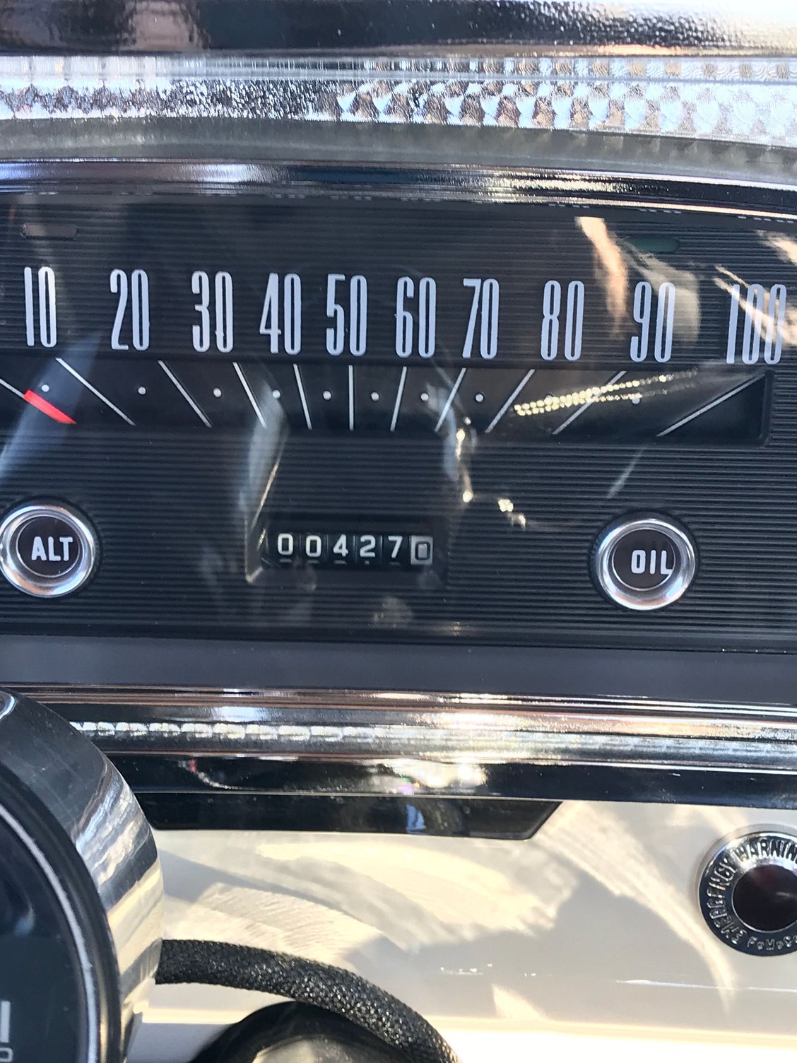

Out to local Chrome n Coffee and it just turned 427 miles!

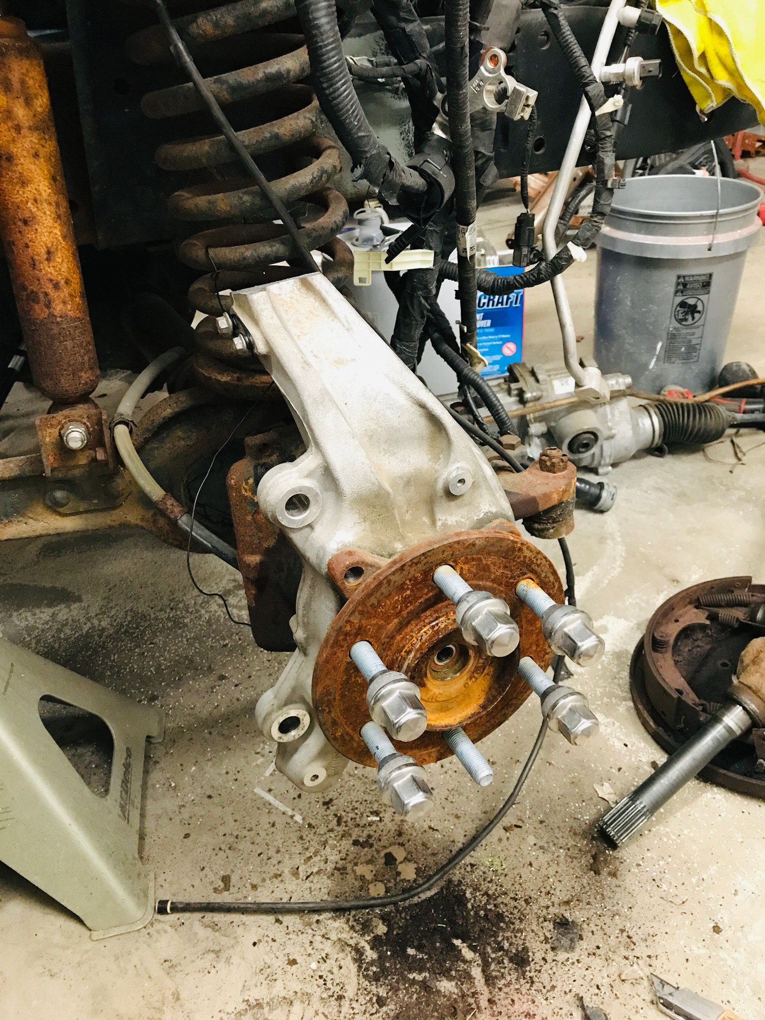

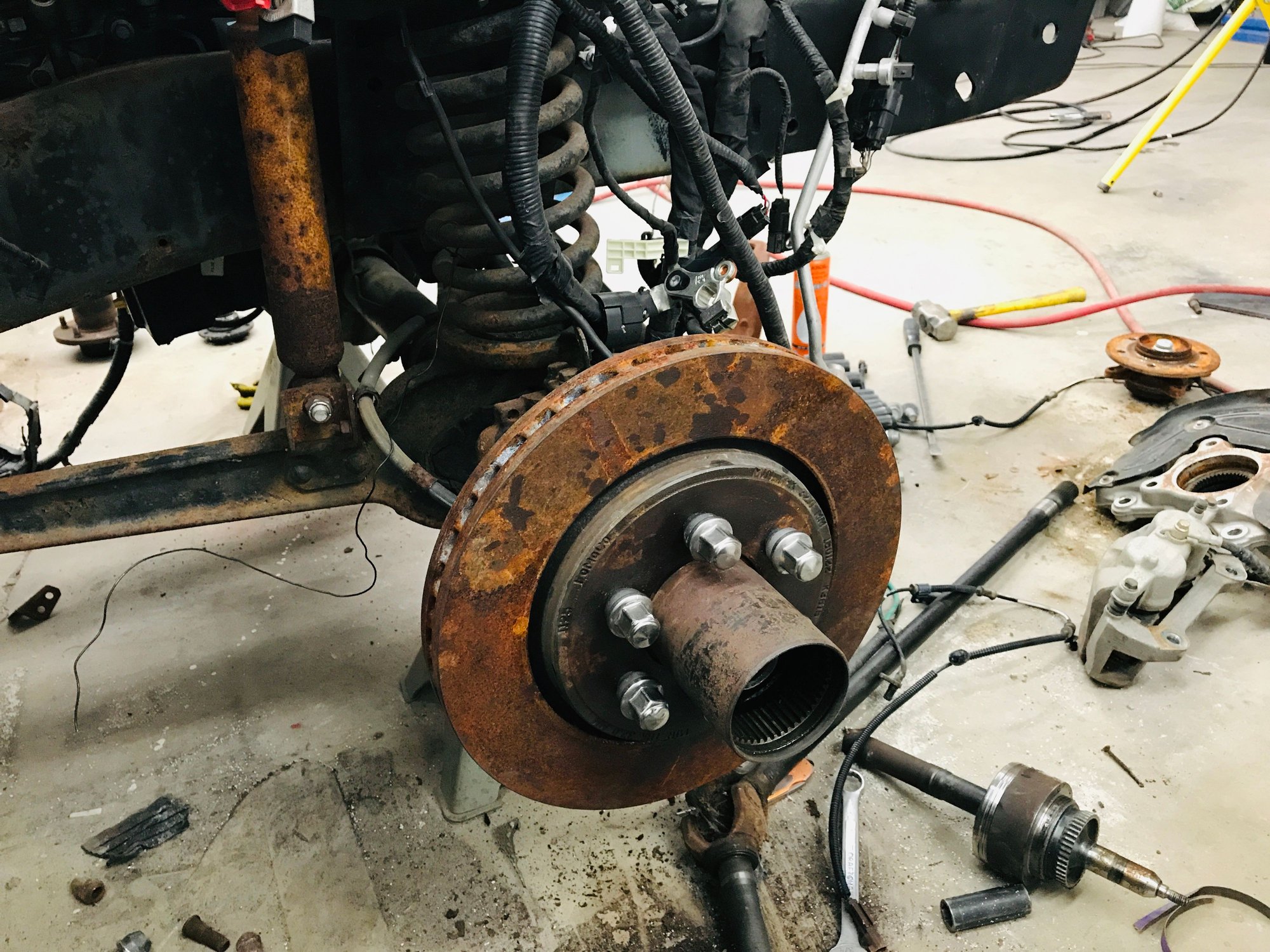

In process of adapting 2015 & up Disc Brakes to the ‘66 F100. That will give me ABS plus allow for a Electronic locking rear diff with electronic park brake.
Tire wheel selection also much better.

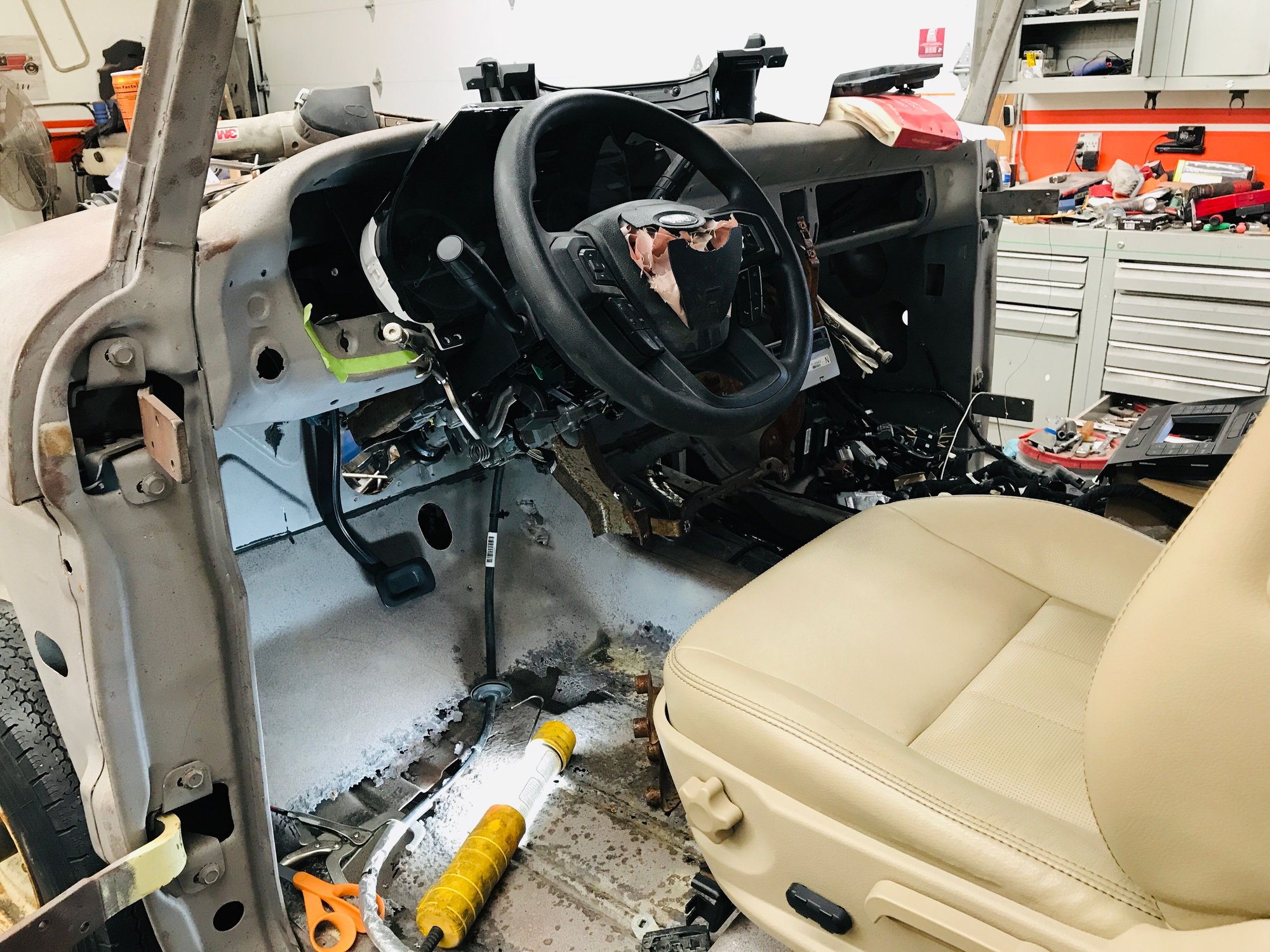

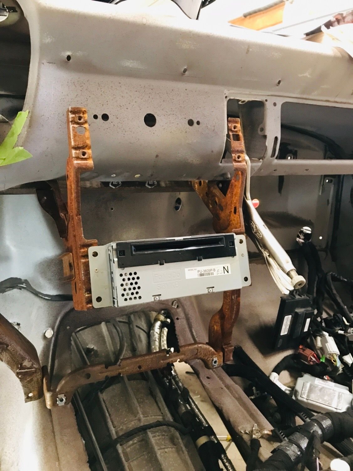

In process of fitting column, pedals and seating.
if I decide not to do the 150 brakes the backup plan is to go with 12” 6 piston discs with late model 150 bolt pattern. It would be more cost but a lot lighter.

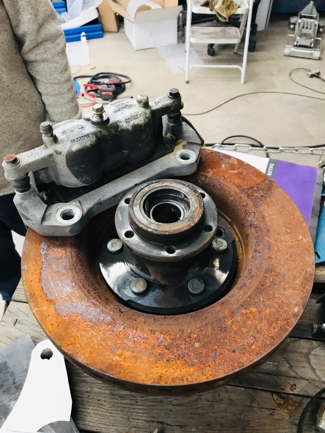

I have found the F150 brakes are a direct bolt on to the '66 hubs! I just had to change the bolt circle a bit to use the late model wheels. The wheel tire combo tucks up nice within the fender.
Total cost only $17.00 I already had the brakes, they were free! Dirt cheap in the junkyard too

Originally Posted by Amish65F100
That's pretty cool Boss!
welded up the holes using ‘66 studs. Welded, ground down. Then simply drilled new holes.
