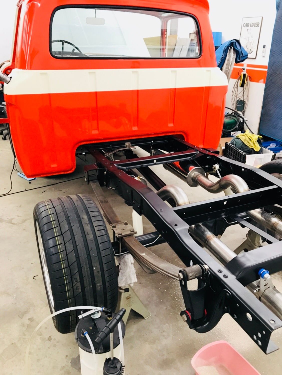

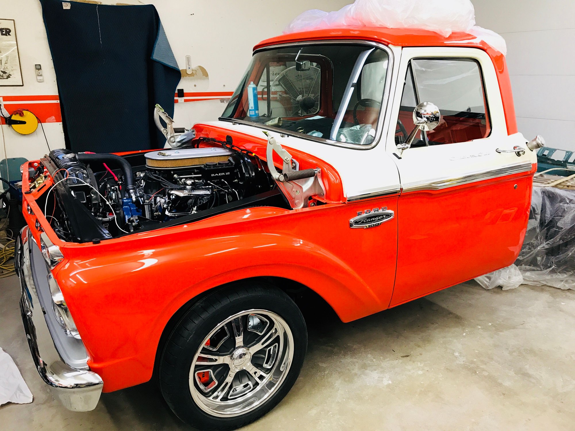

Photo Update. Will let the pics do the talkin' as I am not so good at it.

Video update too! Running, Driving with a quick walk around

Great pics and that's a sweet sound!

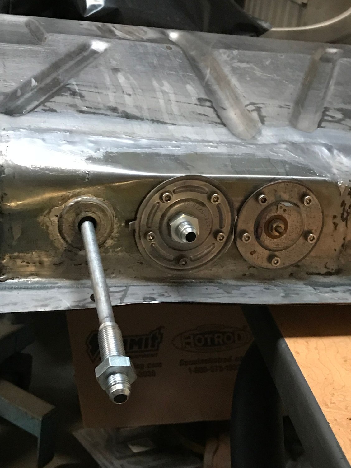

What did you do for fuel pump/s and lines to feed the efi from the cab tank?

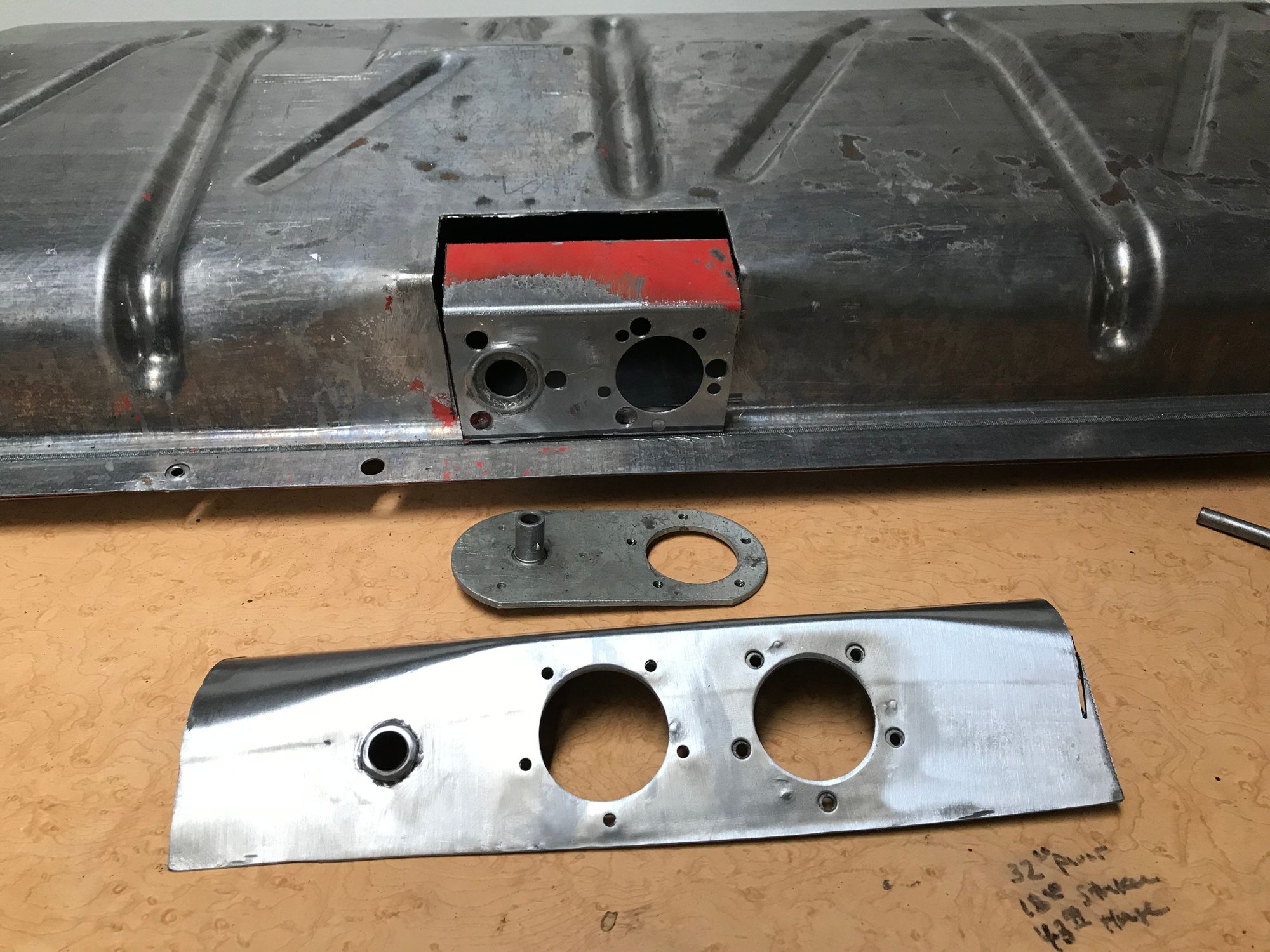

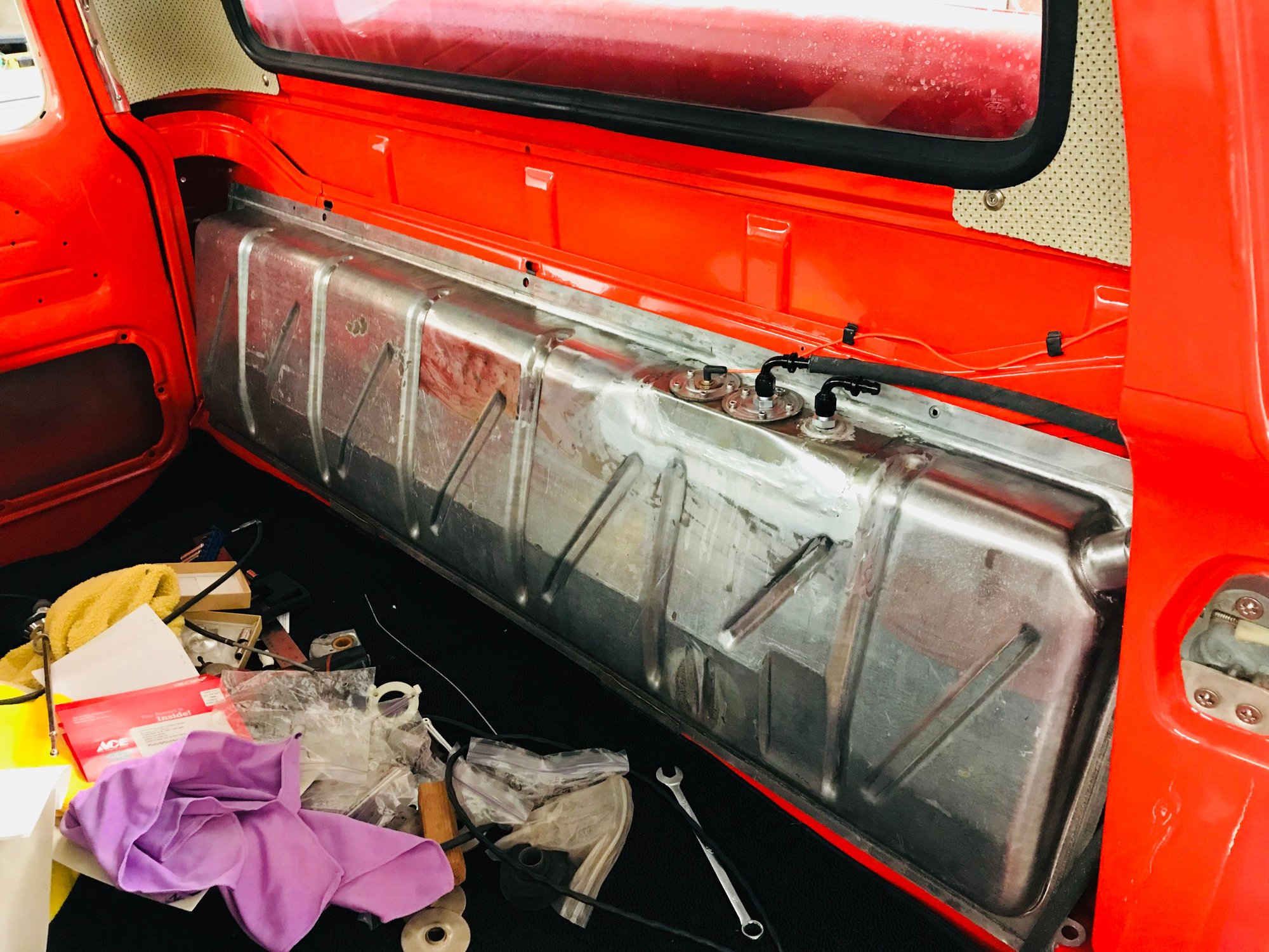

Thought I posted pics of the fuel system but with brain fog one never knows.

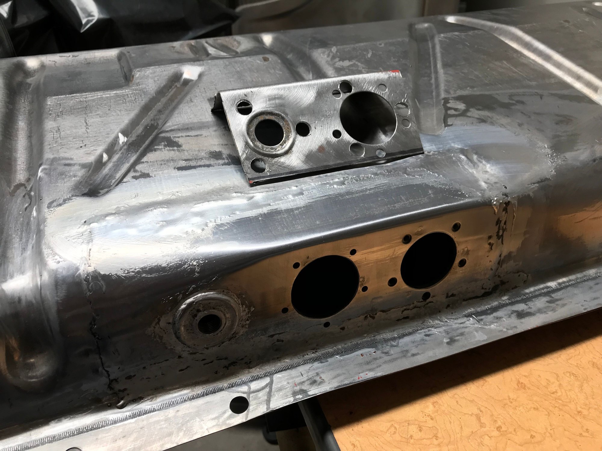

I used a stock fuel tank but modified it for EFI yet tried to keep it stockish looking.
I added a Holley HydraMat on fuel feed side.
I used a 1100 HP Mechanical pump that feeds a reservoir which has a hidden high pressure pump inside. Its a return system where I added another sender size hole for pickup and also A Return. Fuel Gauge sender in stock position
The pressure line to EFI is hidden along with Power Steering hose and runs up back of engine out of the way of heat.
I used a stock 427 SOHC fuel log to make it appear stock feed but its actually the return line that runs in a stockish location. It goes down to fuel pump but kinda a hidden return line to Reservoir and from there return tucked inside of frame back to tank.
A Hidden MSD box also used
The EFI setup runs the ignition timing. (MSD built me a Locked distributor to go with it) Still a lot of tuning to do but really need to get it out on road to start to adjust stuff.
For fuel lines I used the AeroQuip push loc system but added band clamps for added security. (look like a stock Ford Clamp)

Post 485 shows the return setup

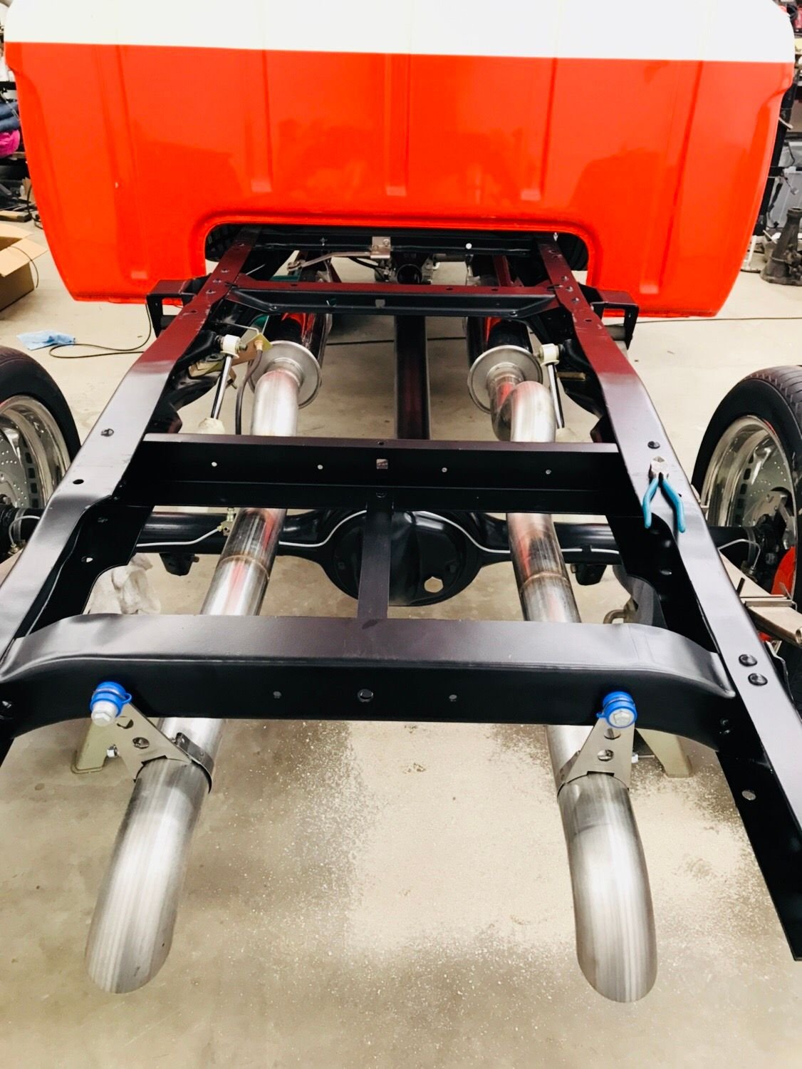

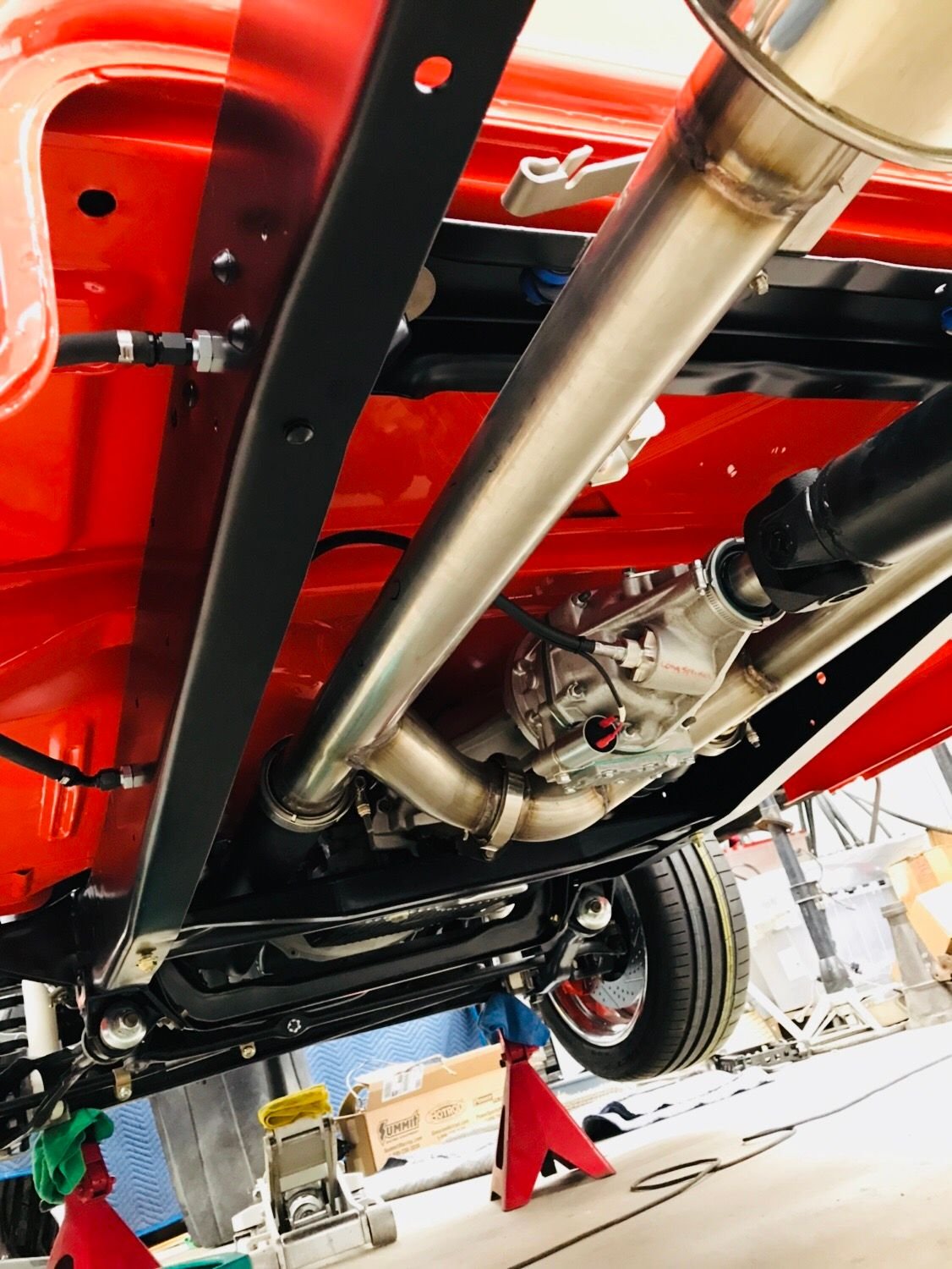

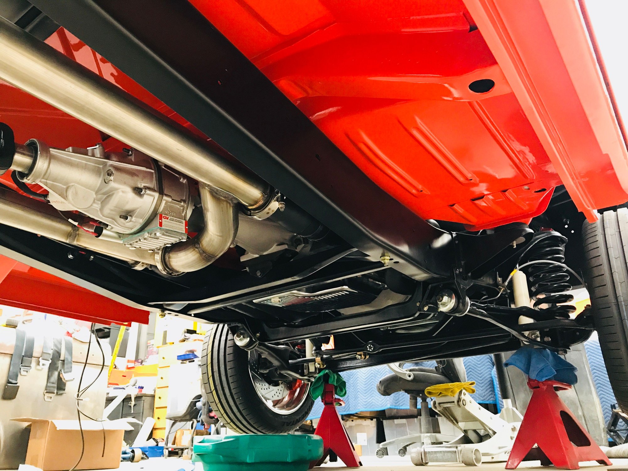

Pic will show the supply and return line for fuel. I used Bulkhead fittings in existing holes in frame. No drillin' needed
Dont recall posting pics of done undercarriage

Thanks for the fuel supply photos and info. I never thought of using a mechanical pump to supply the high pressure pump, will need to look into that.
As always great workmanship on the underside of the truck.
