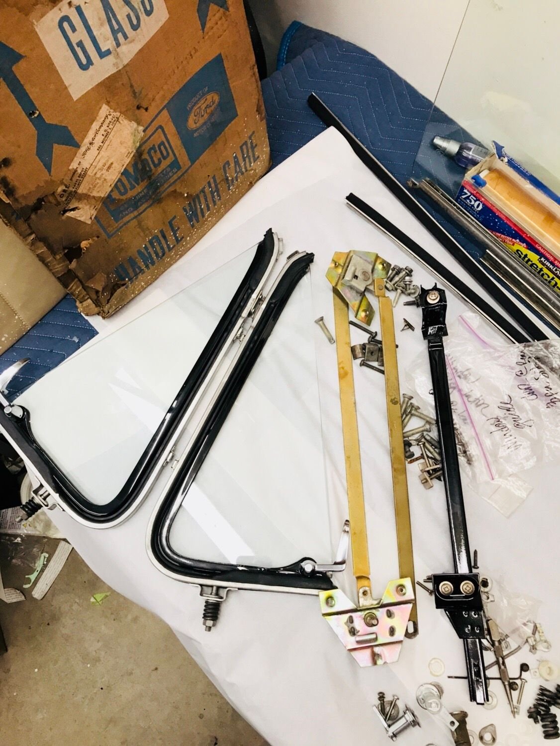

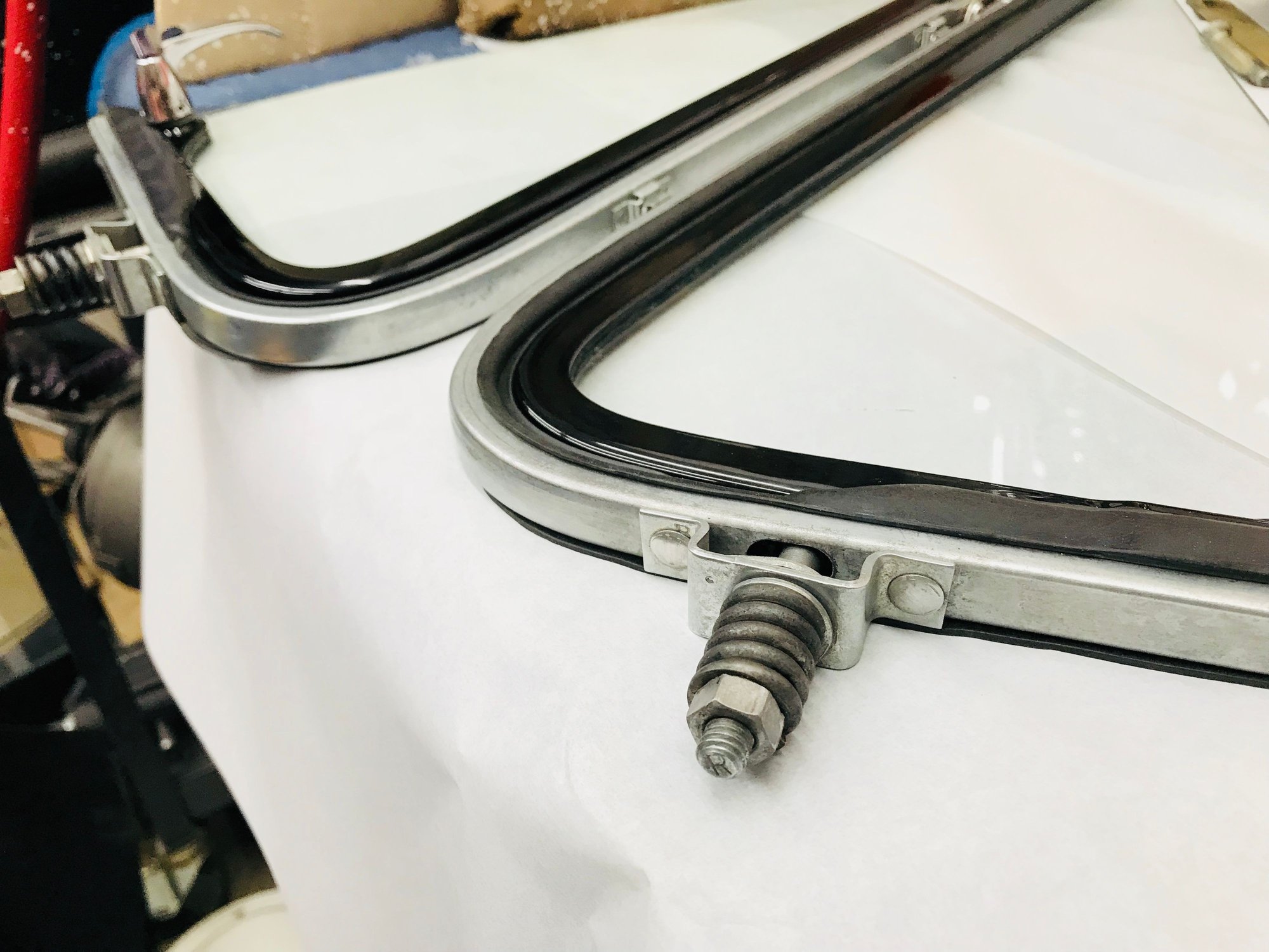

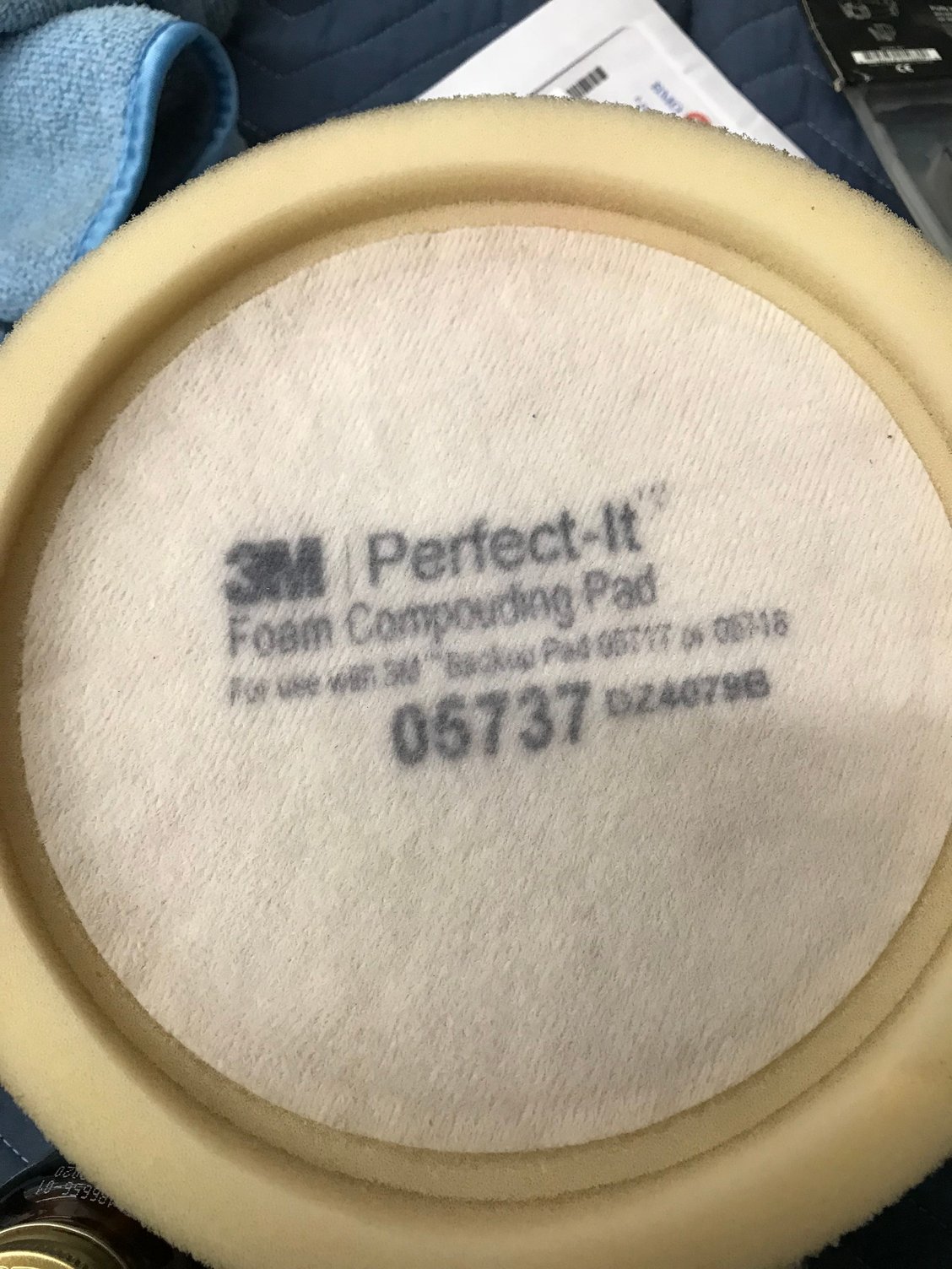

I would assume many polish glass but will share with those who have not. Been doing it prob 40 yrs.
i found foam pad 3m compound with my air buffer works best. Just like paint glass that is over 50 yrs old it’s near impossible to make look new just cleaning.
These are original windows from my Orange 427 Truck. Simply amazing how well they turn out. Cars going back many yrs if at show have gotten many comments about where did I get NOS glass. I would just say. Just cleaned it good...
these date coded 5J or September 1965. Truck very early October build.
happen to have NOS vent glass. February 1966.

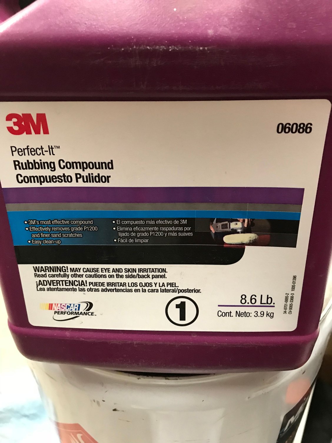

so what kind of 3m compound do you use? is it a glass specific polish? i'd like to try it on my mustang
i do have a glass specific polish for fine scratches but the 3m stuff is for getting them perfectly clean. It will not remove much in scratches. I use same compound on paint, plastic, chrome, glass etc. works awesome on plastic headlights.
Old Aug 21, 2018 | 11:29 PM
  #543
Boss9F100's Avatar
Boss9F100
Joined: May 2008
Posts: 3,670
Likes: 370
From: PHX AZ
That is part # for gallon. Avail in quarts too. Also specific pad I use with it.

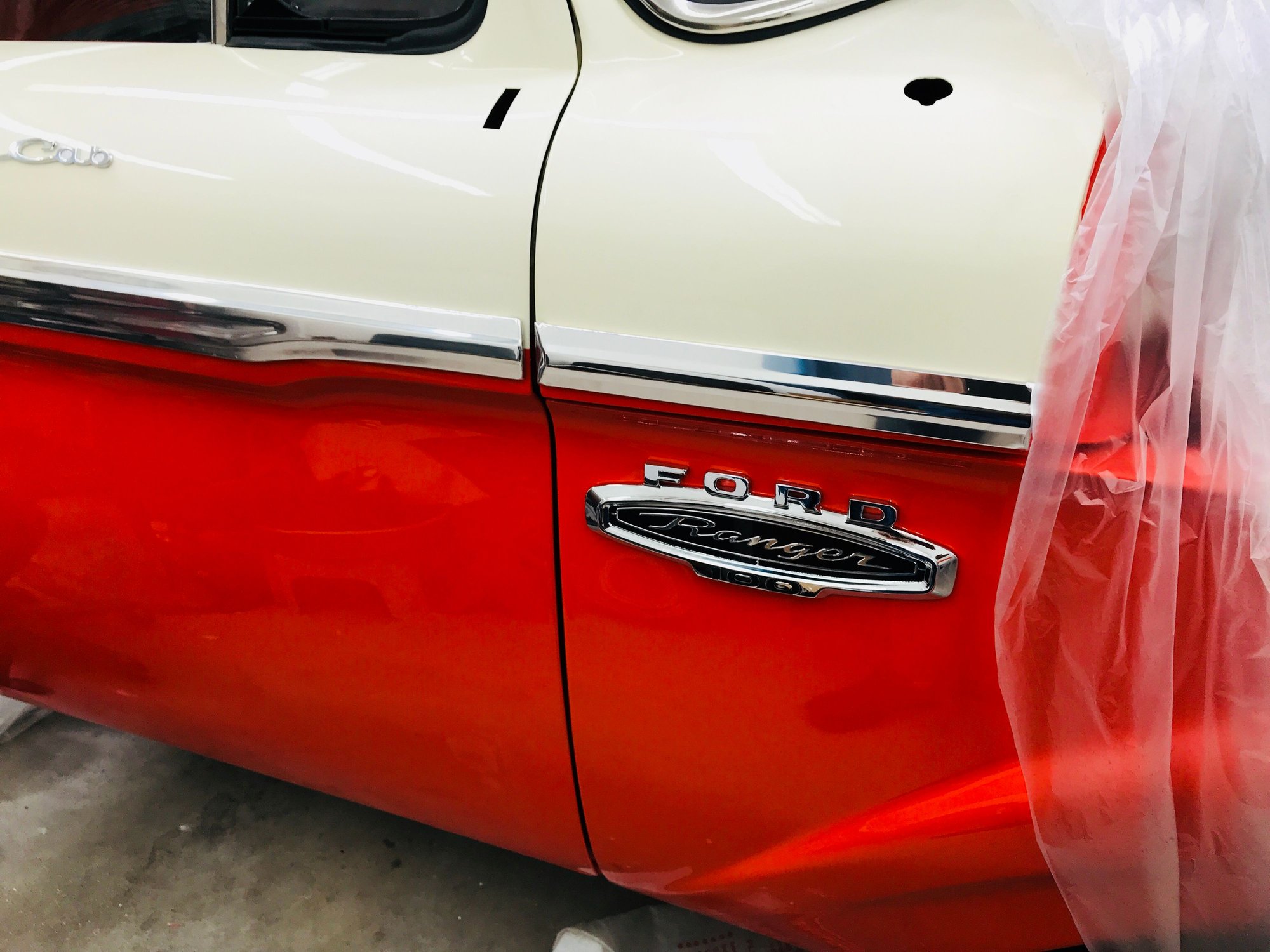

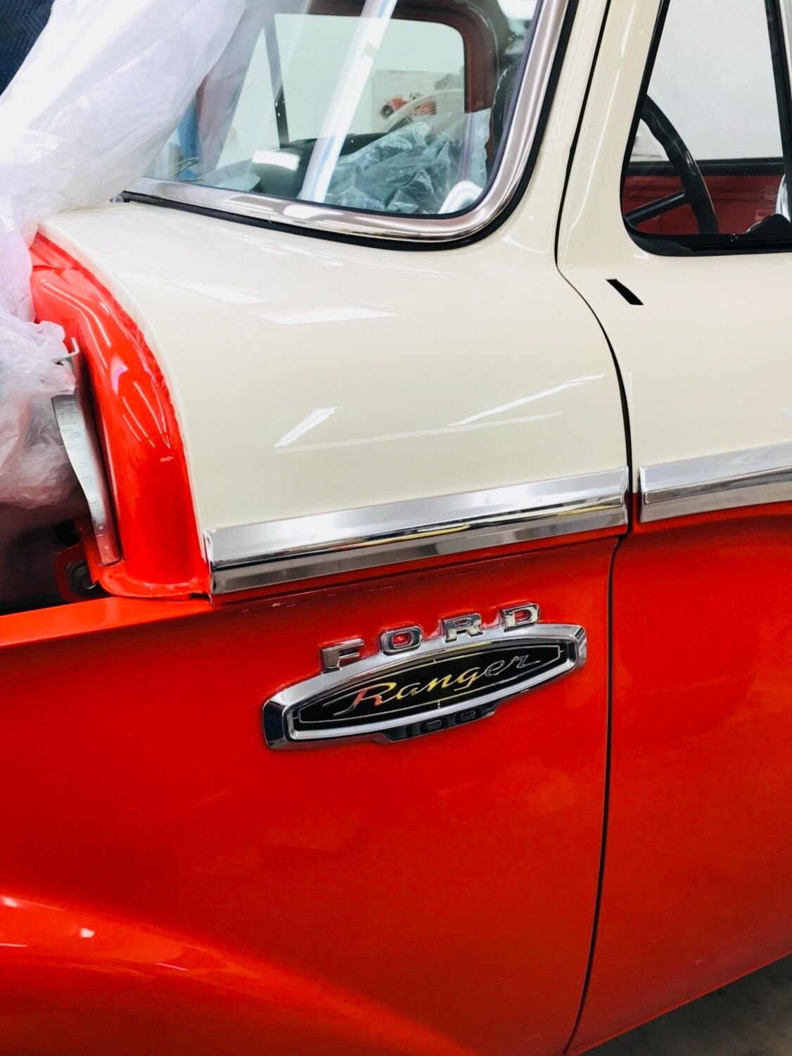

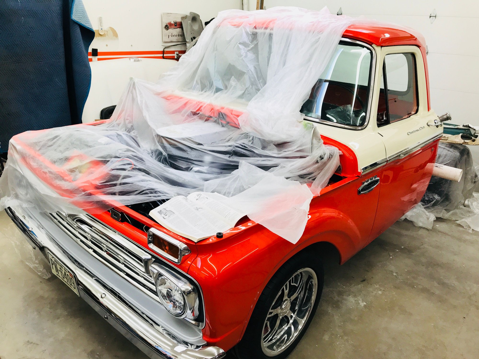

All glass in, side trim etc

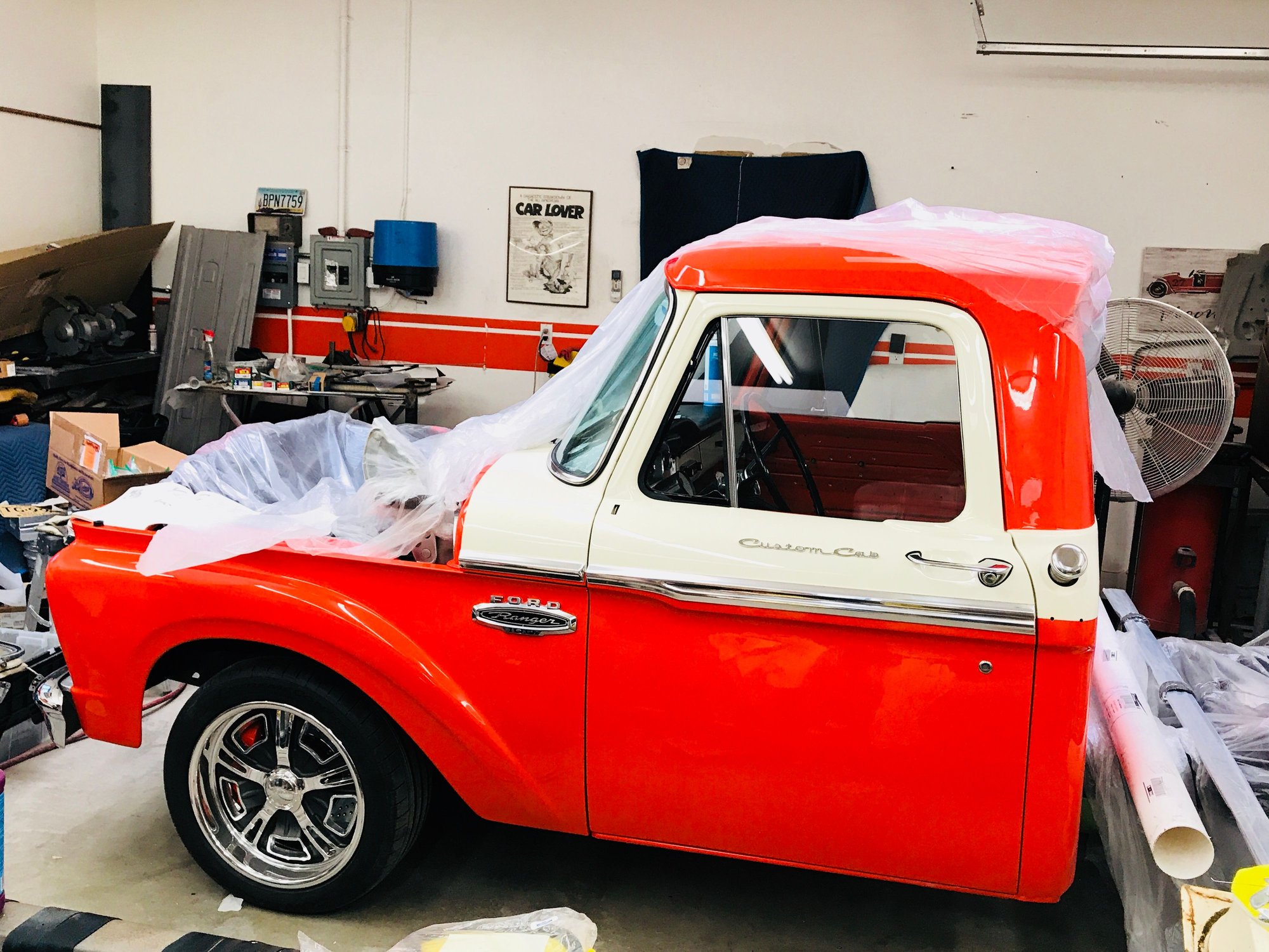

427 Truck walk around update
