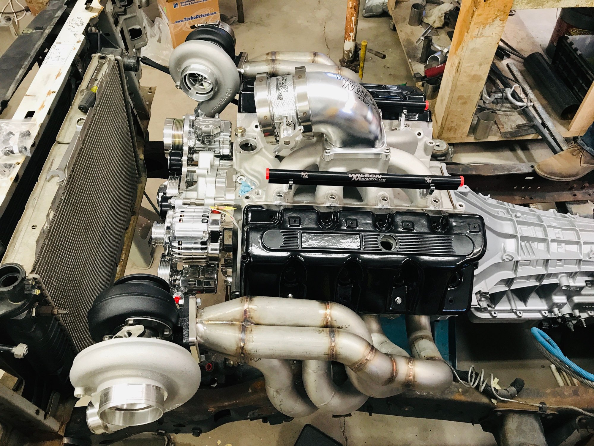

Good progress on the 540” TT B9 not a ‘66
but some may want to see update.

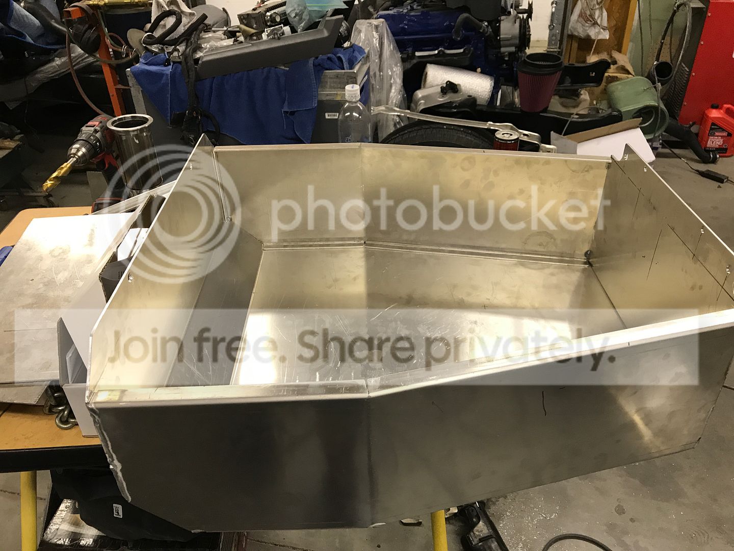

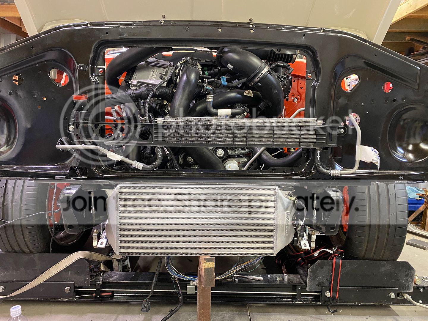

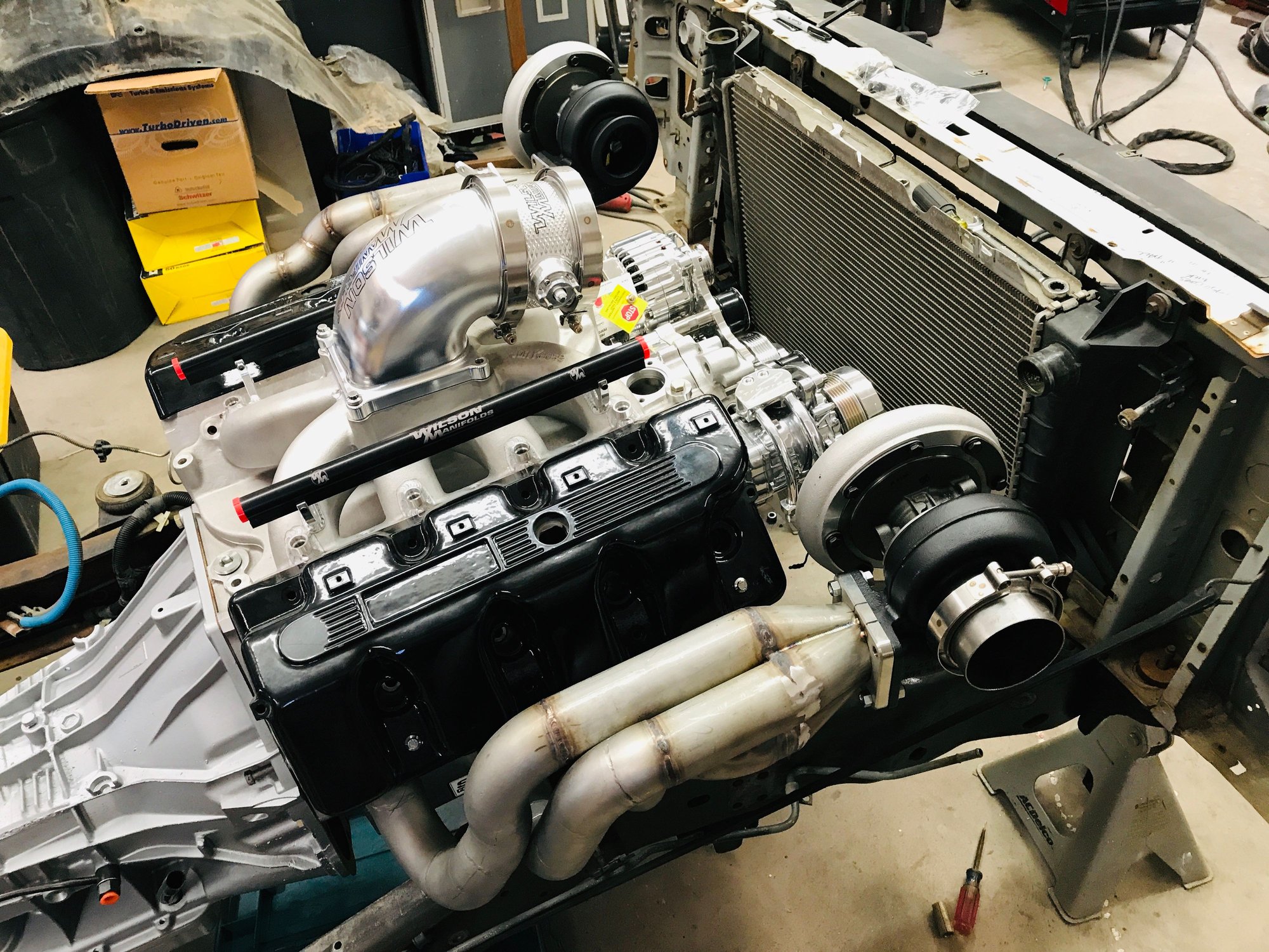

Built a 27 gallon fuel tank so will have total of 46 gallons. That should take me 900+ miles per fill! Tank pics are prior to baffling.
Also added a 83% larger intercooler from Garrett.
In process of modifying the inner fenders now to get all the Raptor parts to fit.
Undercarriage is pretty much done. Just a bit of cleanup of hoses, tubes and wires. Had to add a carrier bearing to the short bed to hold the power. Hoping for 600/600 at tire on E50.
Goal is within next week to have front clip inner sheet metal in paint. Fair amount of metal work to get the large AGM battery, PCM, PJB to fit on right apron. Had to rotate the battery 90 deg because the radiator is so wide. 42" vs 26" stock one.

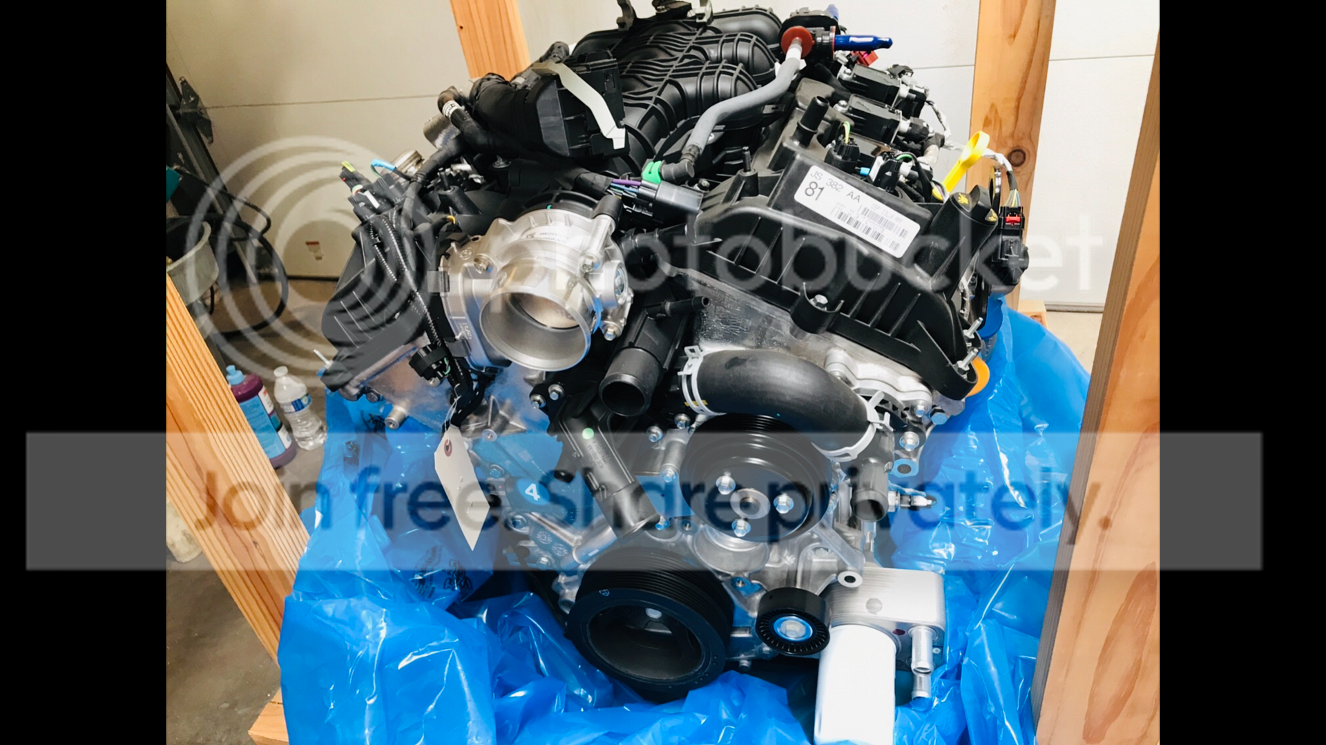

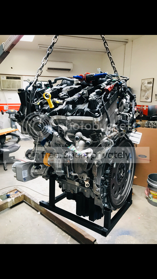

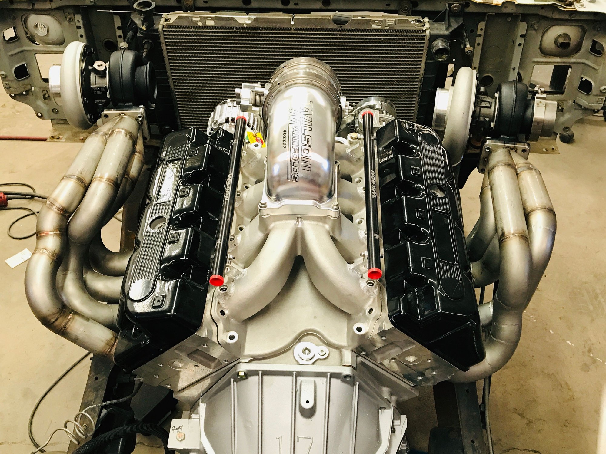

Bit of progress on the Raptor engine swap.

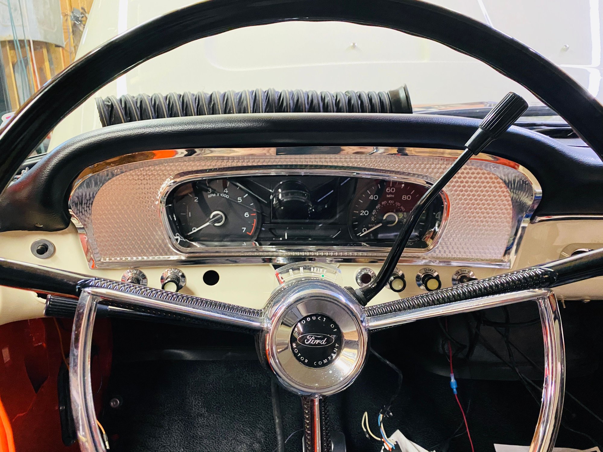

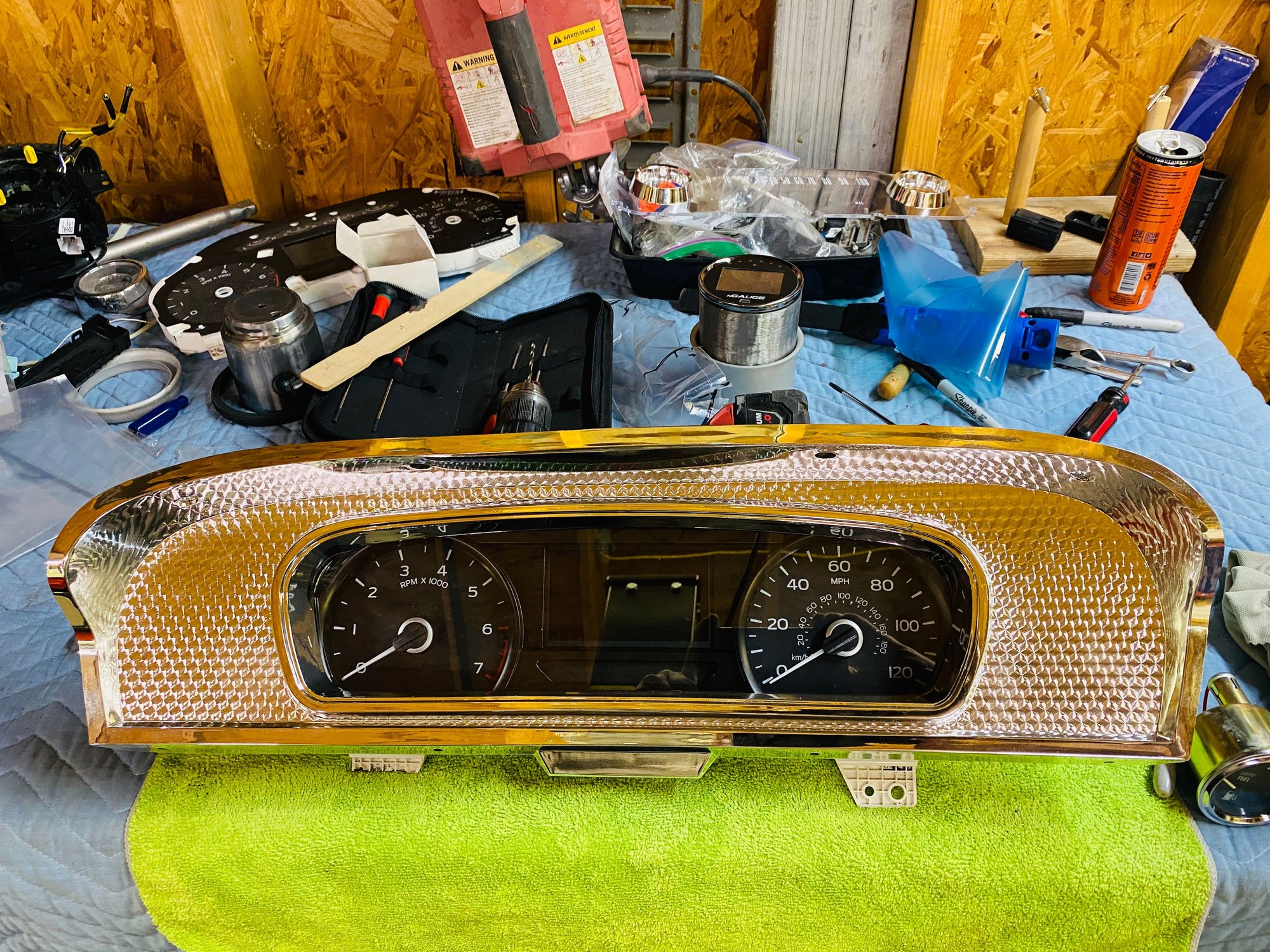

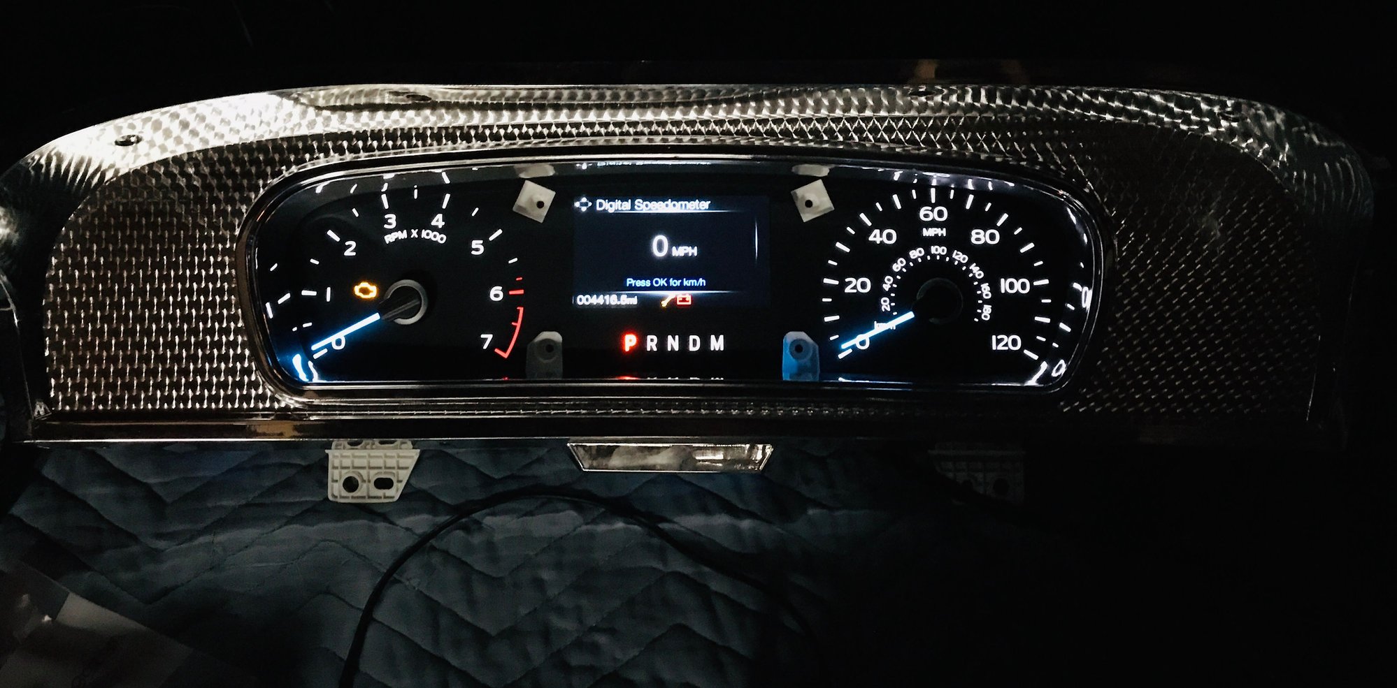

have the ‘66 CC bezel blended with 2018-20 cluster.
Black ring version.
Silver ring version. Cost was about 3.00 to convert.
