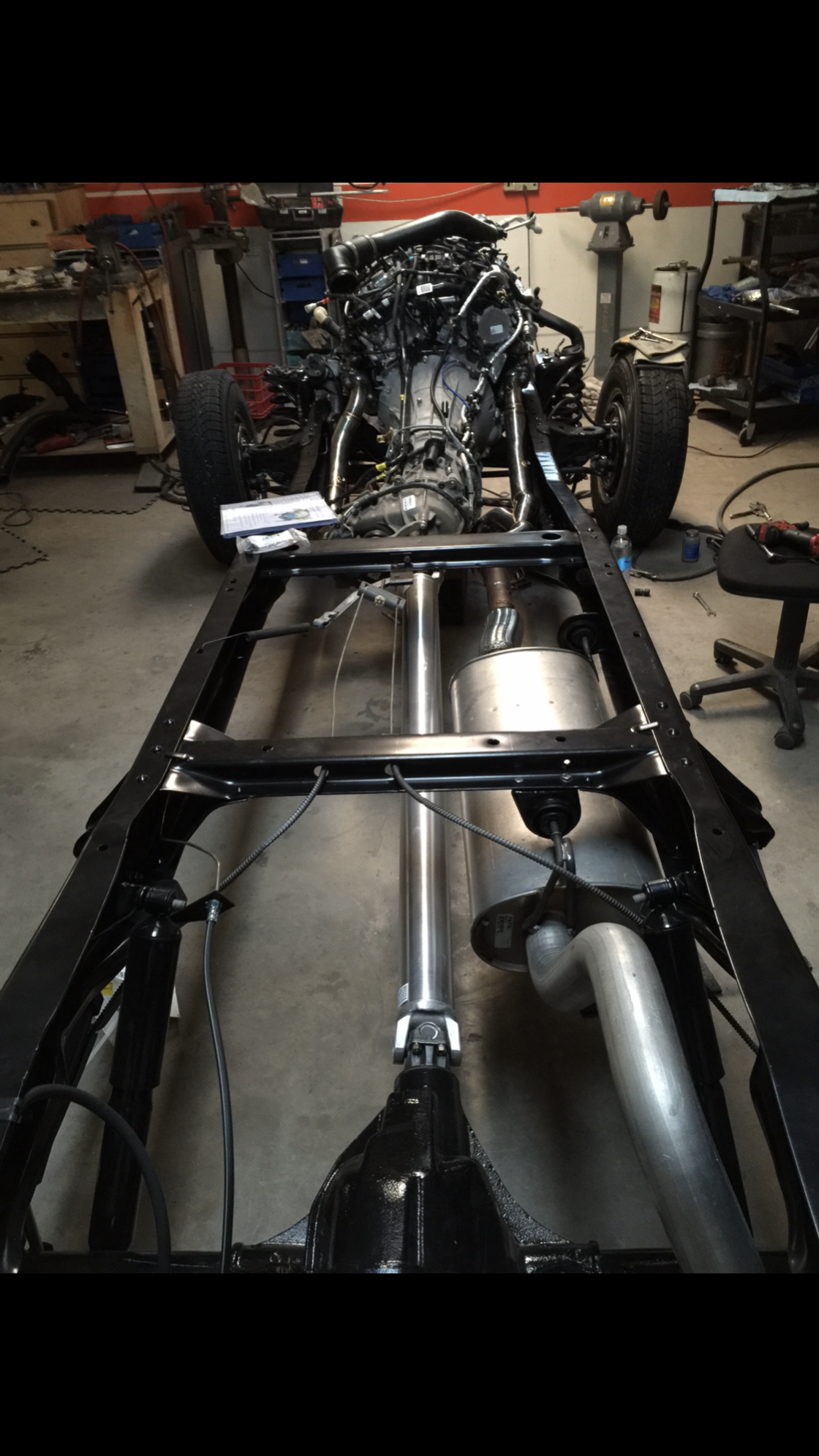

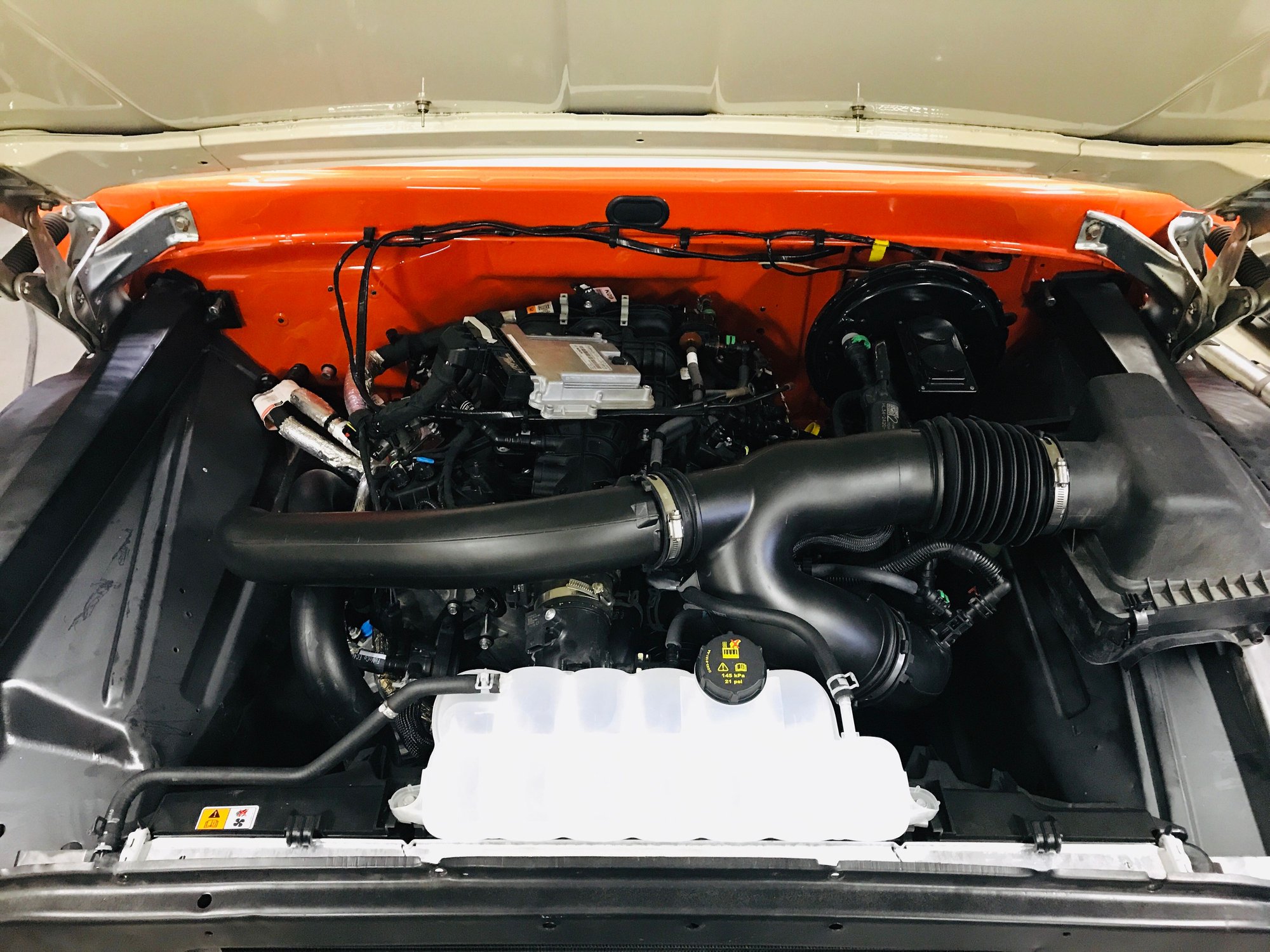

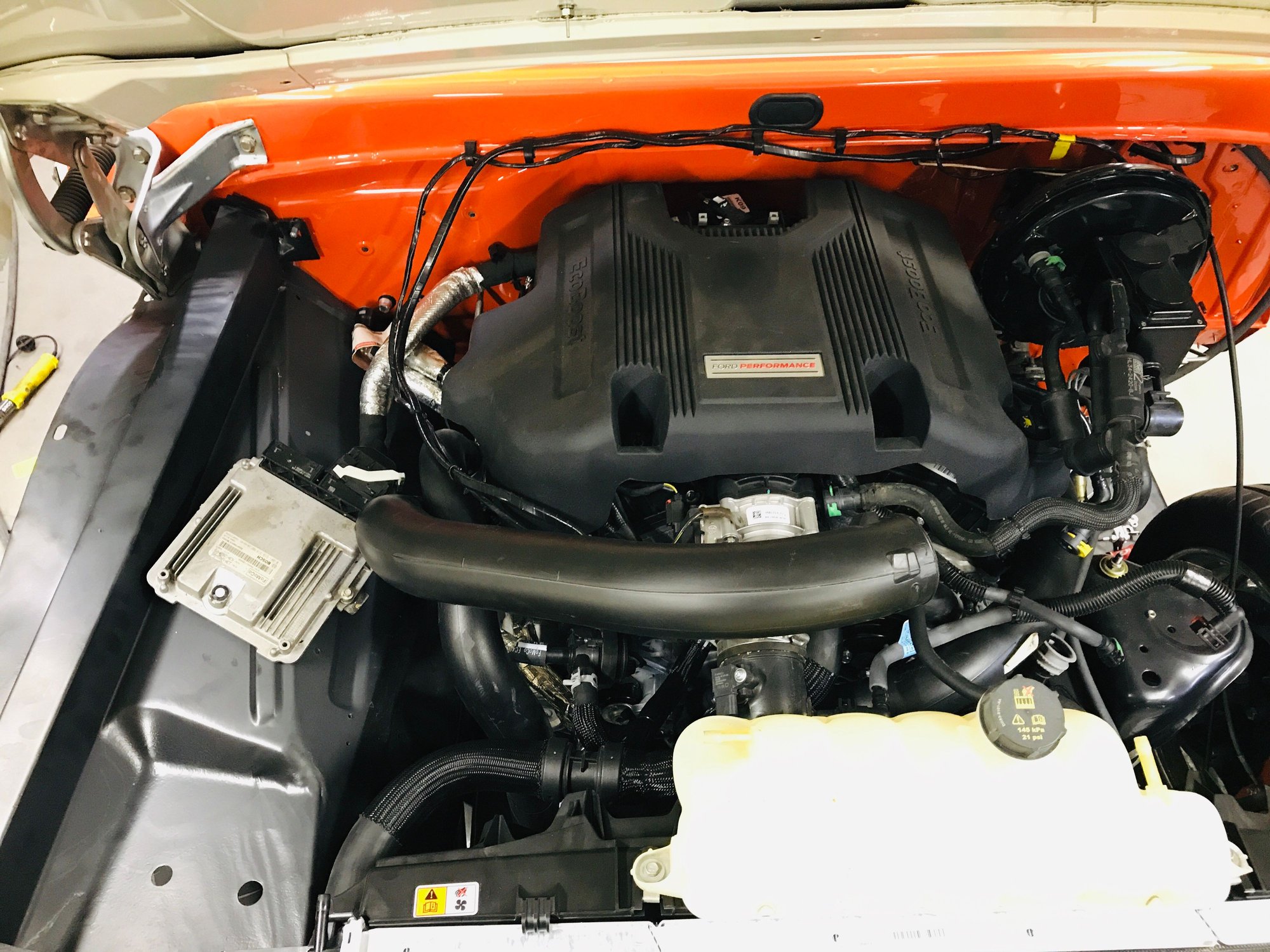

Eco2 ready for paint & final assy
Complete chassis for Eco2
This is state of Rainbow Ranger
1966 short bed Raptor crate swap w 10 spd. Now on to underhood stuff.

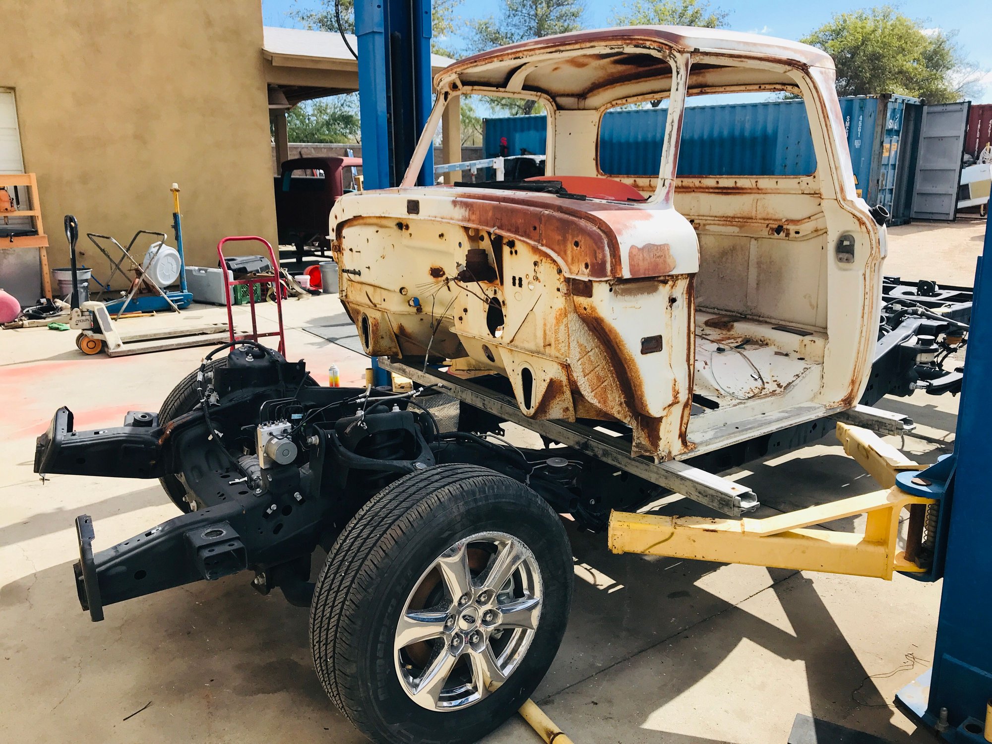

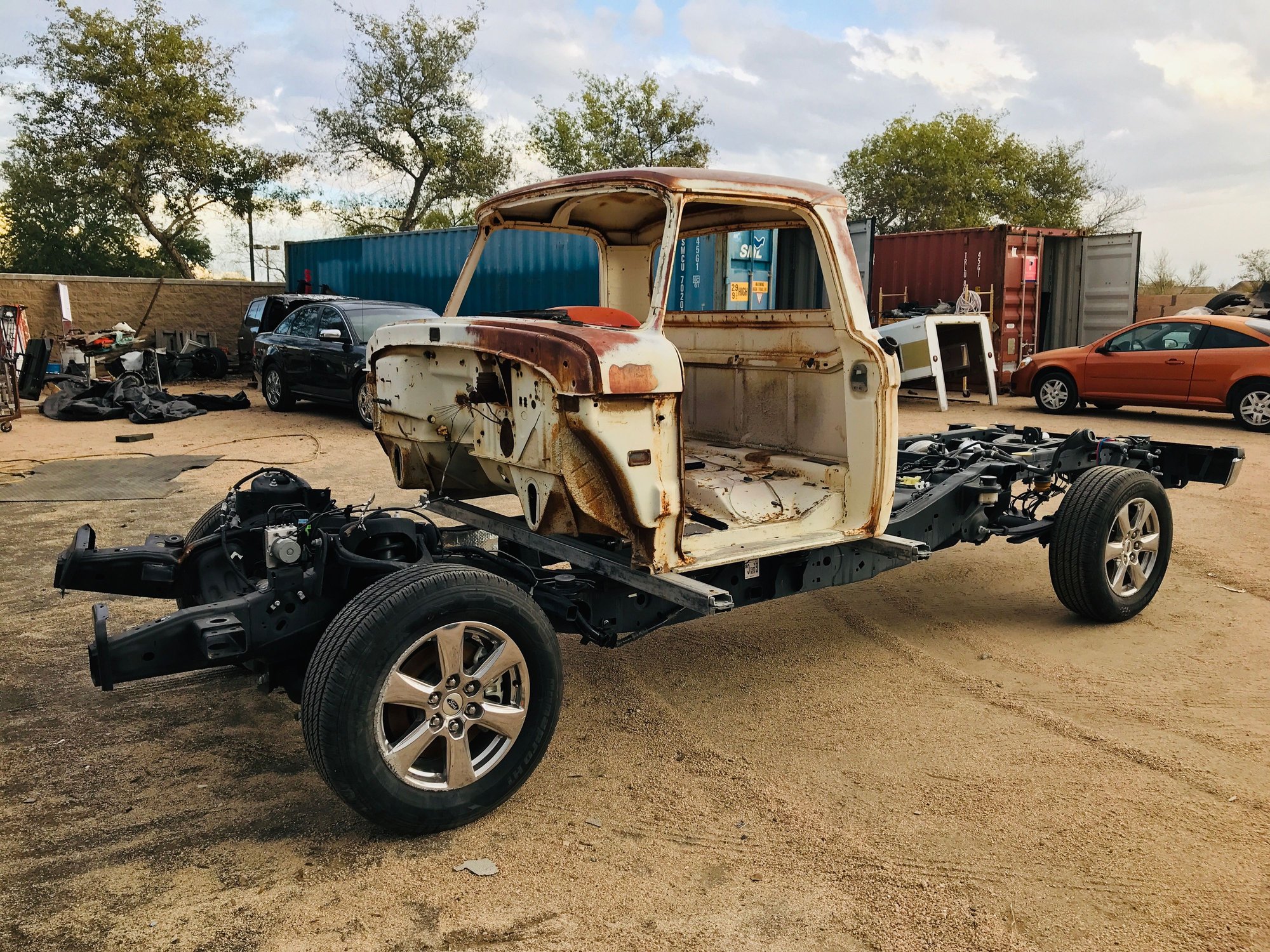

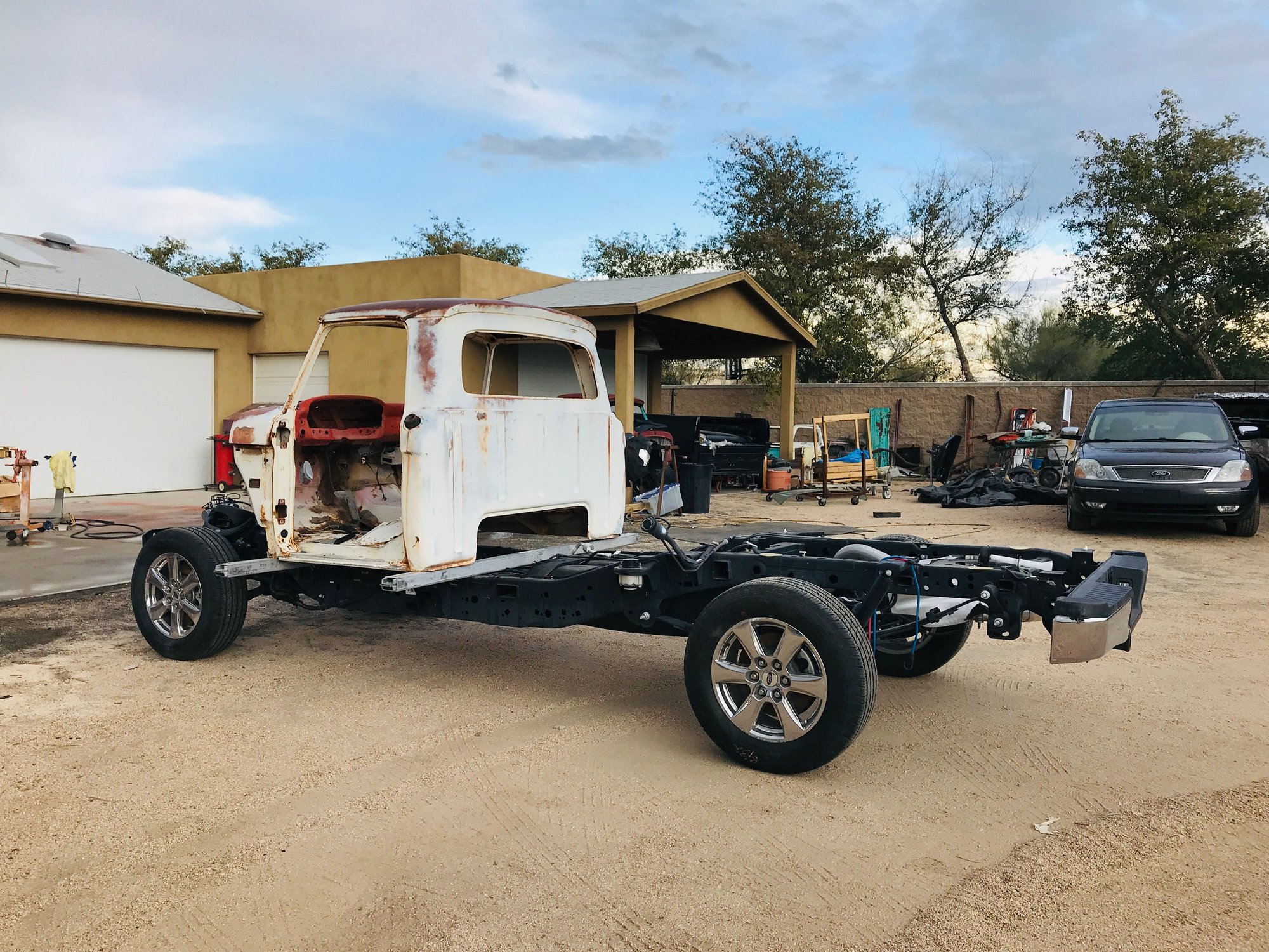

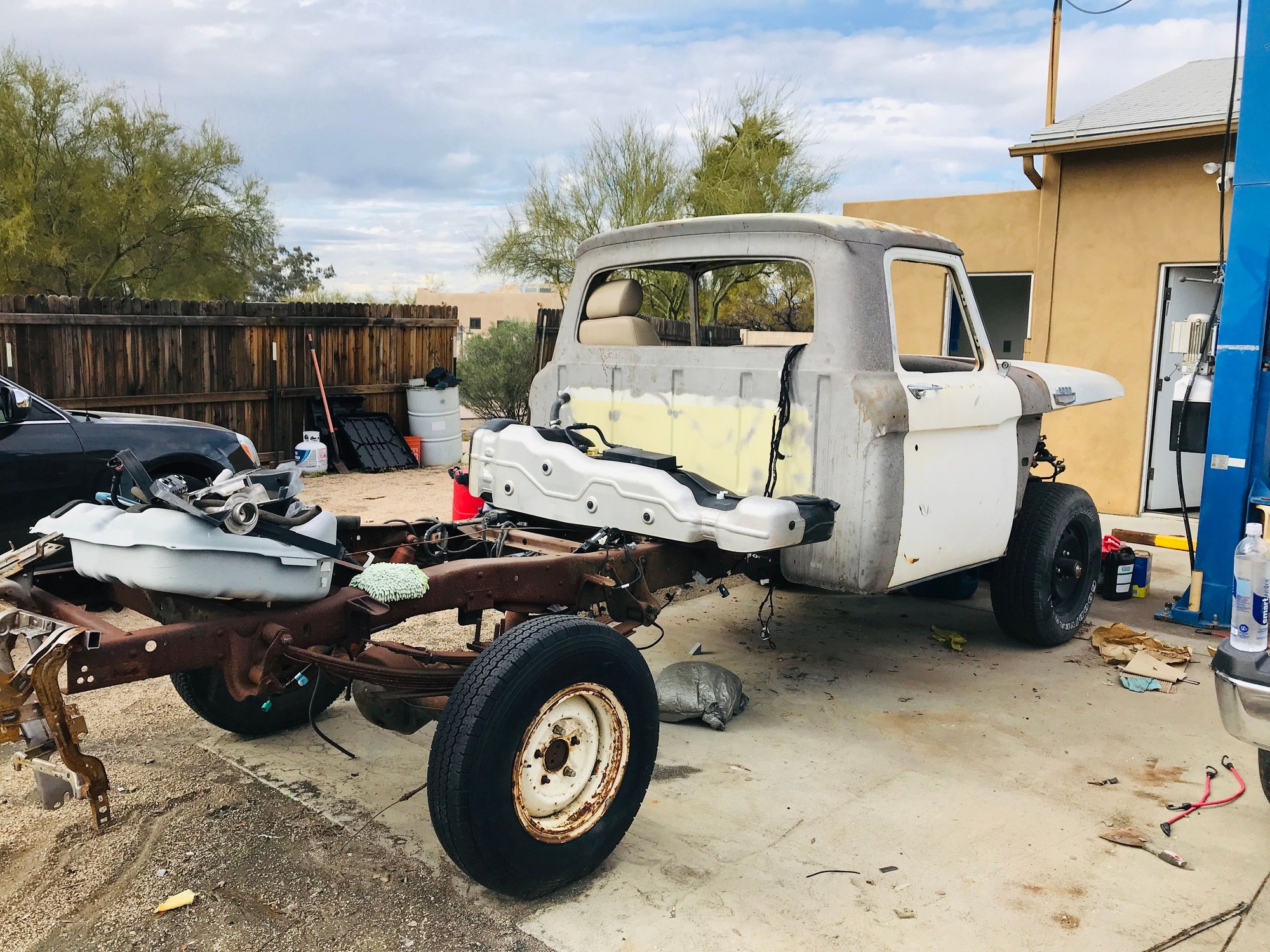

New project. 1965/66 cab n sheet metal on 2019 F150 chassis. It will allow for a 9’ 3” camper on back. I have a “spare” 27 mile 3.5 eco that may go in because of cost but because already on 4th ‘66 truck with eco would like to try something else.
This is a factory’66 4 x 4 with 2.7 eco
Eco2.7 and “CamperSpecial “
CamperSpecial 2019 chassis
2019 CS
Partial current projects. Why not much gets done!

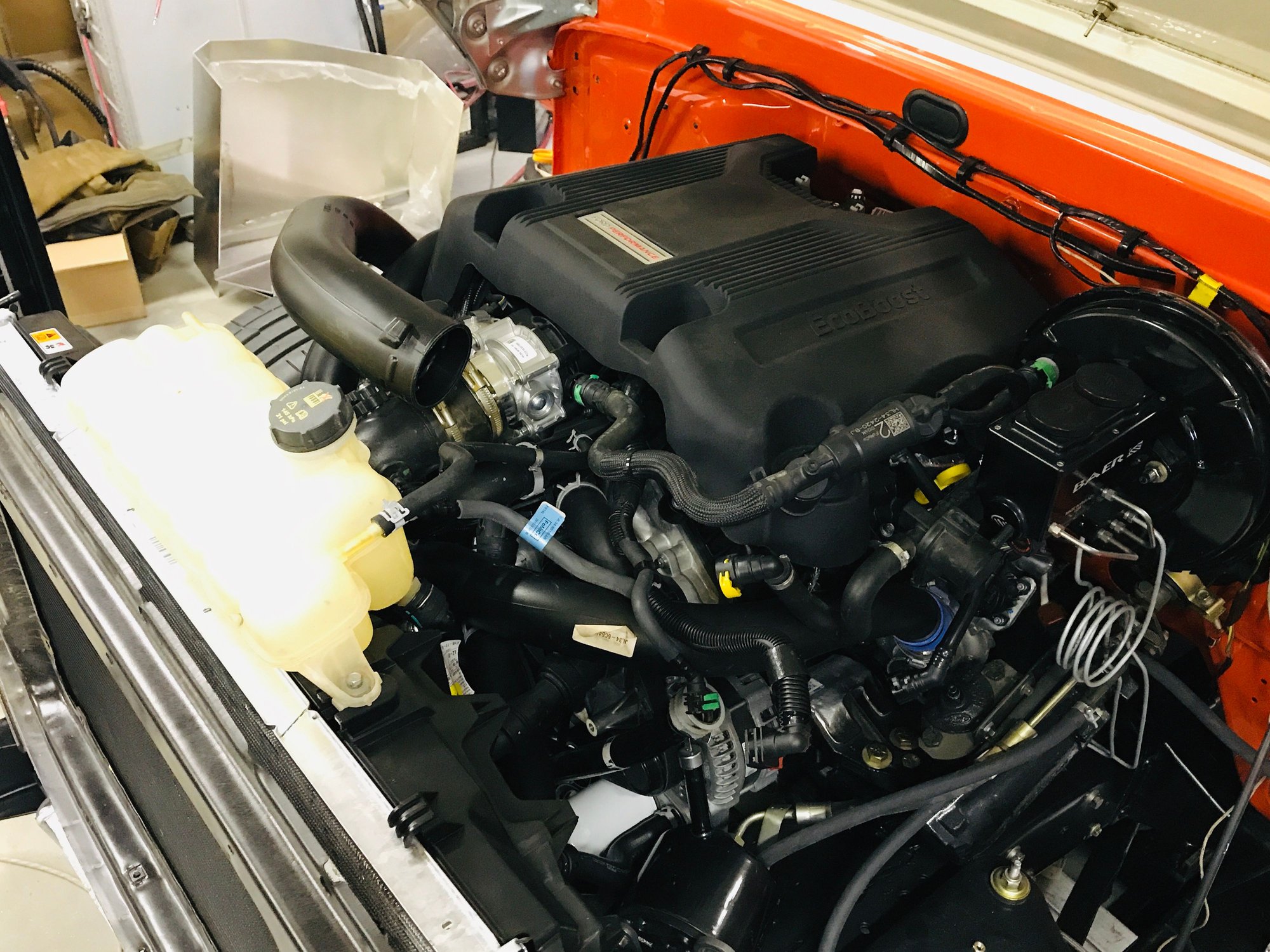

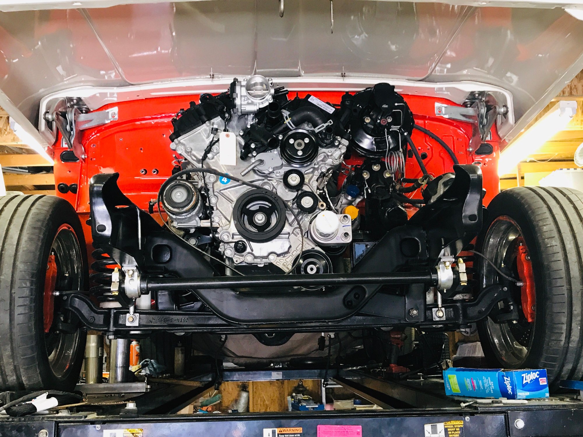

Bit more progress.
engine bay filling up fast!
unreal how easy it is to adapt 2018-20 F150 parts to the ‘66.

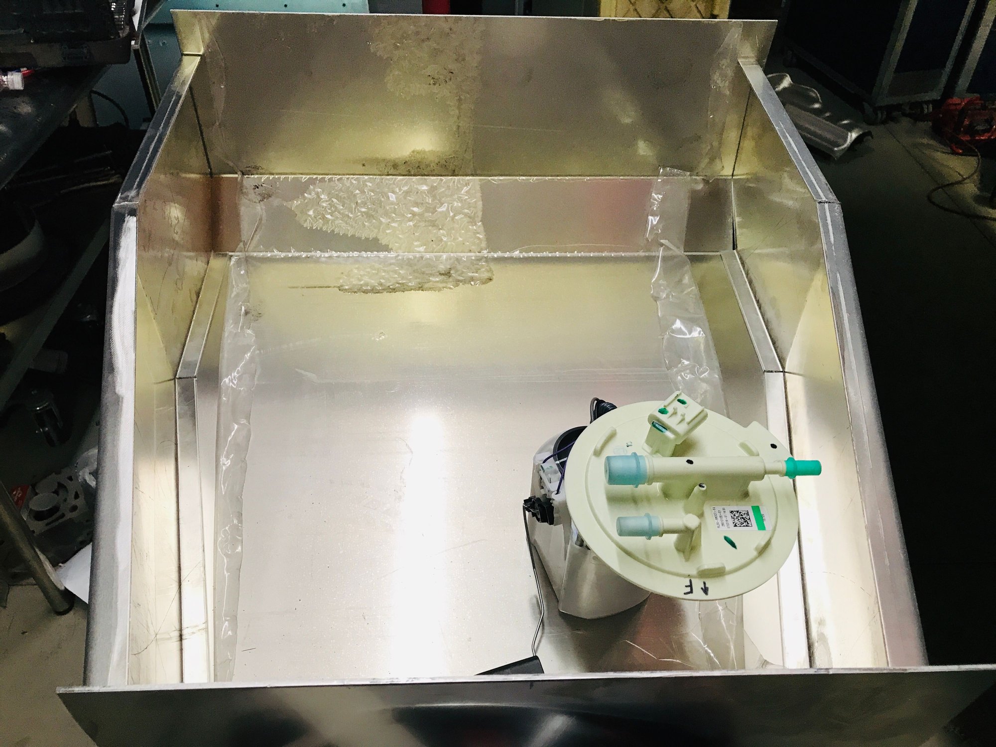

New 27 gallon auxiliary fuel tank.

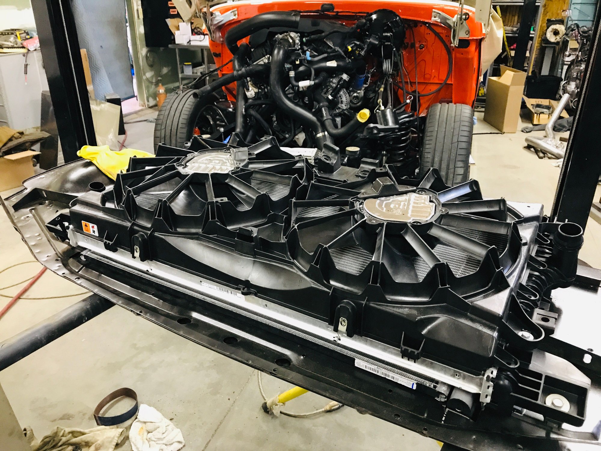

Raptor Radiator, condenser and fans adapted to ‘66 core support! The radiator is 44” wide. Bit tight but fits.

It took less than an hour to fit the 2018-20 Raptor Radiator, Condenser & cooling fans to the '66 Support. About an hour to fit the left apron to support and about 30 minutes to fit right apron to support.
This radiator is 44" Wide vs the what 27" wide radiator for the '66? This is a BUNCH easier than changing 63-64 style core support to a '66!
A HUGE learning curve trying to understand the wiring harness portion as I was WAY overthinking the Can-bus. In reality it's quite simple to add or remove anything one may or may not want on the canbus. A false turn and engine may not start but easy to test & do) Ok, I did have a Ford engineer stay over for a few days to teach me the ropes & he made it look so easy. A FEW more lessons and I think I will get the hang of it. My last FoMoCO how to wiring class will take place next week. Will post some "how we did it's" when done if enough interest. The wiring under dash will probably be less complicated than a Stock '66 custom cab.
In process of attempting to add the 2018-20 Raptor Transmission cooler setup which is a bit more complicated and different from the normal F150 which has the pancake type filter mounted to front of transmission even in the max trailer tow. Short trans fluid lines run the very short distance to cooler then long tubes run up front to carry coolant along with a pump to circulate it all.
