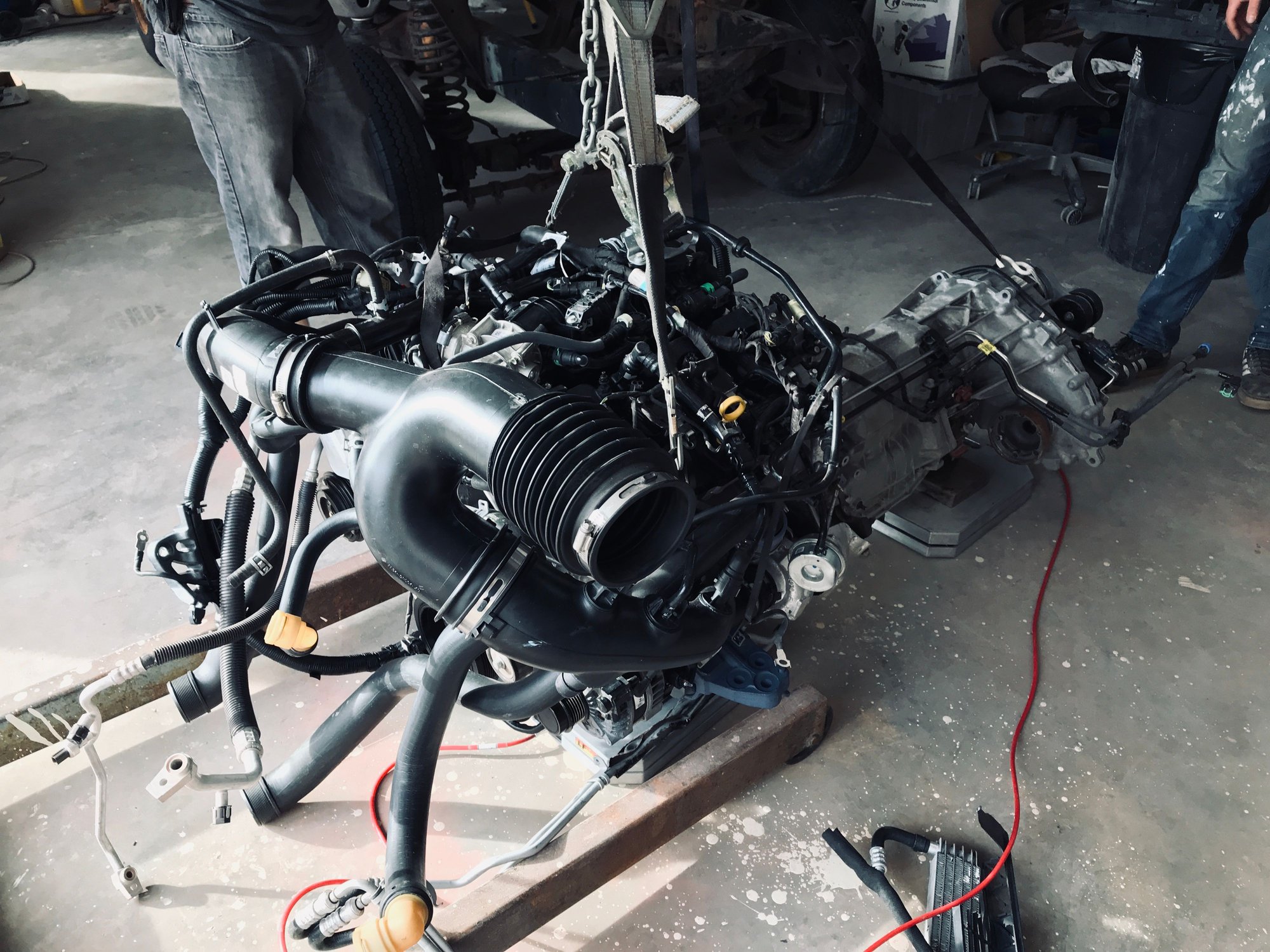

2.7 now ready for it’s new home!

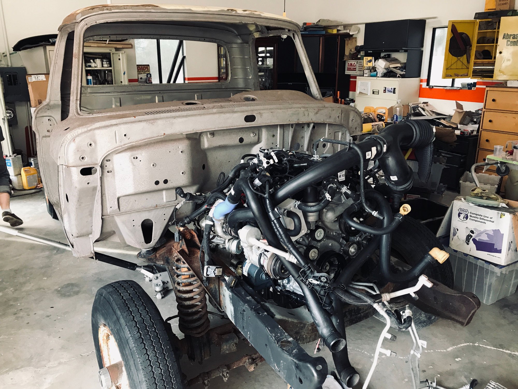

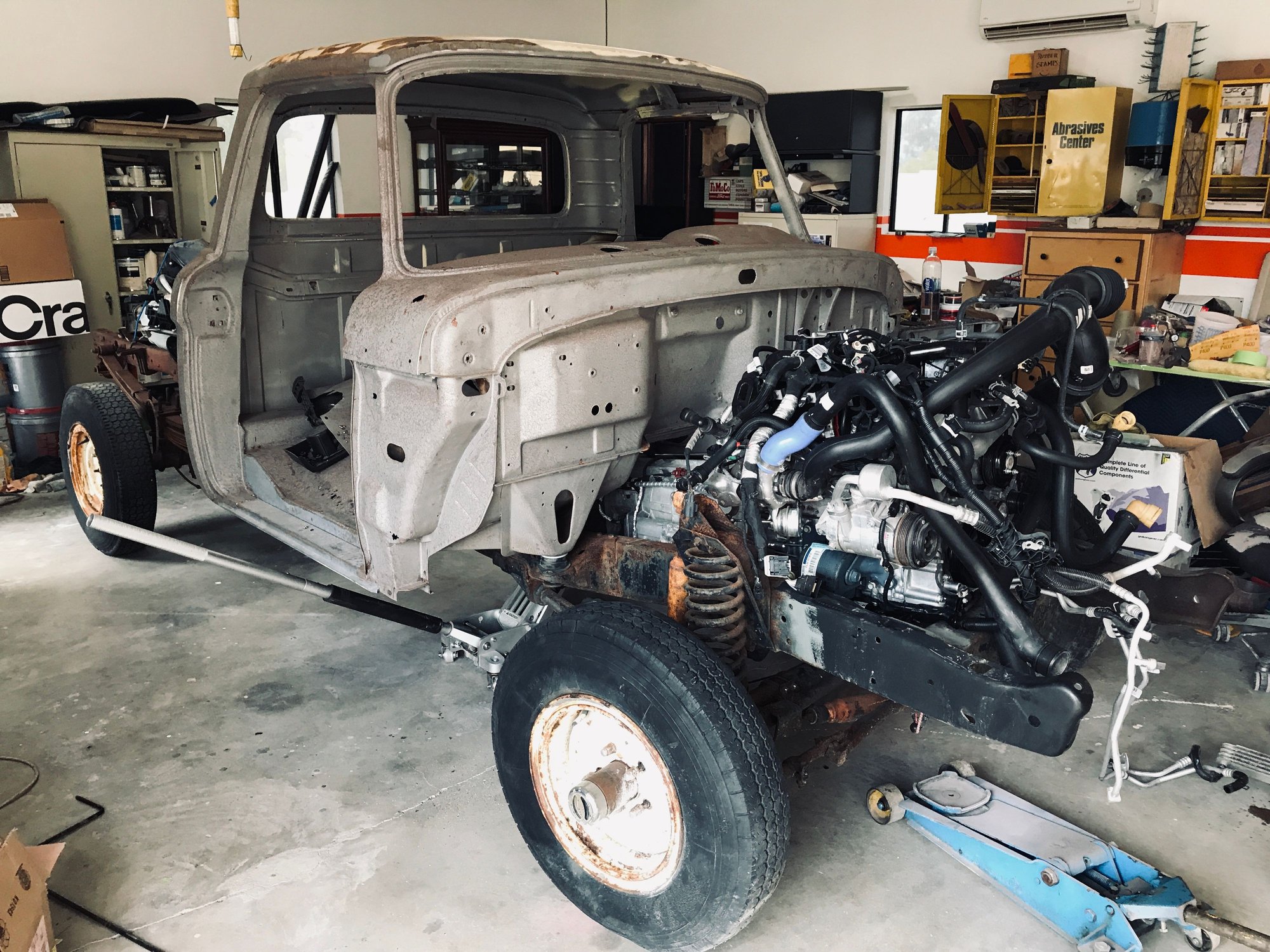

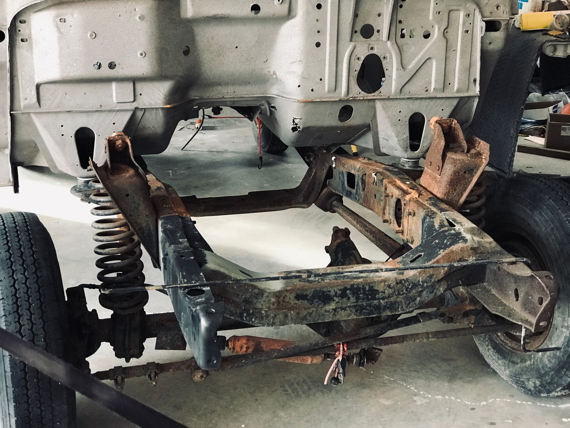

2.7 eco in a 1966 F100 4x4! Fantastic fit! So well I can use stock engine mount location no welding needed!

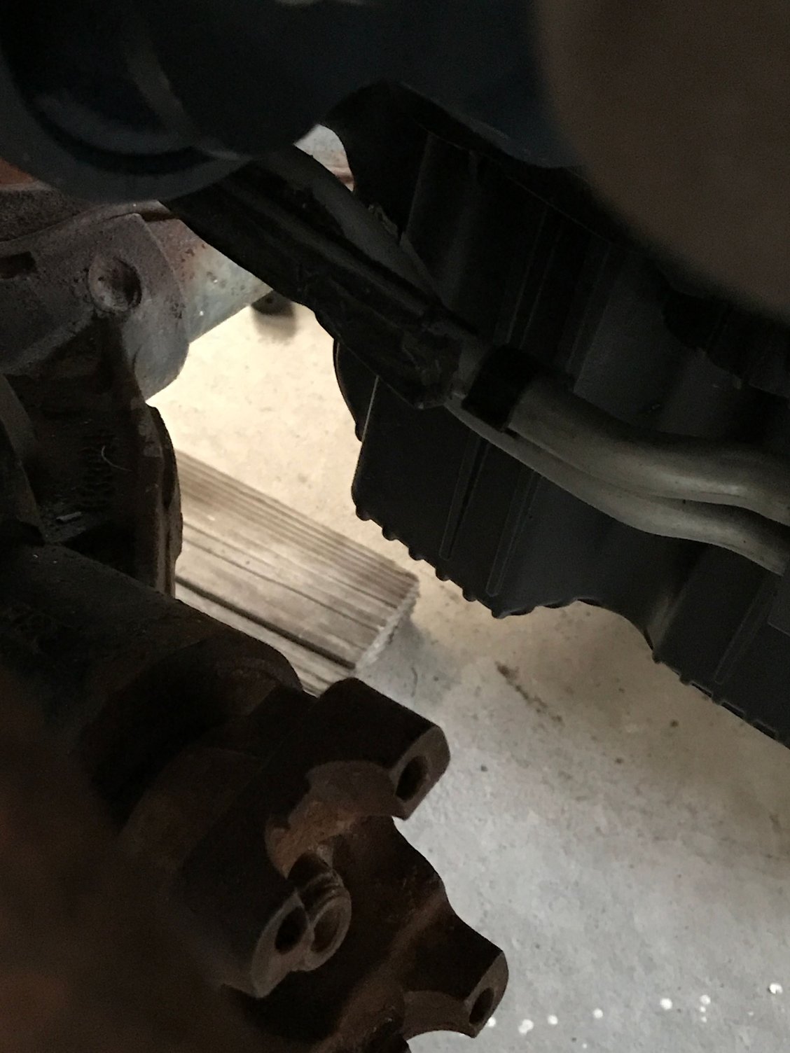

This should be a great build. Most of what you do should apply to the F100/150 4x4 trucks all the way up to '79 and also the '78/79 Broncos. Any issues with oil pan clearance on the front axle? Also, transmission/transfer case clearance at the cab floor. Since your cab is a 4x4/4spd with the removal high hump I assume no issues but do you think it would clear with the standard floor.

no oil pan clearance issues for entire front suspension travel! Yes, it will clear the standard floor hump no issue. Not even a tweak.
Transfer case close to cab crossmember depending on how high one has it. Push came to shove one could grind a touch or rib
