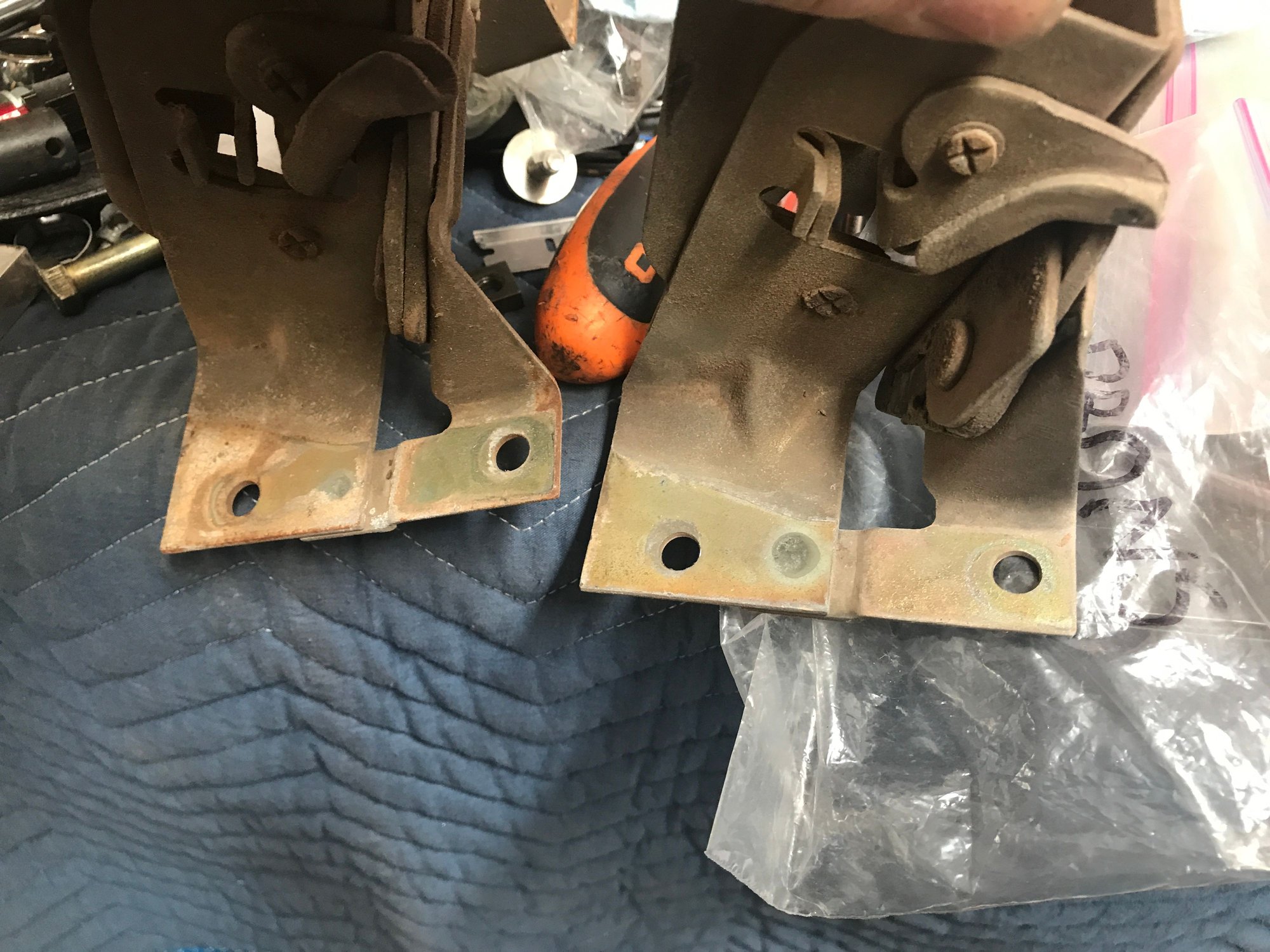

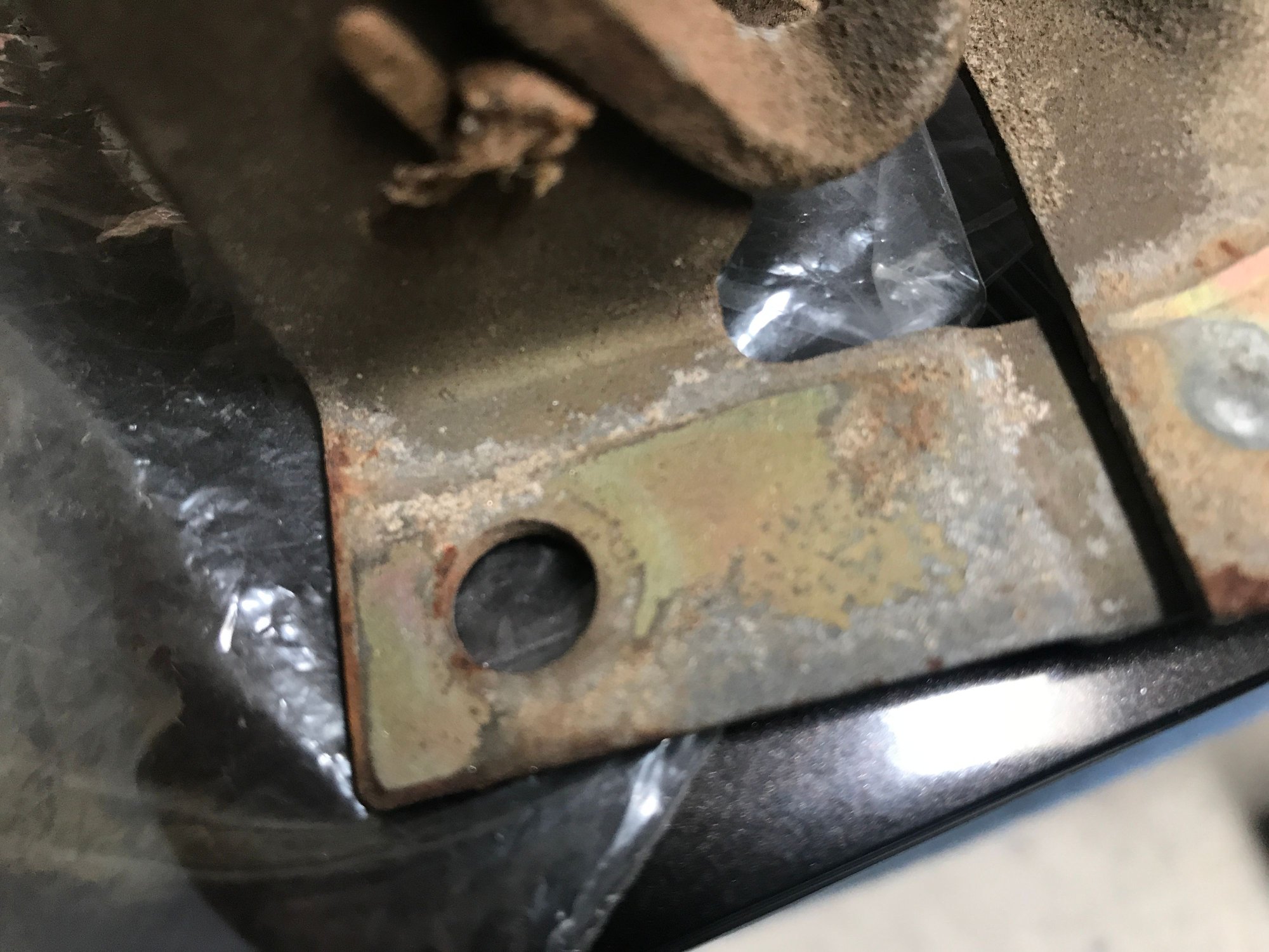

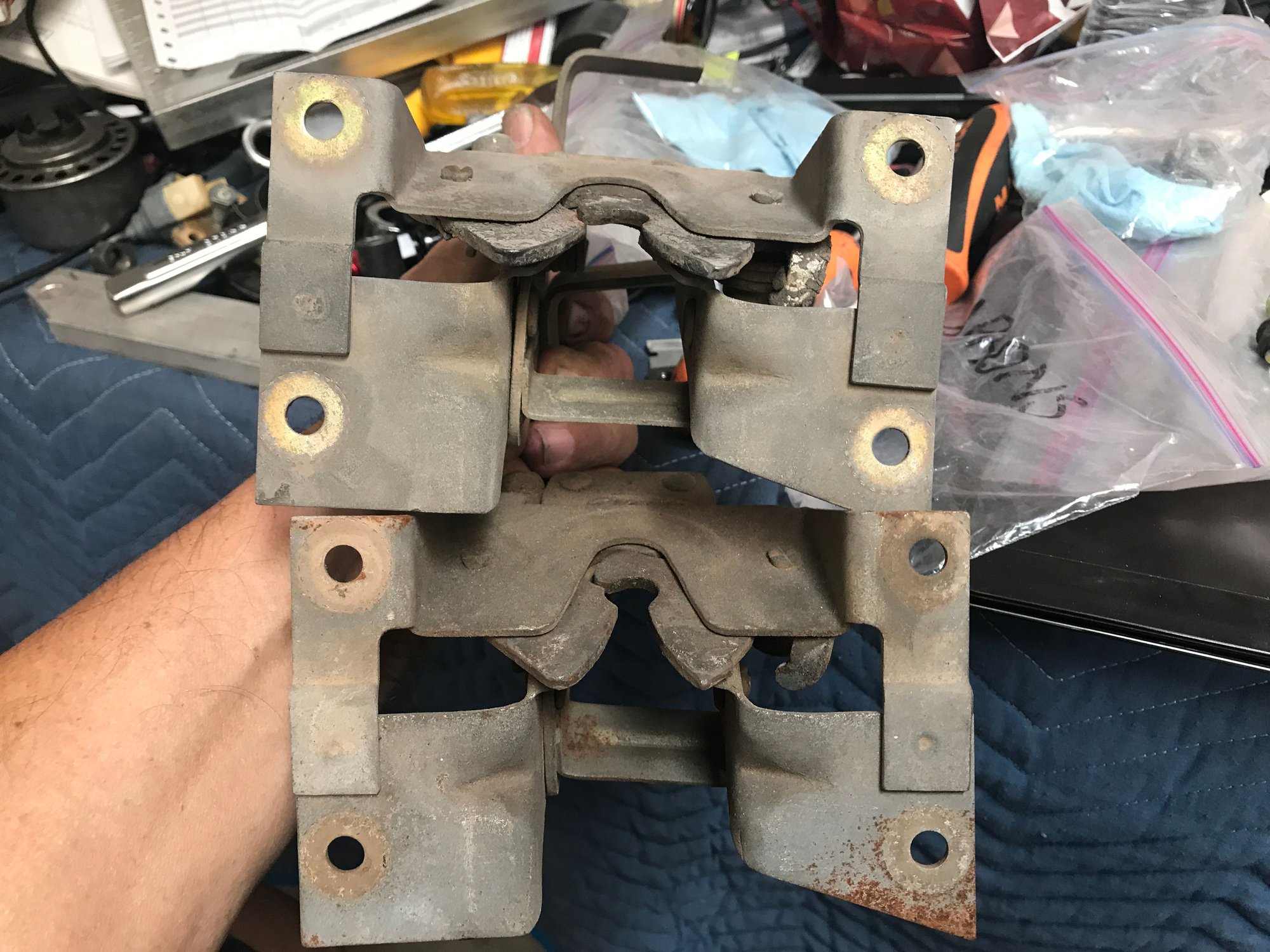

i have seen many trucks in the gold finish. It simply did not last long especially in states with mor humidity. After it was gone they look less KR phosphate. Easy way to tell is mint phosphate will have kind of a metallic finish although dull. 427 truck Dallas , f250 Ranger San Jose and at least 3 others I have here it’s obvious were gold finish. I forget now but was called yellow zinc or cad. Not gold. I will find pics prior to plating. Only area left was bottom of where it bolted to upper valance/grille piece.

a few examples. More so in San Jose than other plants

ya might want to look under bolts and on bottom side prior to thinking it was not original like that. Especially on your late San Jose truck.

Definitely a dark gray here. On all my originals and NOS ones. Must be different vendors. Look at the release handle itself and how much different shape it is on mine here from my Ranger than yours. Mine is very square along the back edge (top as seen in the photo).

Gold/yellow clearly visible under where bolts were. Also note on both hood latches they had washers with serrations vs flat washer.
You must have missed my point as I was trying to agree with you...but alas.
