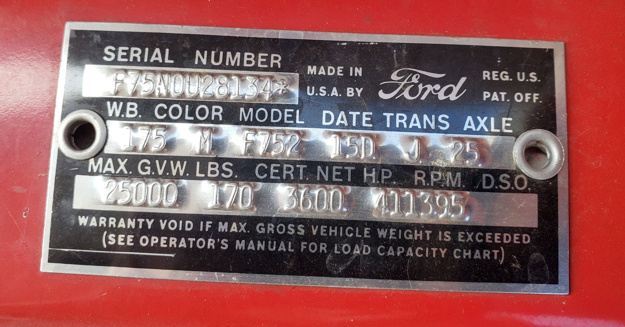

Looking for so basic info
Howdy Numbers found an old 1960 firetruck now side dump down the road. Wasnt looking one but had to have it when I found it. No idea what I will do with it. Plates expired in 2014 but primed the carb and added break fluid gave it a jump and drove it home had been sitting for the last 5 years. Says something for this old truck!

Originally Posted by mog797
Howdy Numbers, found an old 1960 firetruck now side dump down the road. Wasn't looking one but had to have it when I found it. No idea what I will do with it.
Plates expired in 2014 but primed the carb and added brake fluid gave it a jump and drove it home, had been sitting for the last 5 years. Says something for this old truck!
Anyway was wondering about info on this truck.
Welcome to FTE
F75 = F750 (gas).
N = 302 4V (Lincoln derived Y block).
0 = 1960.
U = Louisville KY Assembly Plant.
28134 = 1960 Numerical Sequence of Assembly, the trucks specific serial number.
175" Wheelbase.
M = Corinthian White.
F752 = F750 (gas), 25,000 lbs. GVWR
15D = Assembled April (D) 15, 1960.
J = Clark model 250V 5 Speed Direct.
25 = Eaton model 1614 or 1615 Single Speed Rear Axle / 7.17-1 / 16,000 lbs. Rear Axle Capacity.
25,000 lbs. Gross Vehicle Weight Rating.
170 net HP @ 3600 RPM
411395:
41 = Chicago IL Ford District Sales Office, where the original selling dealer ordered the truck from.
1395 = Domestic Special Order number, truck ordered special by the original purchaser, not "bought off the lot."
