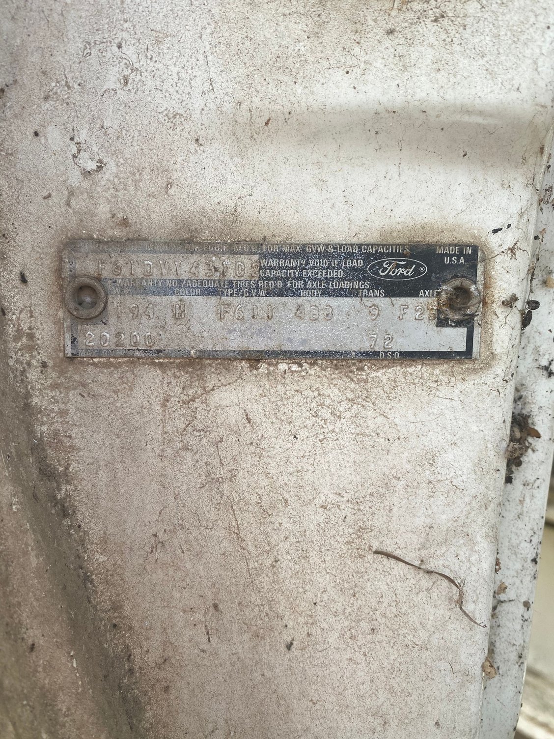

I need help!
Hello everyone,
I just bought a 75 F600 and I’ve been trying for days now to decide the vin tag. I know it has a 330 HD and a NP542 but I can’t find anything about axles.
I will attach a picture of the door plate. Any information would be greatly appreciated!

F61 = F600 2WD (gas).
D = 330 2V Heavy Duty FT engine.
V = Kentucky Truck Assembly Plant.
V43102 = 1975.
194" Wheelbase.
H = Wimbledon White (code used at KY truck plant only).
F611 = F600 2WD (gas), 20,200 lbs. GVWR
4B8: 4B = Black Heavy Duty Vinyl - Full Width Seat / 8 = 81A Standard Cab.
9 = New Process model 542-FD 5 Speed Direct.
F25:
F2 = Eaton model 15201 Two Speed Rear Axle / 5.83/8.12 / 15,000 lbs. Rear Axle Capacity.
5 = Ford 9,000 lbs. Capacity Front Axle without Power Steering.
20,200 lbs. Gross Vehicle Weight Rating.
72 = San Jose (NorCal) Ford District Sales Office, where the original selling dealer ordered the truck from.
