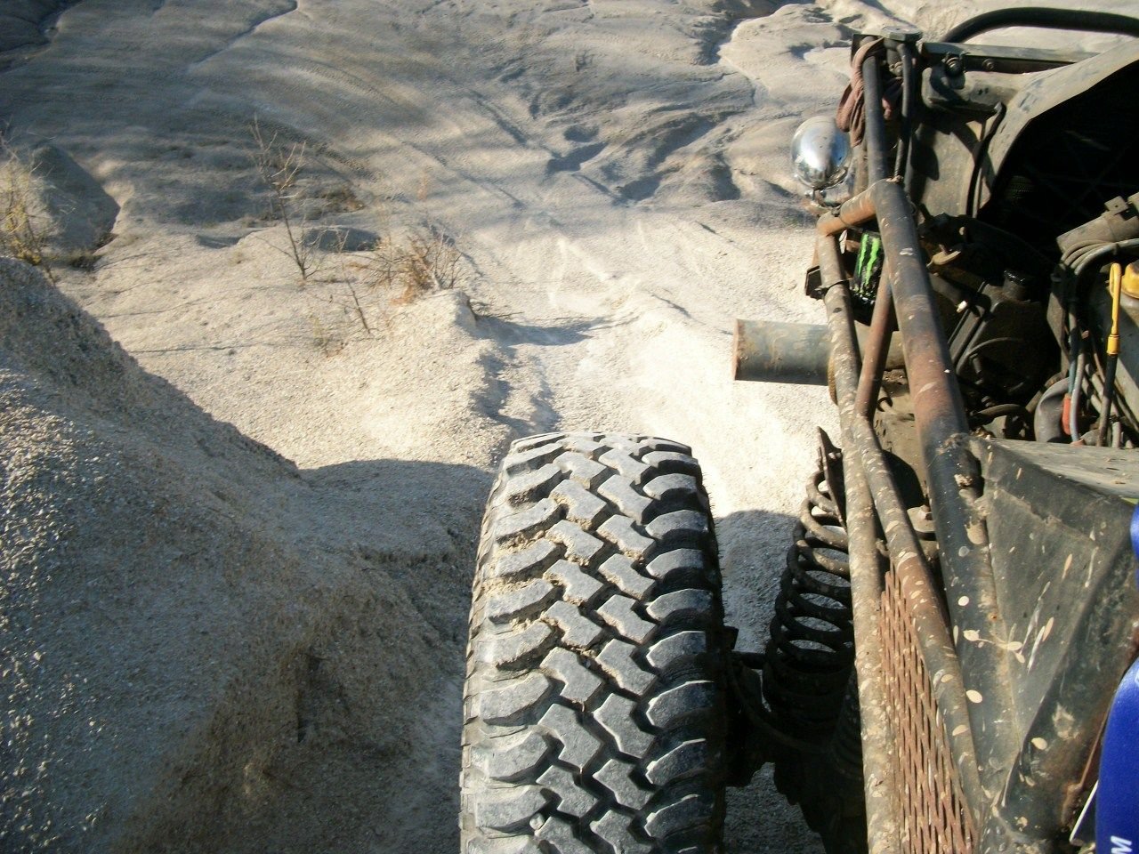

Did I mention I had some other fun?

didn't know there was that much sand in Ozarks.
"Did I mention I had some other fun?"
yeah, till the PS went.
Glad "HbB" was available...is it twice as able as the "Red One"?
No advantage? 1/2 as betterer? 4X? It seems the power-to-weight, open (actually No) fenders, etc would B an advantage...?

That is not sand, it is a chat pile, the place use to be a rock quarry.
We have a 1450 acre sand lot next door in Waynoka Oklahoma.... https://www.travelok.com/state-parks/4581?CMP=PPC_G_SP123_LittleSaharaStatePark&utm_sou rce=google&utm_campaign=State%20Parks%20(1-3)&utm_medium=cpc&utm_content=Little%20Sahara%20St ate%20Park&&gclid=Cj0KCQjw28_XBRDhARIsAEk21Fi5qS8T-z1GJwbrXxZXnuk4YOF9xxXb9lw_YwuT2MsPlXPNJQkAEaAsI VEALw_wcB
Red has a rear spool and front locker, the HbB is stock/open diffs. Each has its bonuses in their design.

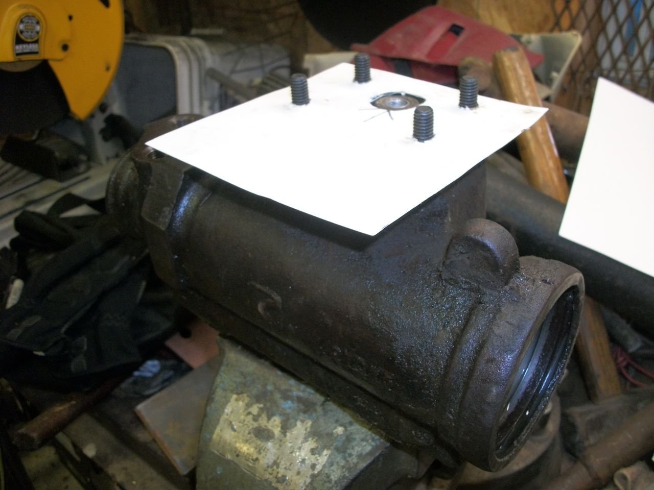

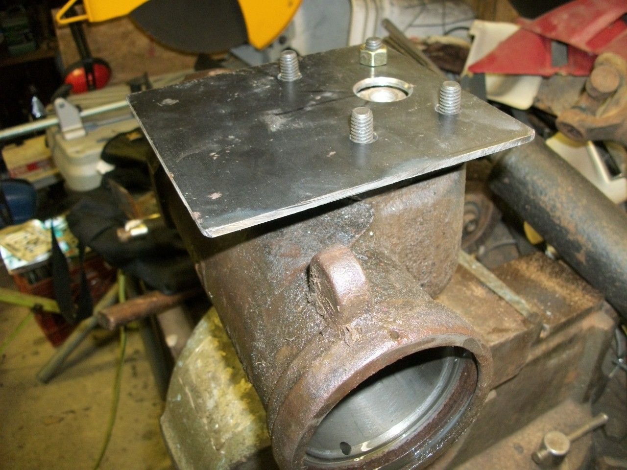

Ok so the new/used box is back and ready to go in. I am doing some p/s box brace fab work 1st. Converted my old cracked p/s box cap bolts to studs. Made me a pattern, then made the 1st part of the brace. Figured out it was to thin, so upped the material thickness. Almost figured it out, just have to get some more material for the 2nd part and go from there.
I plan on adding another piece that will come down the inside of the frame and bolt on with the p/s box mount hdwr. It will be welded and T braced at the joint. More pics to follow.

some of those mods (in ur pic) seem over the top.
Are extreme measures needed due to mounting on the outside of the frame
or
just standard measures for 'rough stuff'?
