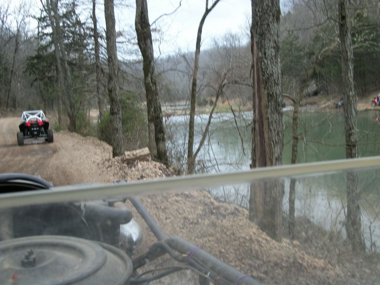

Since I had not had the time to make the TBI swap in ol red, I took the Hillbilly Bug to Rush Springs last weekend. https://www.rushspringsranch.com/ It worked out great and ran like a champ. So well did the Motorcraft 2bbl run I decided to take the nose low problem-matic Edelbrock 4bbl off the red Bronco and swap on a MC2bbl.
FYI the cheap Mr Gasket 2bbl to 4bbl adapter will give you a giant vacuum leak on the back side due to its design. I solved by adding a free Ford EGR plate in between, yea its stacked like a Big Mac, but it runs way better and I did it for cheap.
Taking the Red Bronco back to SMORR, for Howiepalooza 2018 at the end of the month. SMORR ? Southern Missouri Off Road Ranch

ol young ppl's community
'S OK, been 40 yrs...
Kouwell pic, thanks! I luv pic!

Yea I was a little to busy dragging a broke Toyota (front steering link) back to camp and then a Jeep off the top of a 3 foot stump... to take pics. My copilot was distracted by something....to take any good "on the hill" climb pics.
