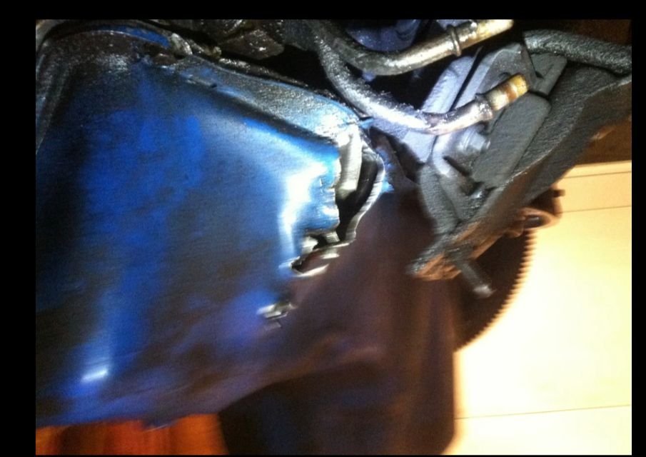

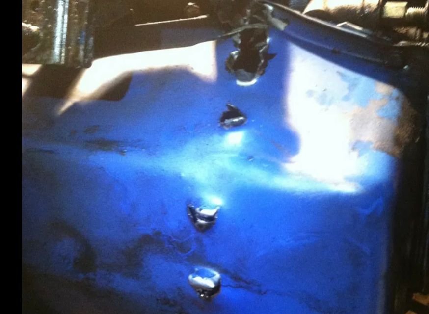

In another abuse of power, anyone who stands in the way of Prius Lover getting a Hypermax bedplate is getting sent to the committee that answers this question:
I've been dying to see someone run one of these bedplates on the street. Let PL have his 100 Knights NOW!
