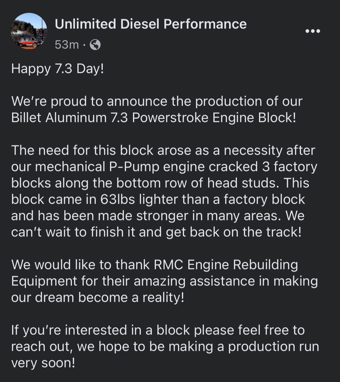

Just thought I’d drop this here. Spotted over in FB world.
New 7.3 aluminum block….
https://fb.watch/lywotbsyja/?mibextid=YCRy0i

I wonder what the price on that aluminum block is. I also wonder if it’s stronger than Hypermax’s.

That is really cool. if they only saved 63 lbs over cast iron it sounds like there is a lot of meat still in there.
I wonder if they are going to wet-sleeve it.
It's made from the magical military grade aluminum billet.....
BILLET? WOAH isn't that like solid aerospace grade alloy?? That must be so strong! Can I get it anodized in fire-engine red?? /s
It's probably dry sleeve... wet sleeve would be incredibly expensive I'd think and require a lot of design changes.
