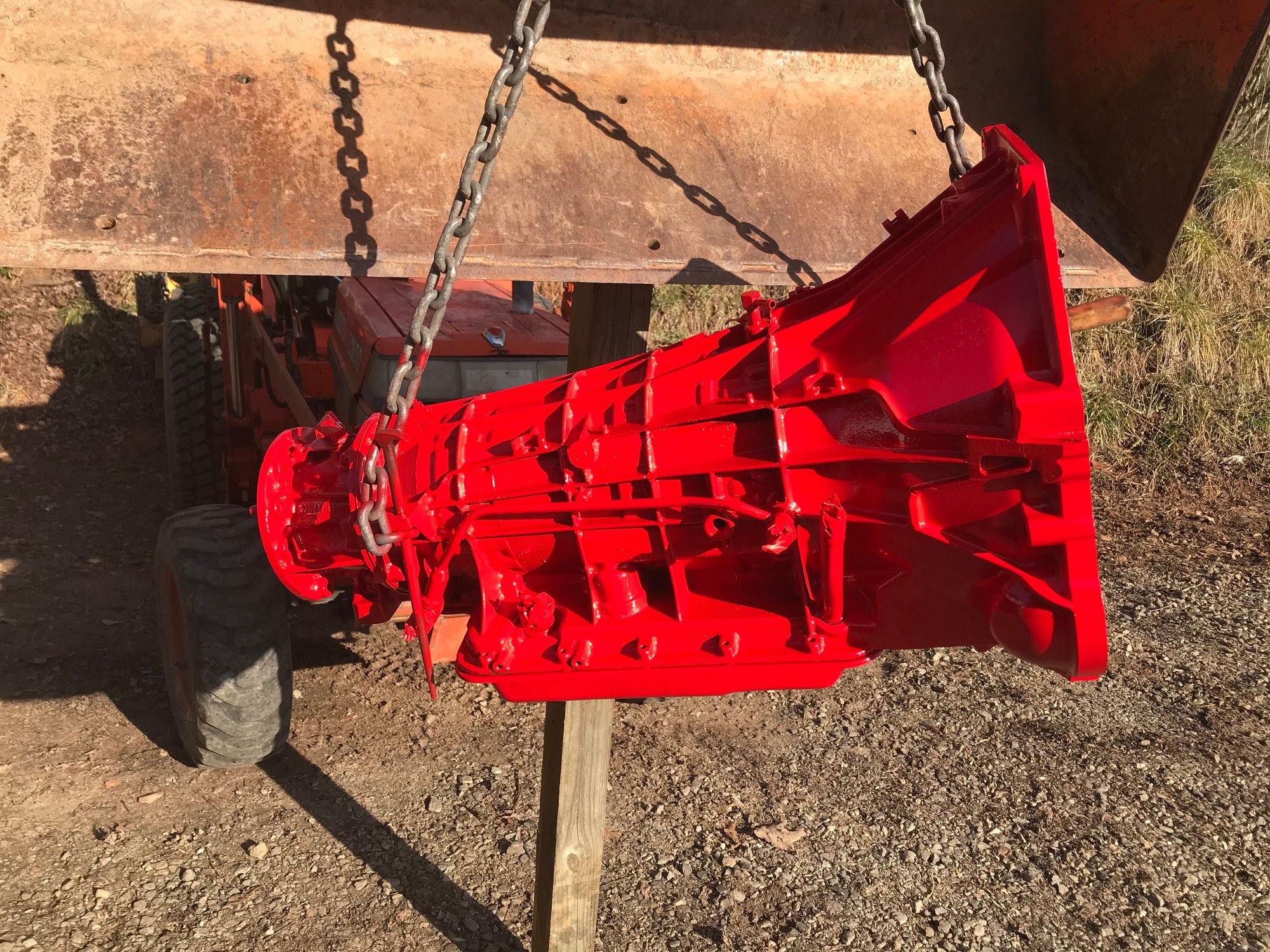

The regular cab truck I have here does not have a carrier bearing. It’s a one-piece driveshaft. As soon as I get the transmission and t-case in, I’ll measure new length and have one of the shafts shortened (donor 4wd or the 2wd).
Here’s the rebuilt 4R100 ready to go in.
Looking good! What did you paint with?

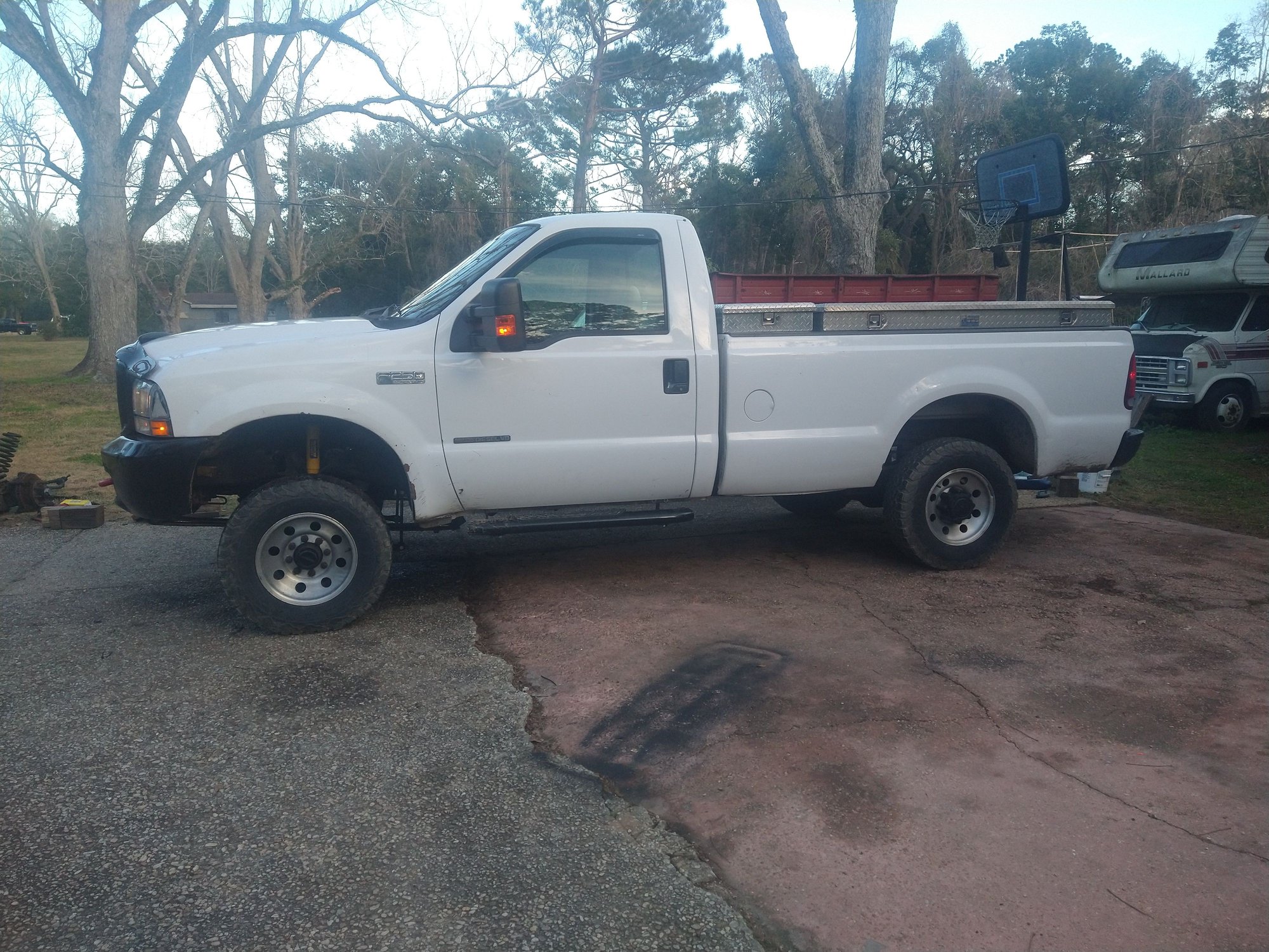

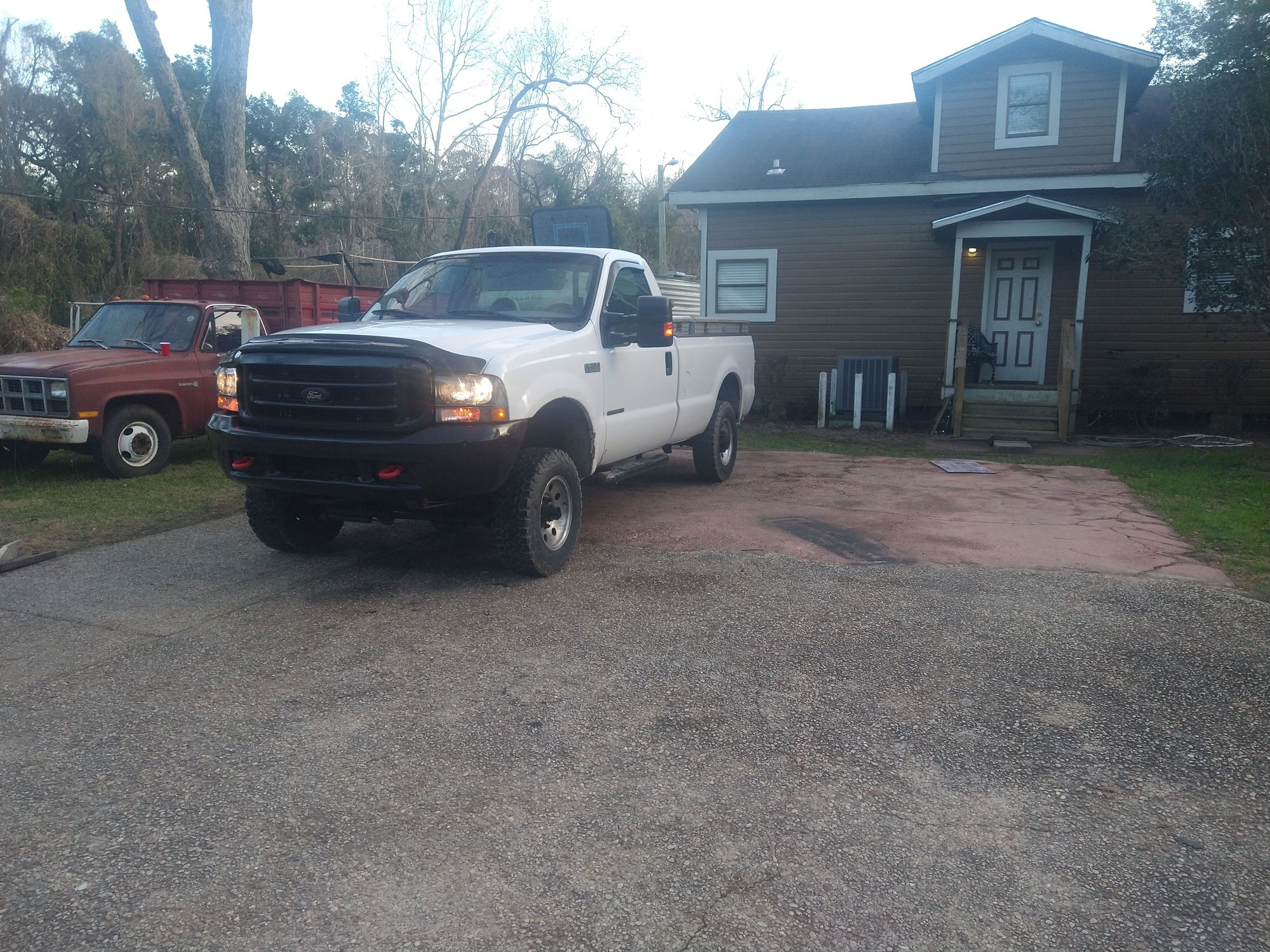

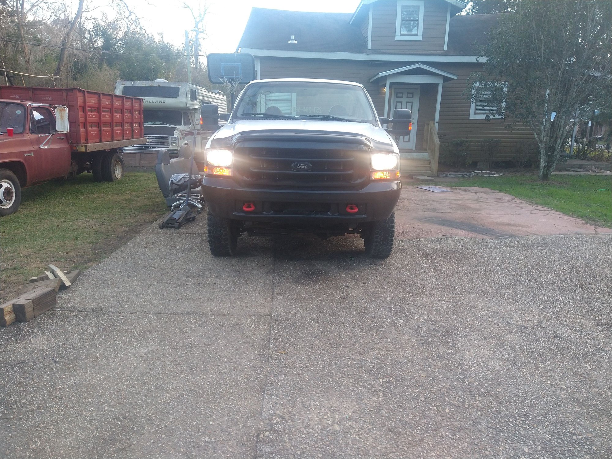

Well, here's the final look of the truck, for now!
