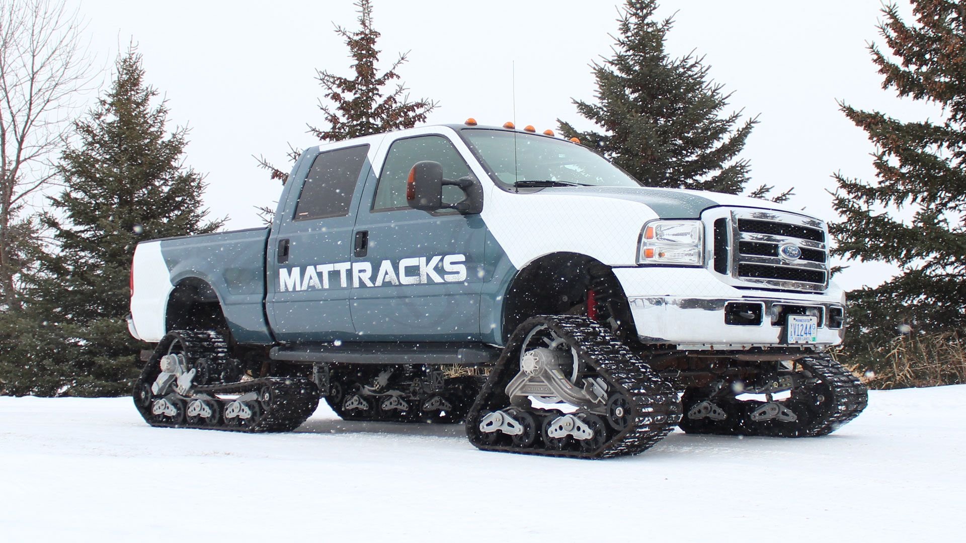

It would be more like this as we don't get that white stuff on the ground much around here. Although, southern Alabama has a lot of mud holes. If you haven't seen some of the videos of the mud rallies/fest in north FL and south AL, they are pretty entertaining.
As bad *** as that is, I can't see it riding on the road very comfortably!
It is very, very cool though! I'd sure enough be a big guy around here then! Putting all these 'New' trucks to shame! No question on who gets better traction!
I wouldn’t know. I’m waiting for somebody to get a set so I can get a ride in a truck equipped with them. I’m looking at you Tristan.
