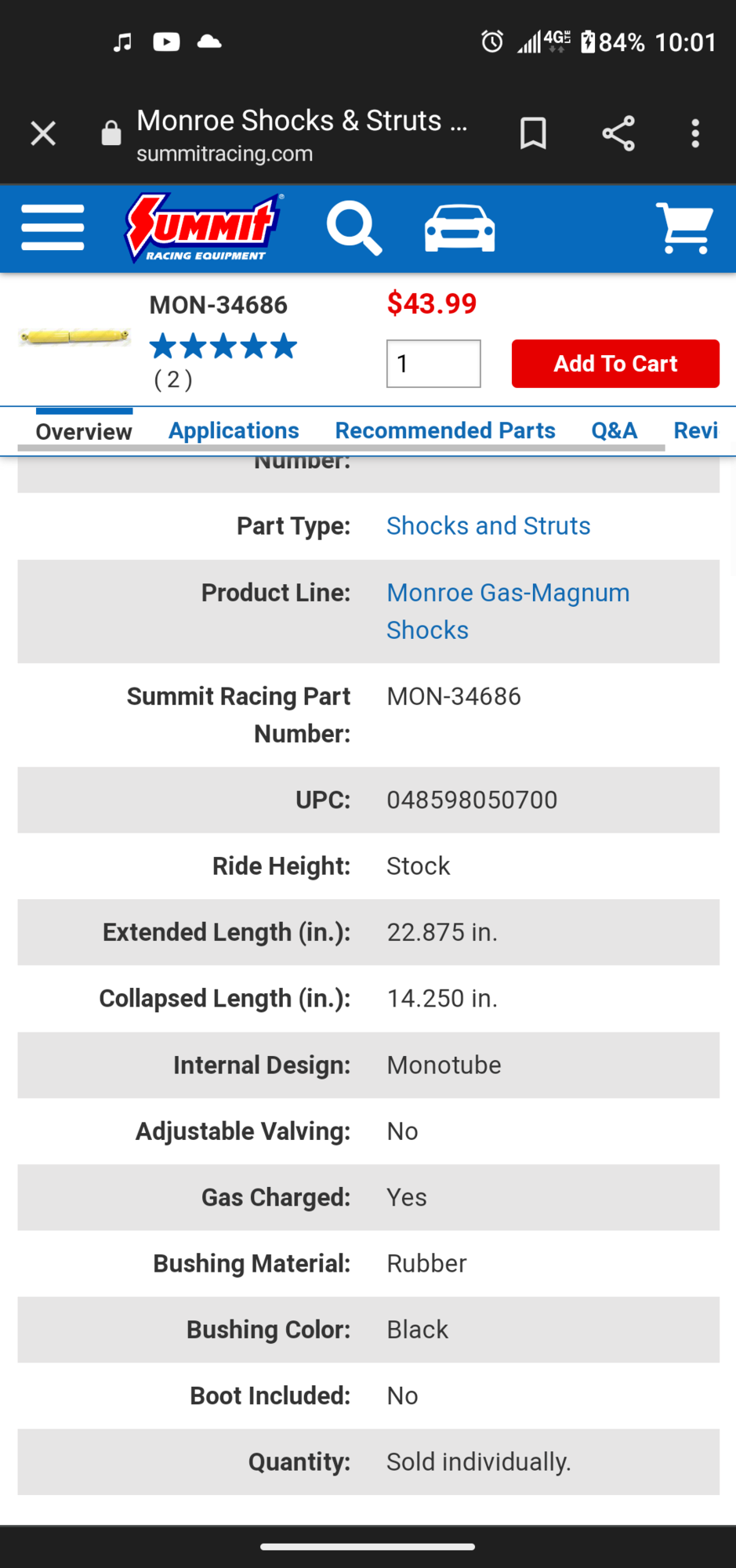

So actually according to summit racing, the shocks on my truck currently(found the part# on the shock) are only supposed to extend to 22.875. they are currently extending to 23 inches plus. So it's safe to assume that they are topping out and are making noise. Now I need to remove the shock and see how far my shock bolts are apart after jacking up the frame. Getting closer!
