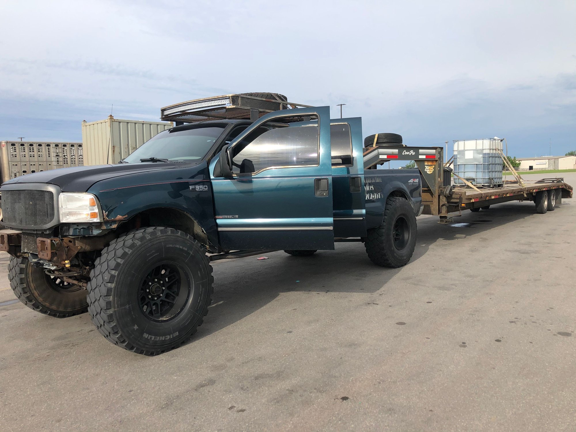

I'm a little confused at what you were getting at about the Hot wheel and the big wheel and little sidewall. That last truck picture above was not my truck. I was just showing that truck for the lift that it had as compared to mine. These are my current wheels and I'm going to get some 285's for it. I hate rubber band tires myself.
this look, you posted
I was only posting that picture to show what a 4-in lift look like compared to my truck. I was trying to figure out if I had a 3-in or a 4-in lift. I hate tires like that. You couldn't pay me to run them on my truck!
Needs more squat??? Lol.
It’s Hot Wheels fault kids like this....
That truck may have a ‘4 inch lift’ in the front and likely stock ‘2” blocks’ in the rear.
I think your lift is slightly less.
Honestly, I’m still in favor of ditching the lift and going to stock 4wd height. Sell the ‘lift kit’ parts and use that $$ to buy what ya need to go to stock.
I think 285’s on stock wheels will look small with that lift. 315/75/16’s (34.5” tall) on an 8-10” wide wheel would look much better, but not toooo wide for stock wheels. The new trucks all have taller tires (albeit less sidewall with bigger wheels...)

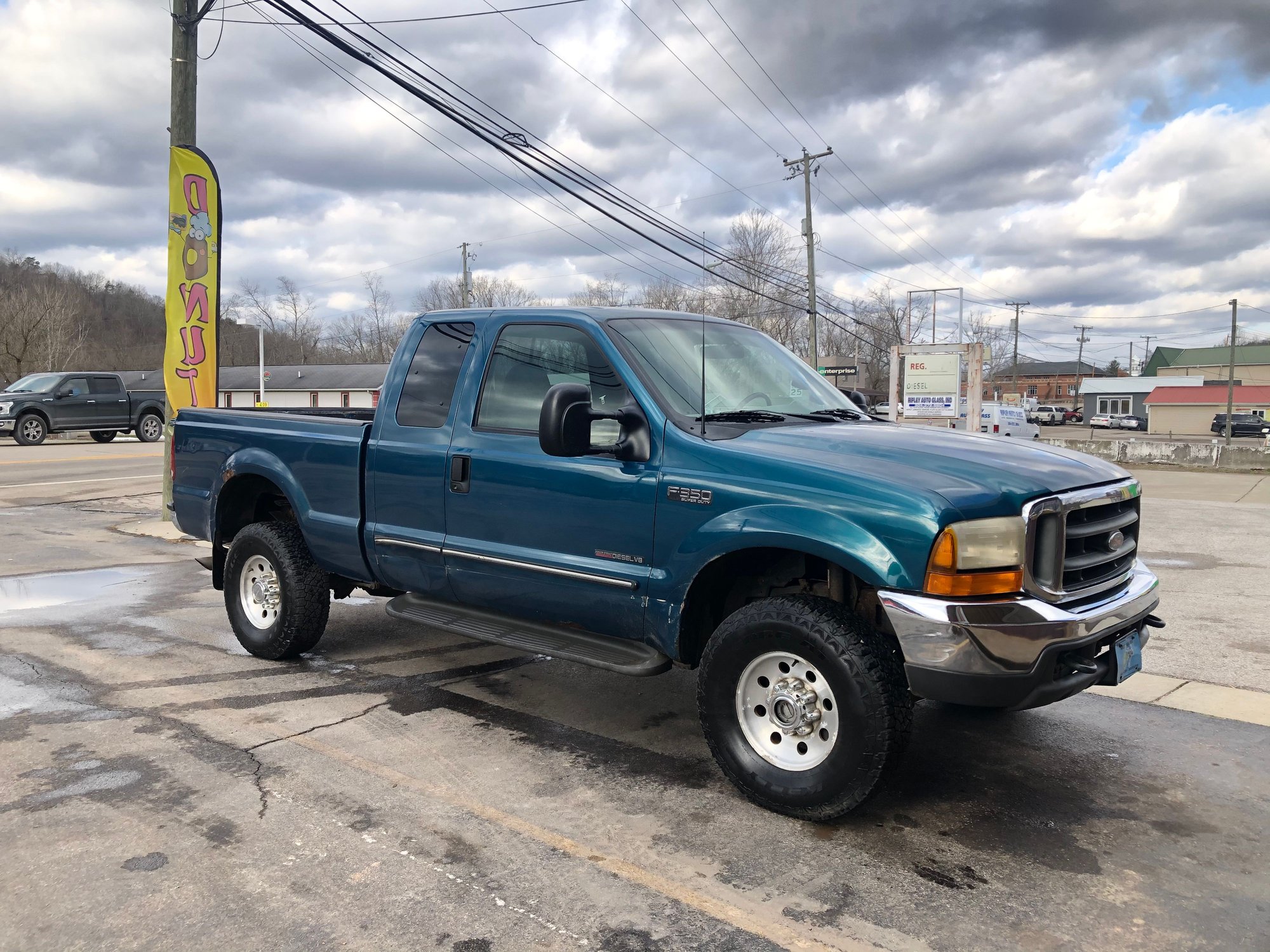

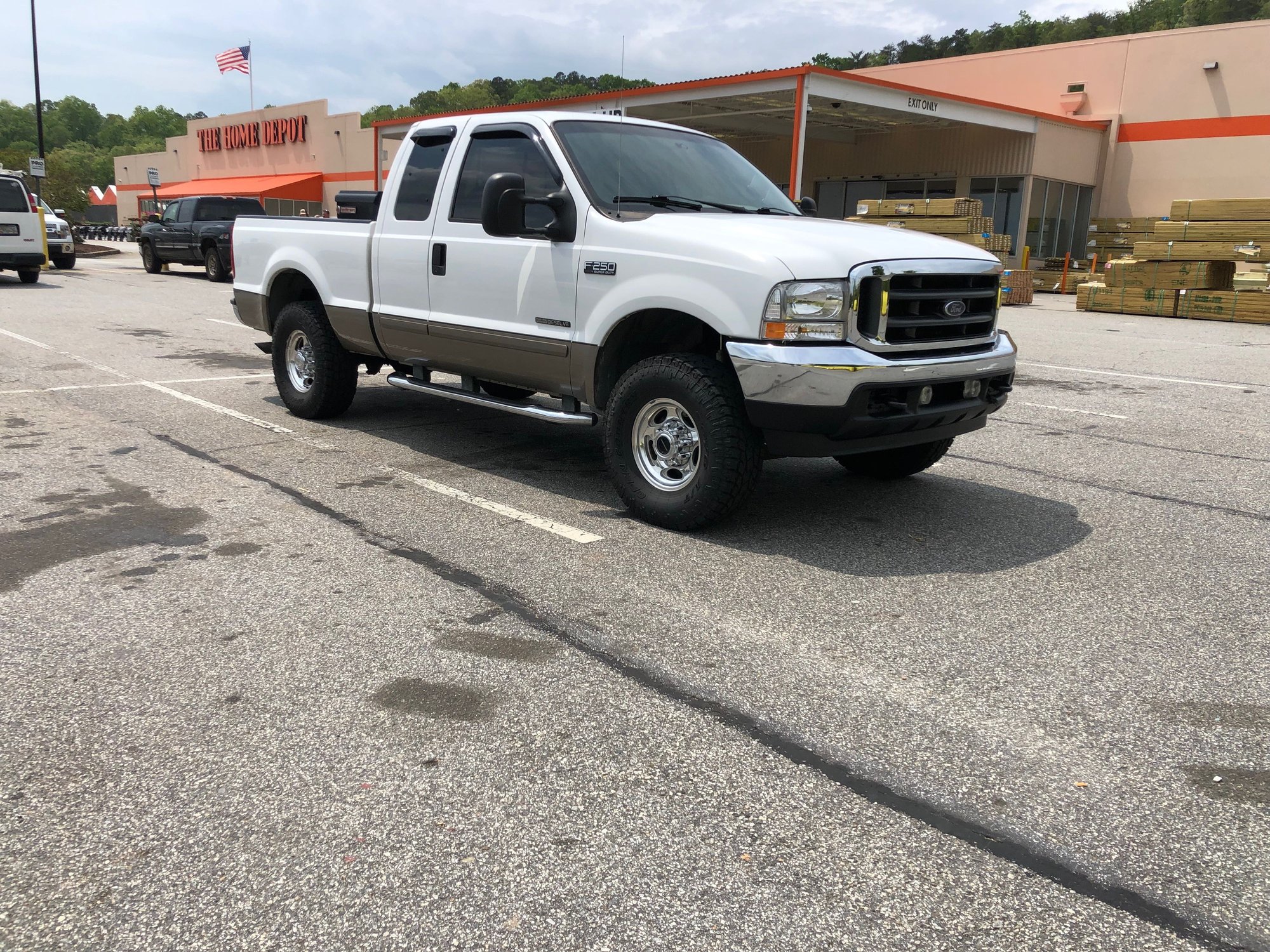

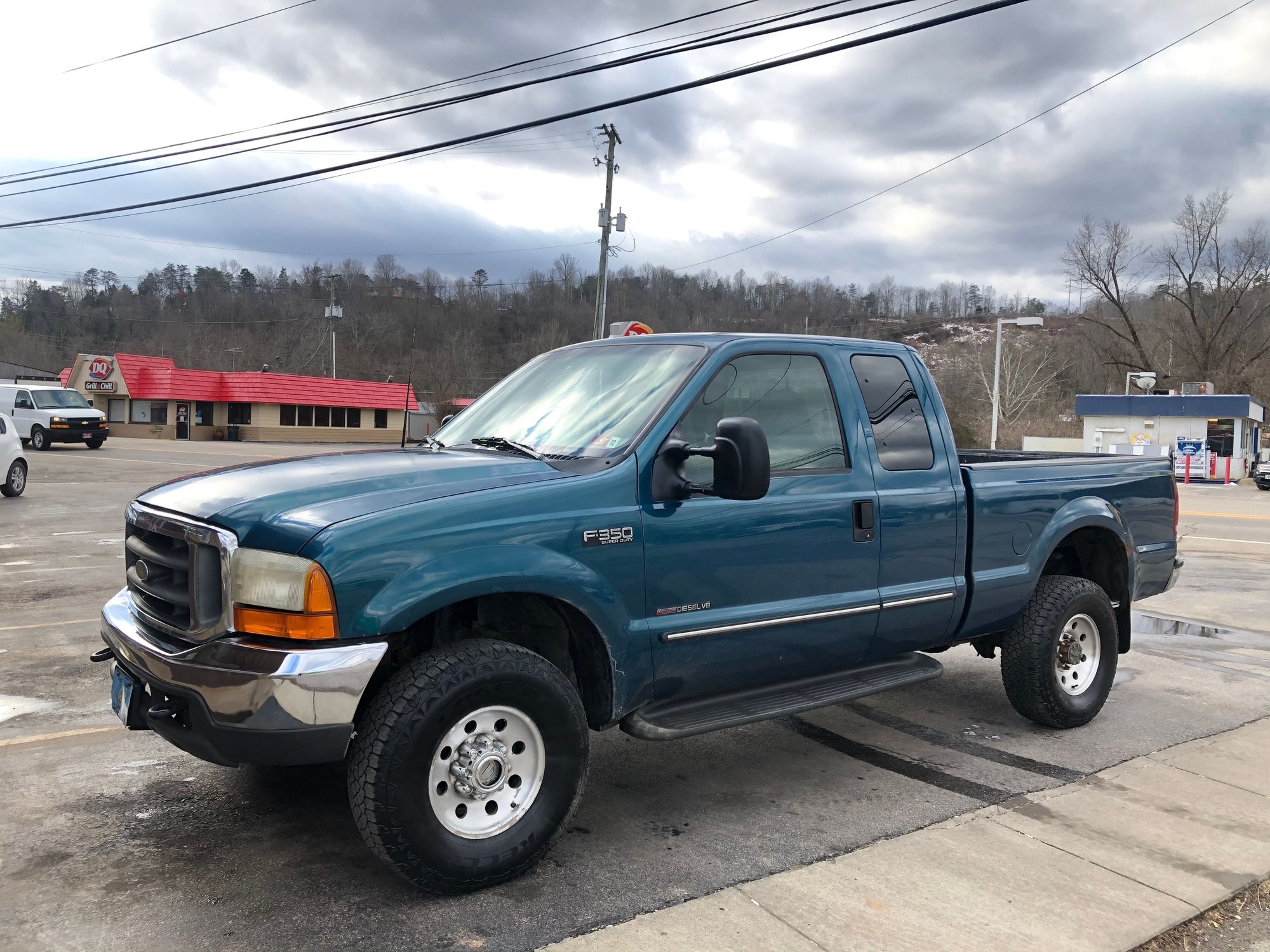

Originally Posted by KubotaOrange76
295s with x springs up front (about 1-1.5" over v codes that were in truck) stock 2" rear blocks(it has 3" now). I agree on 285 too small looking for 3"
X3
I also think 285’s will look too small with a 3” lift. I’m running the 285 with my stock ride height.
I like a tire to fill the well a bit. Of course this is your truck so it’s up to you. We’re just trying to help you think of all the possibilities before dropping the money.

X3
Some photos of the 285’s on my F250 and dad’s F350.
I have to agree that that looks great on the stock height truck. I just don't want to rub the leaf springs. I like the lifted look but, don't know how I would fit 315's without rubbing the springs. I have a buddy selling a brand new set of 315's with rim and tire for 1200$. His truck was totaled and he doesn't need them on his new truck. But what could I do to avoid rubbing? I don't want tire spacers. I hate the way tires that stick out the side of the truck look.
