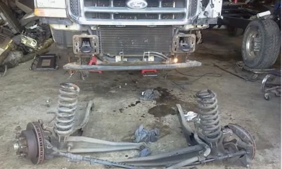

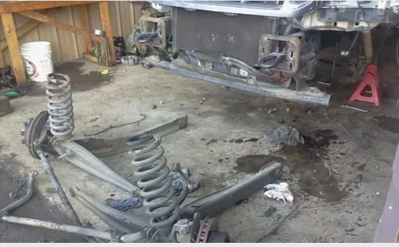

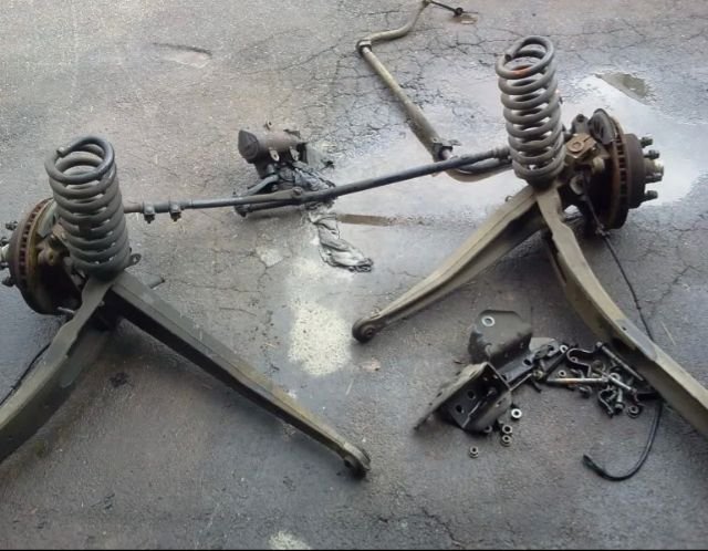

The hardest part is removing the rivets for the coil buckets. The fastest way is plasma cutter or oxy/acetylene, but skill is required to not cut your frame. Some people like to use a cutoff wheel and cut a cross in each rivet, then use air chisel to finish removing heads. A 7in angle grinder and aggressive wheel makes short work too.
You’ll remove shocks and sway bar, unbolt the radius arms from frame brackets and the I-beam bolts and that whole assembly comes out in one piece. It comes out fast.
Seems easy enough. Only thing that looks / sounds annoying are those giant rivets. I have a 4-in grinder. I've been meaning to pick up an air chisel anyway. I'll make do somehow.
