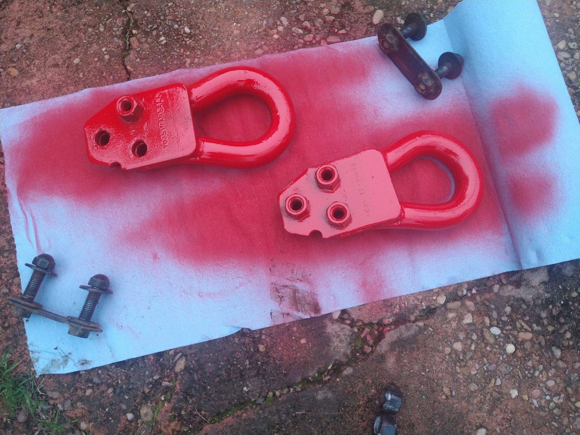

I finally got my tow hooks off. They didn't look all that Rusty butt, the impact broke the welds that held the nuts on top. I had to get a wrench and put on top and use a breaker bar all the way out. I had penetrating oil on the threads and you could tell when it started lubricating. When it started lubricating the bolt started jumping when you got it to spin it almost sounded like my ratchet was breaking. It was hard all the way out. But I got them off. Now I'm going to wire a wheel all the threads and spray the crap out of it with lube and put it back on. It'll be ready to come off when it needs to.
Before putting them back on, and most importantly....
