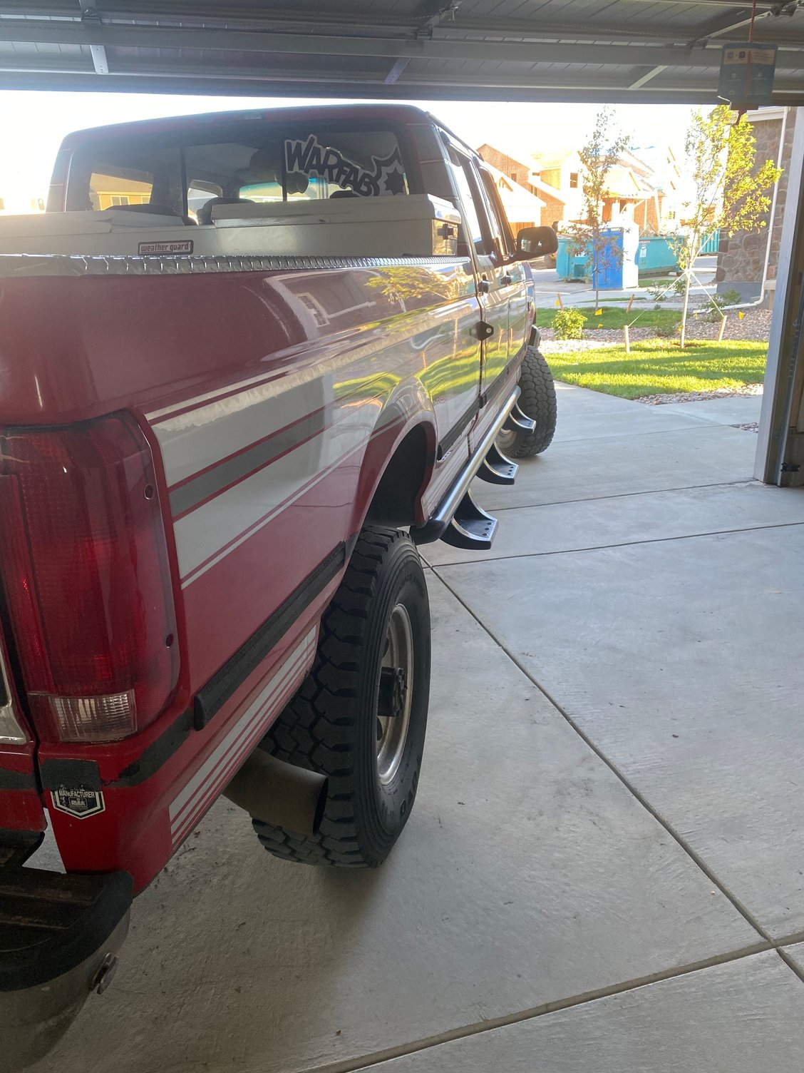

I’ve seen a bunch of OBS trucks with rotten fenders in the last few days so I got paranoid that that was the reason the PO put these flares on. Took the 5 mins to unscrew them and I am in luck! No rust! Just a couple spots where the flare rubbed the paint down to bare metal, so I’ll pick up some touch up paint. Never was a fan of them anyways

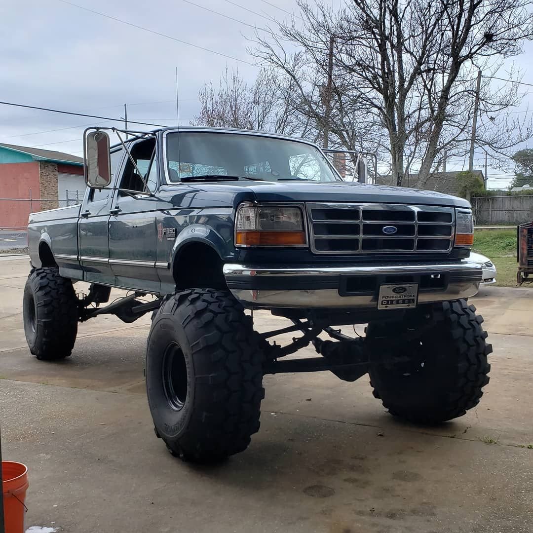

I have a set of “west coast” mirrors in the garage that I trimmed the mounts on. After the trimming it should be a good mix between a super wide tow mirror and the tiny factory mirrors. Just gotta fab up an aluminum plate and rubber spacer to go against the door. These factory mirrors have a big rectangular hole that the electric adjuster arm goes through that would just be a big gap with the mounts that come with the mirrors. Pulled this pic from the internet but it’s these mirrors and should sit about 4” closer to the body

I put some west coasts similar to that on mine. World of difference. Throw some adjustable blind spot mirrors on em and they’re perfect
