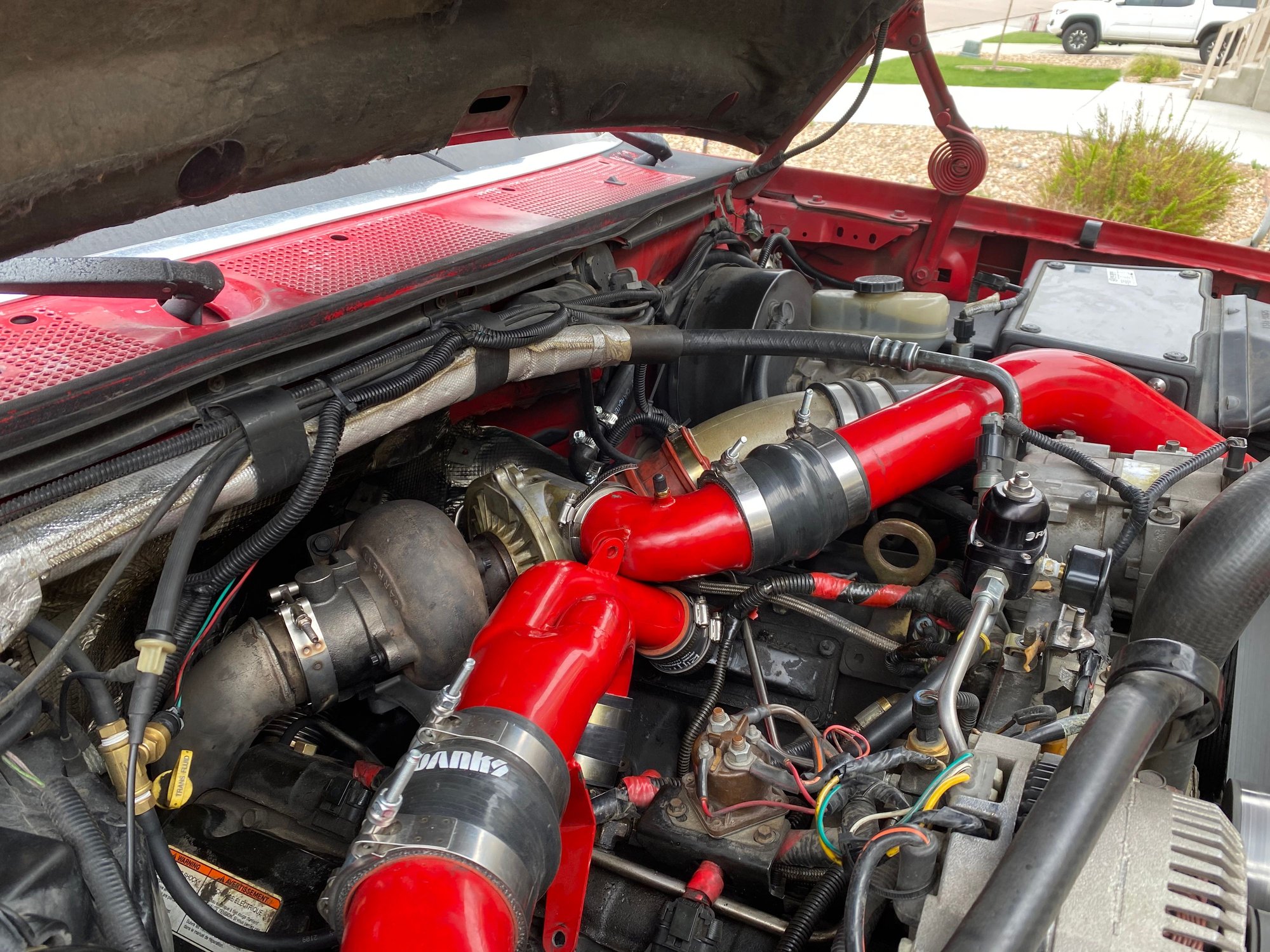

Wow, spent a couple hours fighting and mutilating the up pipe with a sawzall this morning to get it out. Picked up the porta power around 3, and had the new up pipe in place in about 30 seconds. I can’t believe I haven’t seen people talk about using one for this install. Everyone seems to pull the trans instead. Either way, I didn’t read instructions or write ups and tightened the up pipe collector to the pipes and the pipes to the manifold, so now the collector won’t meet the turbo at all. That’s tomorrow Noah’s problem. Should be able to loosen those bolts, and slap everything back together tomorrow morning.
Also got the new fitting drilled, tapped, and jb welded into the radiator. So that will be set up and ready by the time I’m done. I don’t want to jinx it, but I am so excited to have non leaky up pipes and a turbo without play.

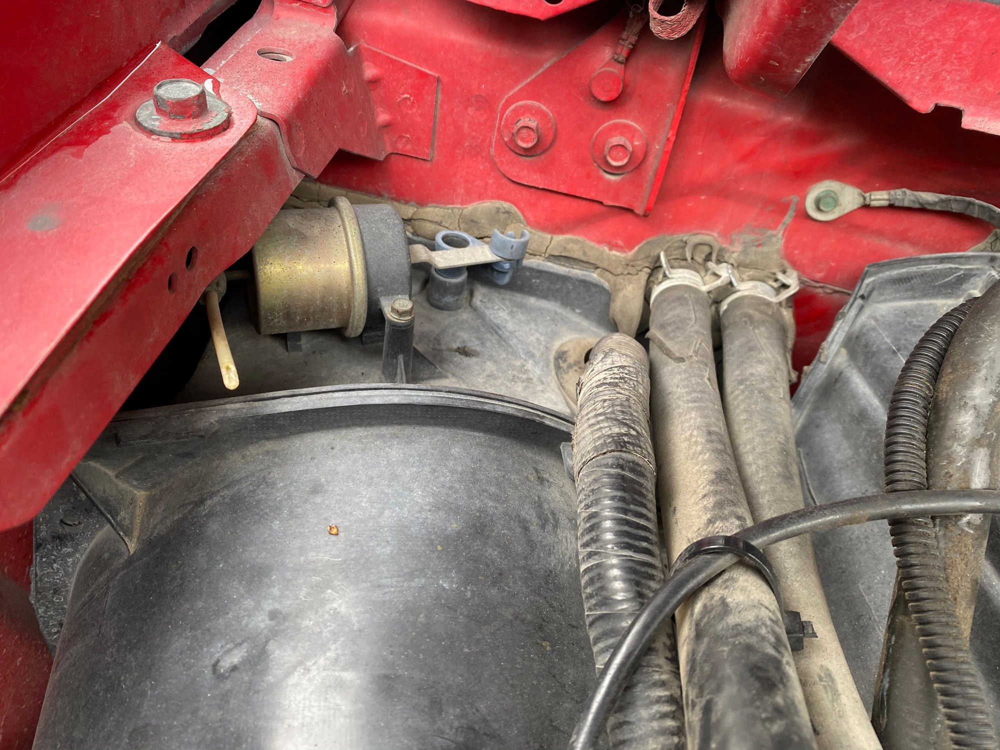

Also, anyone know what this is? Never noticed that it does not appear to be attached to anything

If you are lookin at the broken white hose, it is a vacuum line for the heater blend door. The other end should be there someplace, maybe the hose zip tied to the heater hose?

yep that’s what I was looking at! Thank you! Time to do a little research on that

Why is your turbo crooked? The cool ones are all mounted straight, parallel to the valve covers.
I have a random black vacuum box connect to that line and then to the pump.

turbo is crooked because I am one of the poors. Haha I might eventually go to the better set up, but for now I just wanted to spend a little to refresh what I have. Everything went back together and I went to start it up and it just cranked and cranked. Had my roommate pull his duramax up and jump me, I guess it didn’t like sitting for a week and a half. Truck is running well but I have a boost leak at the turbo outlet flange. I need to fiddle with my intake spider and get a new v clamp for the connection. Doesn’t appear to be leaking until about 10psi so I will solve this problem next weekend. The truck doesn’t really ever see that much boost when I’m just driving to and from work.
While I was in there, I flipped the dog house around and gave it some new o rings. Did the CCV mod so next time I have it all apart I shouldn’t have to clean up nearly as much oil.

I've thought about doing the ccv mod. I'm interested to see how you like it.
That is a sweet looking engine bay!

Thank you! I was going to add a catch can instead of just venting to the atmosphere, but I realized the catch can I have laying around has 1/2” fittings instead of 3/4” and I didn’t want to reduce the flow that much. Should make messing with the intercooler pipes nicer since they won’t be covered in oil.
