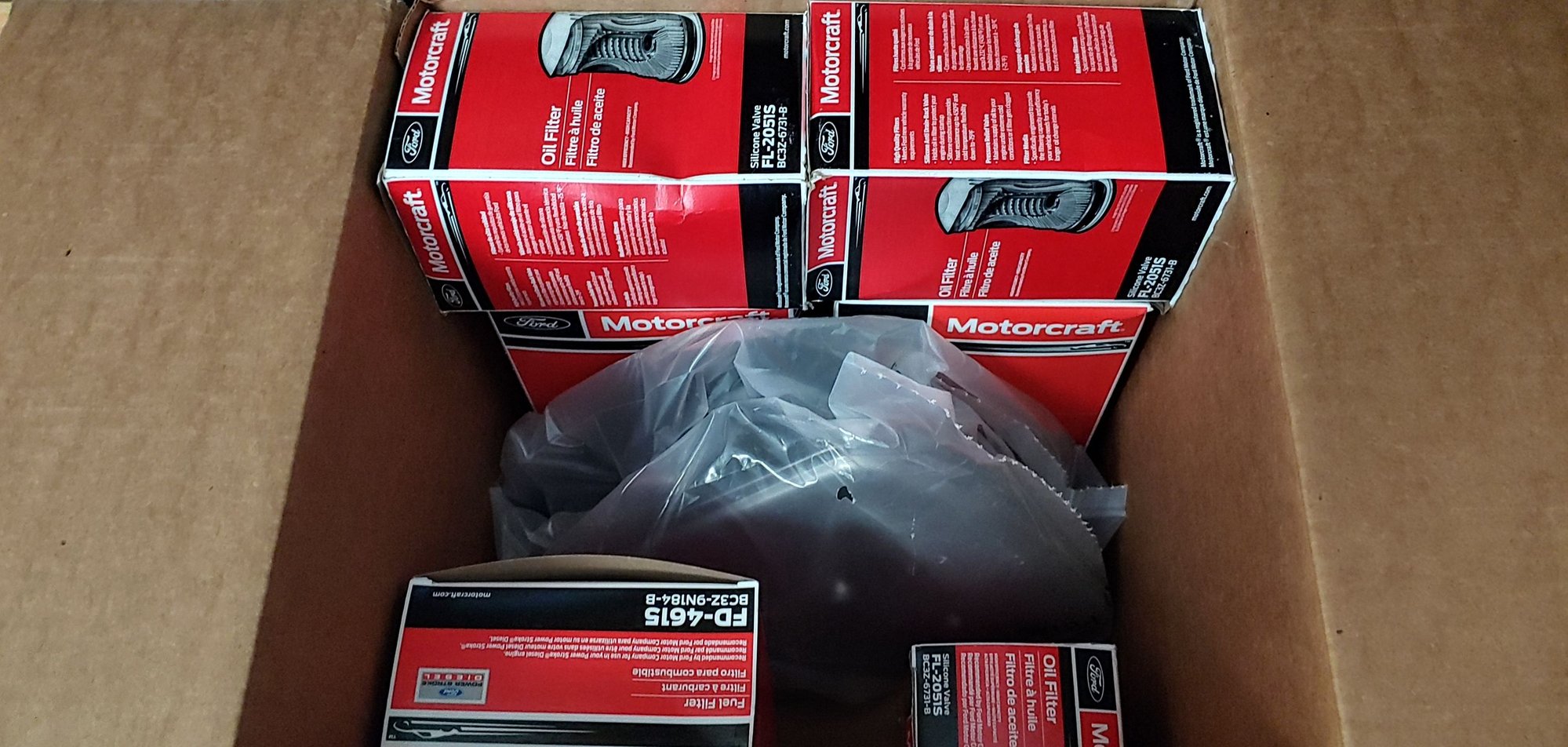

I ordered some supplies from Dieselfiltersonline. Here's what I got...
The goody box...

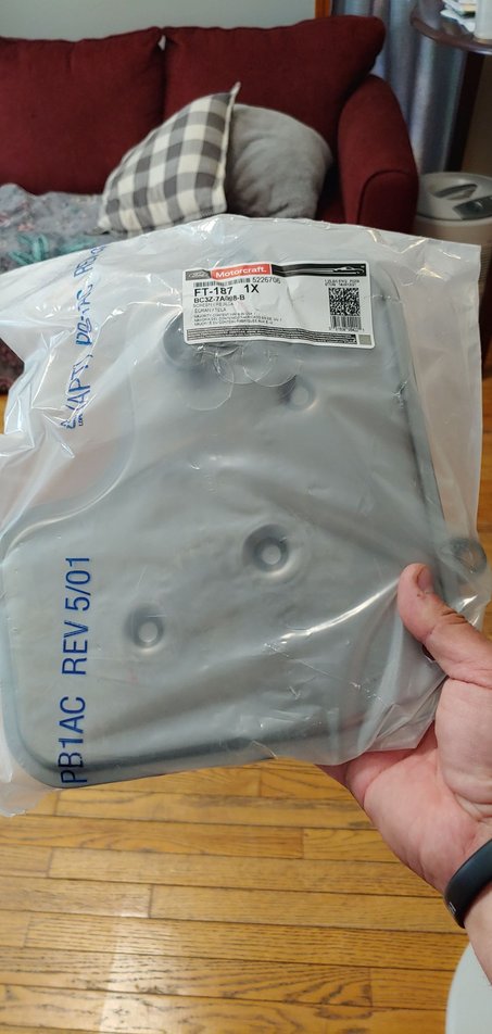

I bought 2 6R140 trans filters which the current one will be replaced in about 12k miles at 90k miles. Then I'll be good for another 60k miles.
3 oil filters for another 21k miles or so. I took a sample of this last oil change I did. Going to send out Blackstone and post here when I get the UOA report.
My last Motorcraft filter i had left...

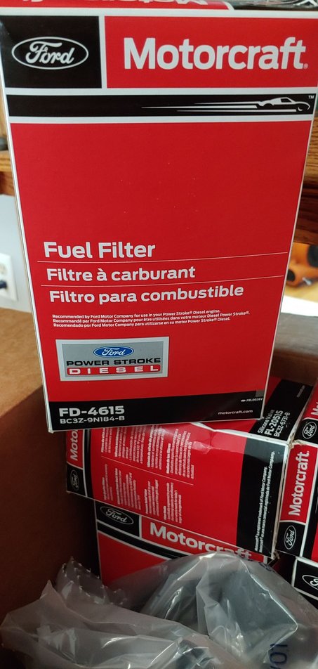

Three Fuel filter sets good for another 66k miles.
I let the truck tell me when to change the filters. I'll have to look up the mileage when they were last changed and post up.

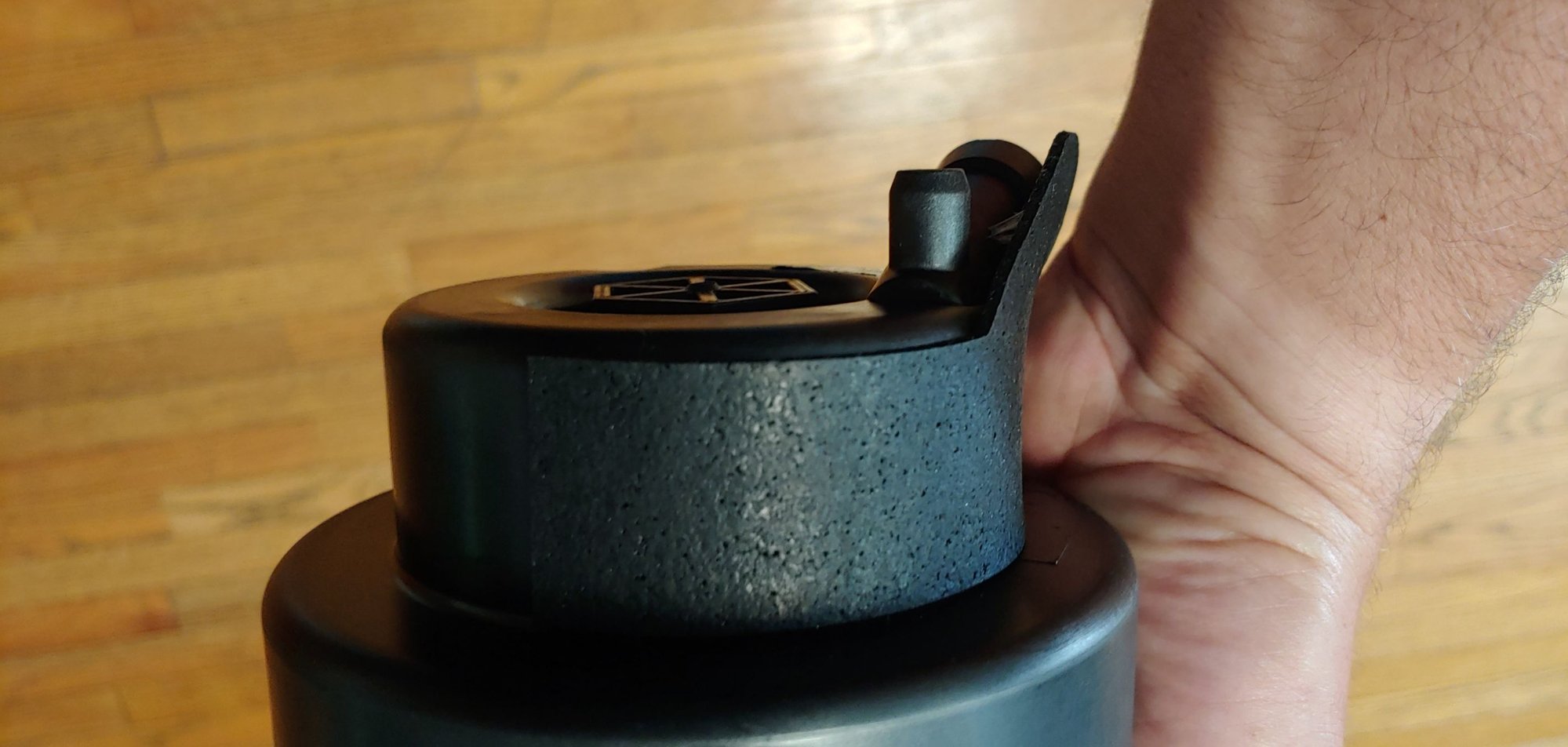

Do not forget to pull off the old o-ring and use the one provided with the kit.
Remember to use oil on the o-ring and housing threads. The cap turns on easily then. Be careful when you get to the end or you'll snap off the stop off the cap and housing.
I am talking about this stop...

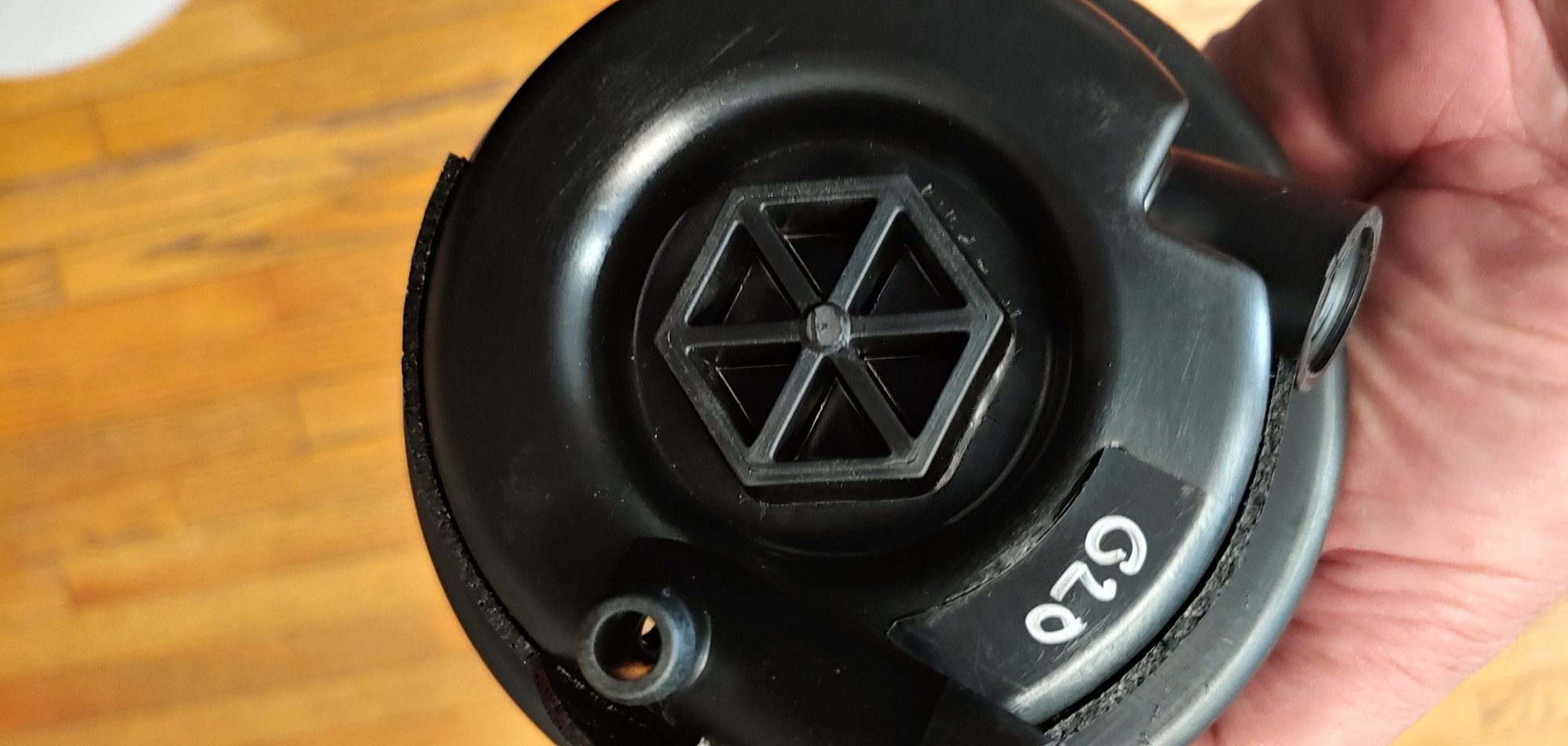

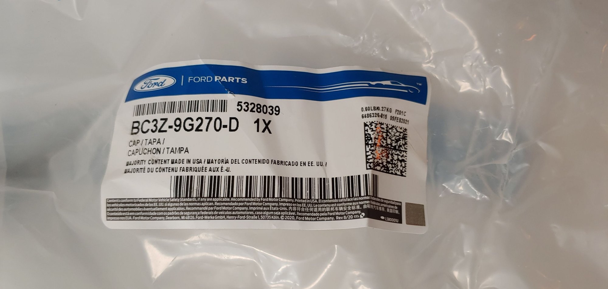

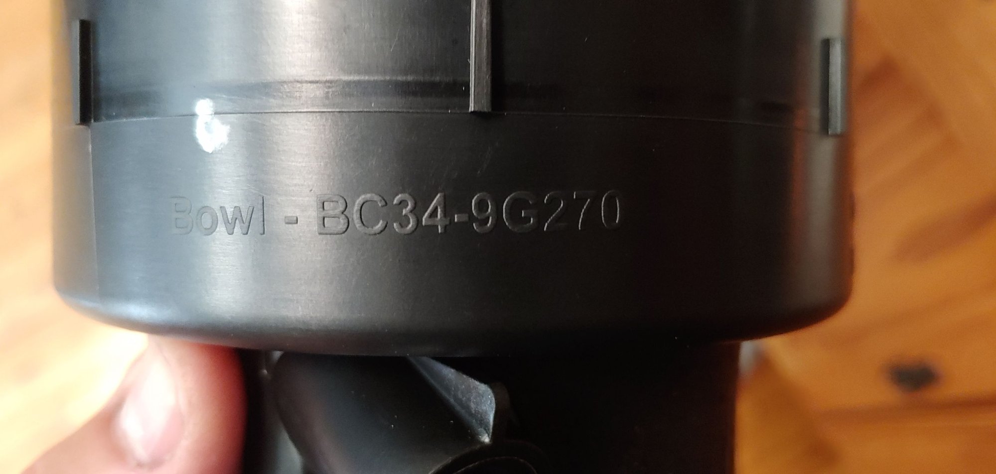

Finally bought an extra cap for the DFCM.

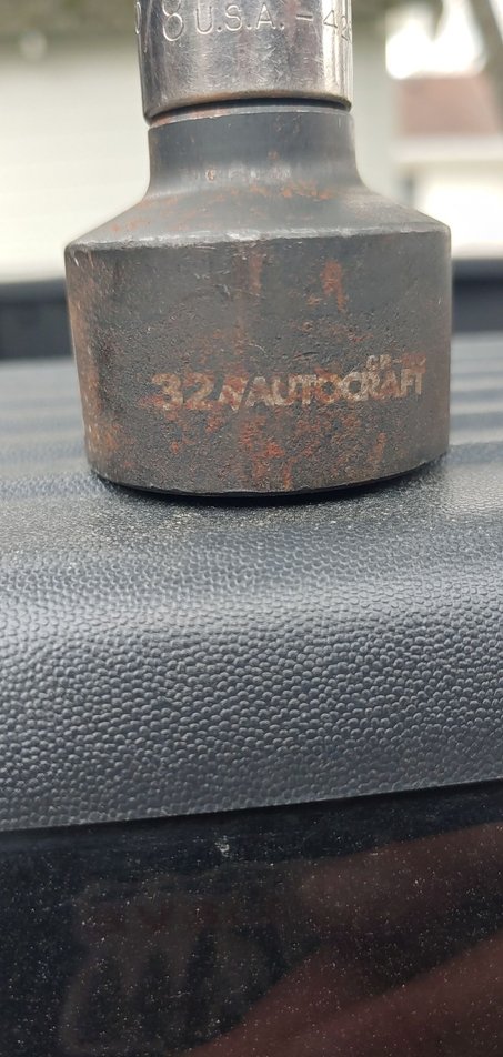

The 32mm nut on the bottom.
The socket i use.
The new cap had a non slip piece of material on it that my OEM one does not have... Unless it came off at one point. But i do not remember one though.

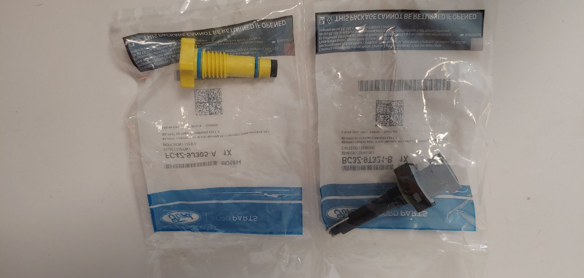

These were cheap enough to buy and have extras. The valve drain and the WIF sensor.
The first time i did this but think its a good idea for sure.

Thanks for posting part #'s Dave, I need to order a fuel bowl & parts for mine
