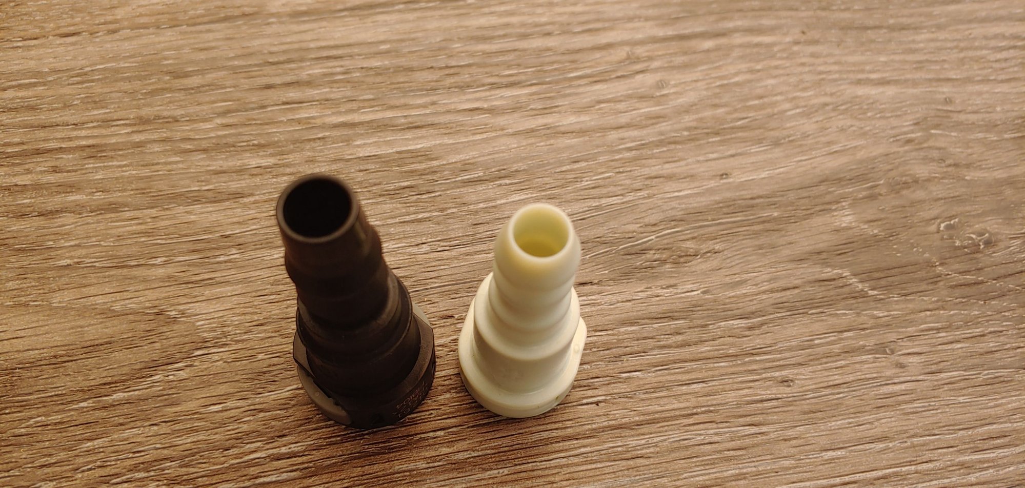

Parts for Air Dog install
I sourced two quick connect fittings locally from a hydraulic supply store that are Dorman parts (part 800-111), 1/2 inch quick connect x 1/2 inch push lock, for the tie in to the factory return line from the DFCM.
I was concerned about the slight difference in the inner diameter of the fitting supplied by Airdog and the Dorman fitting.
But when i compared it to the return fitting 1/2 inch inner diameter, it's bigger than the tee inner diameter. This is for the return and not the supply line. I'm not worried now.

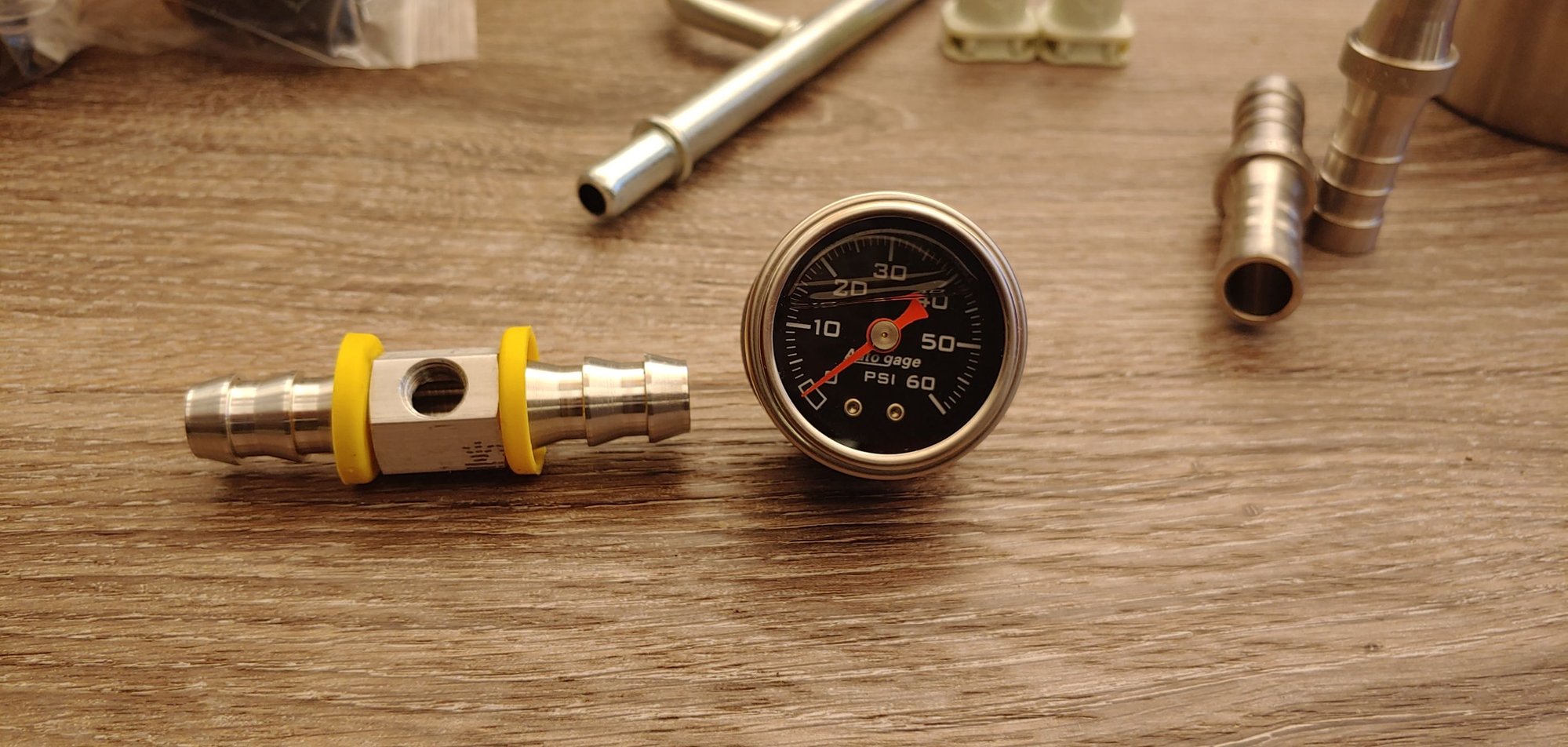

Here's the mechanical fuel pressure gauge and 1/2 inch fitting with 1/8 inch NPT port for the gauge I got from Summit Racing. This way i can adjust the fuel pressure down to 10 psi to feed the DFCM. I've decided to get two extra 1/2 female quick connect × 1/2 inch push lock nylon fittings from either Airdog or another website I found, vulcanperformance.com Which ever is the cheapest.
I am going to use the line I make with the fuel pressure gauge to set up the fuel pressure correctly, then remove it and replace it with a solid line with those two extra fittings I buy. This way the fuel gauge won't be screwed up by the salt in winter time. I only need that line to set my pressure to 10 PSI. Then I'll have it if I ever need it to trouble shoot the pump pressure.

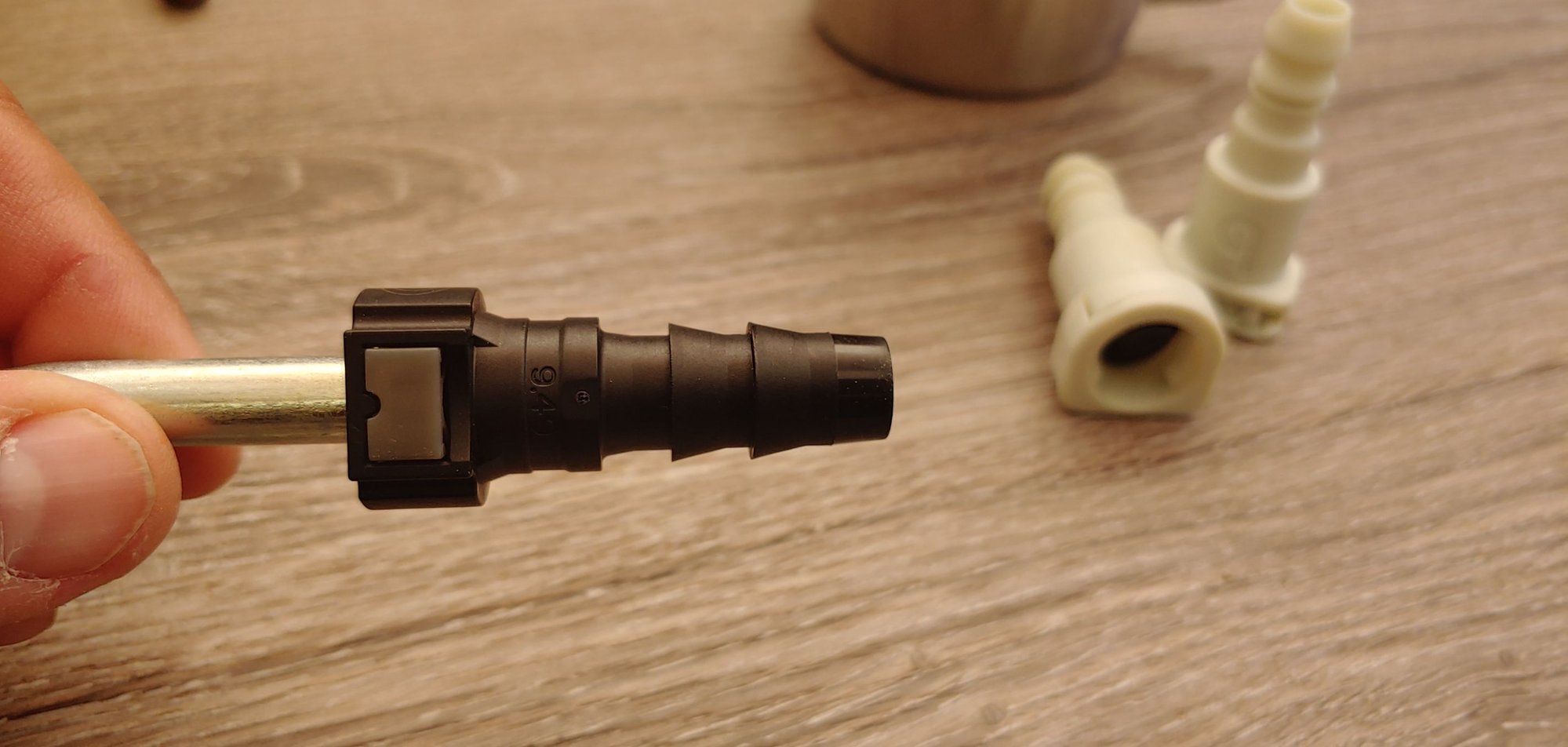

This is the 3/8 inch straight female quick connect x 1/2 inch push lock nylon fitting that I want to get a second one. This is on the tee fitting that Airdog provides with the kit. This connects the 3/8 inch air/vapor line from the Airdog to the return line back to the tank.
They provide a 90 degree one but it will be a short straight one from the Airdog, so i want a second straight fitting to use the least amount of hose possible.
One more shot of the Dorman fittings to be used on the return line. Button to unlock fitting is seen on top.

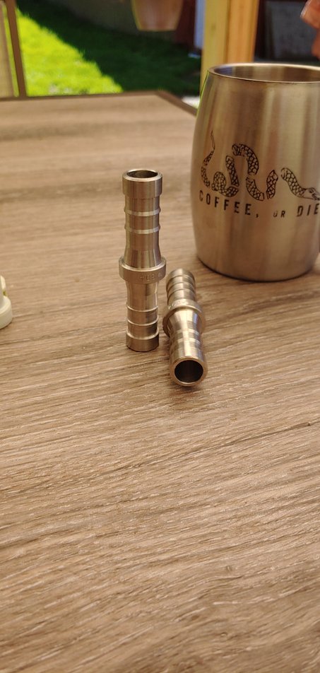

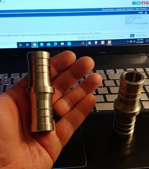

Originally Posted by Overkill2
I now have the one inch hose menders for my Mishimoto oil catch can hoses to extend them so I can mount the S&S DPK filter in it's place. They are made out of stainless steel and are rated for 350 degrees F. They are heavy duty as hell. They should be for the cost of them.
Just have to find a suitable hose to use...
I don't know what I was thinking when I thought those fittings on the oil catch can were 1 inch ID. They are not. They are 5/8 inch. I got new ones... 5/8 inch ID. The return policy is simple and easy for McMaster.com just ship them back with a copy of invoice and they will refund the money. They are going back next week. Doh...
The correct sized hose menders... To move oil can over so the old mounting spot is clear for the S&S DPK kit. 5/8 inch 304 stainless steel.
