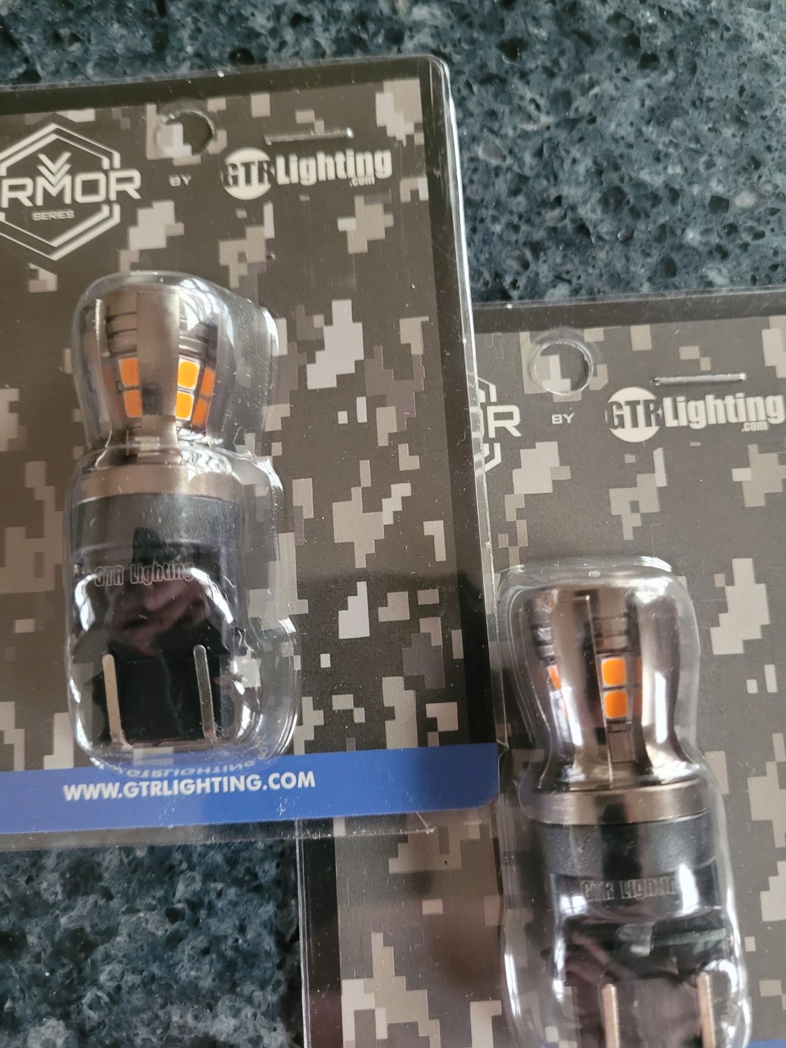

Look how cool the turn lights look. These are also very nice.

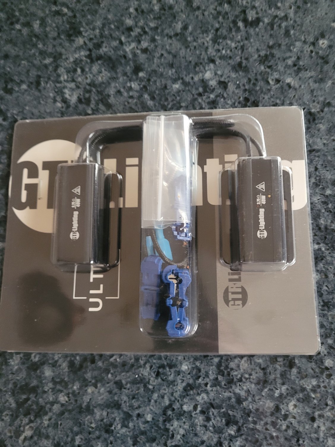

These are the resistors that you need for the turn signal I used my prob in the socket to see which wire to hook up. I didn't have to strip all 3 wires.

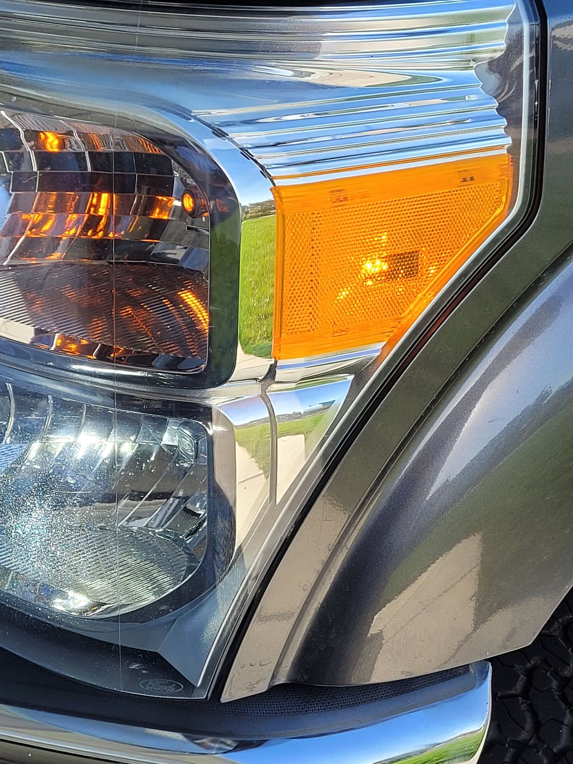

This is the turn light in the running light mode
The side marker light is alive. These were taken in the daytime.
It looks like I need to replace the light assembly I am not sure why the bottom looks so pitted but it's not over the entire lens. Next month the stop light backup get changed. I was looking at fog lights and Man those are expensive. I am considering just changing the bulb. I use my lights all the time. I have yet to drive my truck at night LOL.

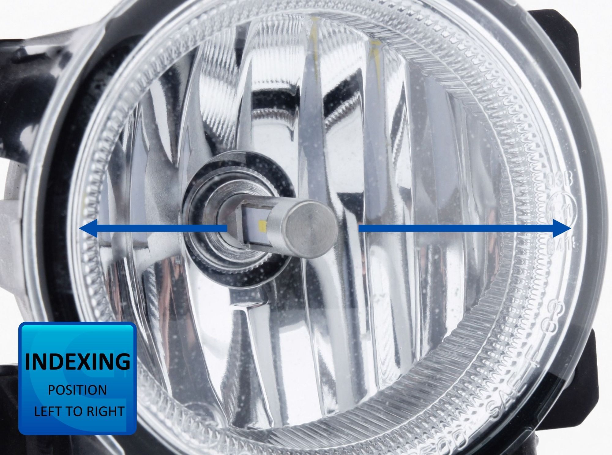

Make sure those Ultra 2s are clocked correctly...if you haven't. The bulbs have to be completely vertical, meaning the LEDs centered in order for them to function like a halogen bulb. If not, they will not have a correct beam pattern and will throw out light incorrectly resulting in a lot of glare.
From VLEDs website:
There should be no angle, meaning the LEDs should not be angled up and down...

As to those GTR 3157 bulbs, those do look slick. I just don't like that you have to splice the bulb wires to add the resistors. That's why I went with the VLEDs which have the plug in resistors. But of course, the VLEDs are more expensive.
