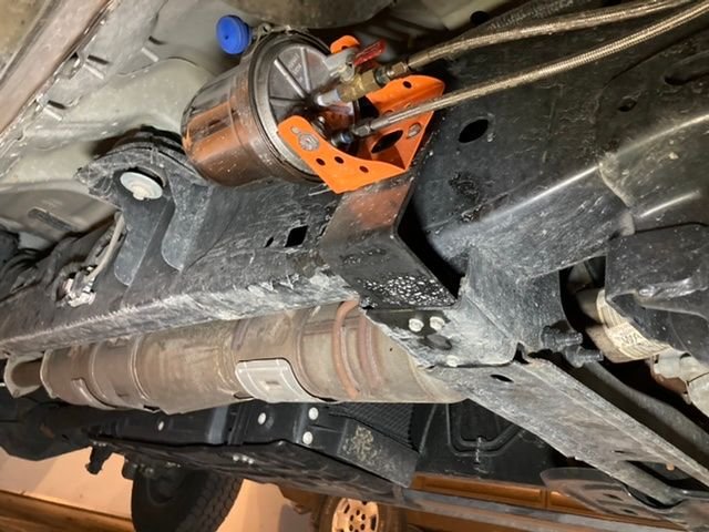

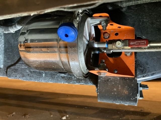

@Overkill2 here's some pics of my bypass filter

A oil bypass filter that uses TP
So Jolly and I were PMing back and forth on a few things. Then it got to his bypass filter. Since he couldn't send pics on the messaging system, I told him to post up here on my thread. The filter is from here:
https://www.toiletpaperoilfilter.com...ercompany.html
I'm almost brain storming the idea of modifying this set up to use with the lines and oil return oil fill cap I have with my FS2500. Hmmm...
Thanks for the pics, Jolly.

Exclamation STRAP THAT VALVE HANDLE!
That valve handle has a moment arm, is subject to gravity and exists in a high vibration environment. What's the worst that could happen?
Universal Law of the Universe: "Intended consequences may or may not occur but unintended consequences always occur."
I assume you're referring to my pictures? I think it's pretty low risk but I could slip a zip tie or some velcro on it. The valve is pretty tight and the handle takes some force to move. It's a bypass filter, so if the valve closed, nothing bad would happen.
