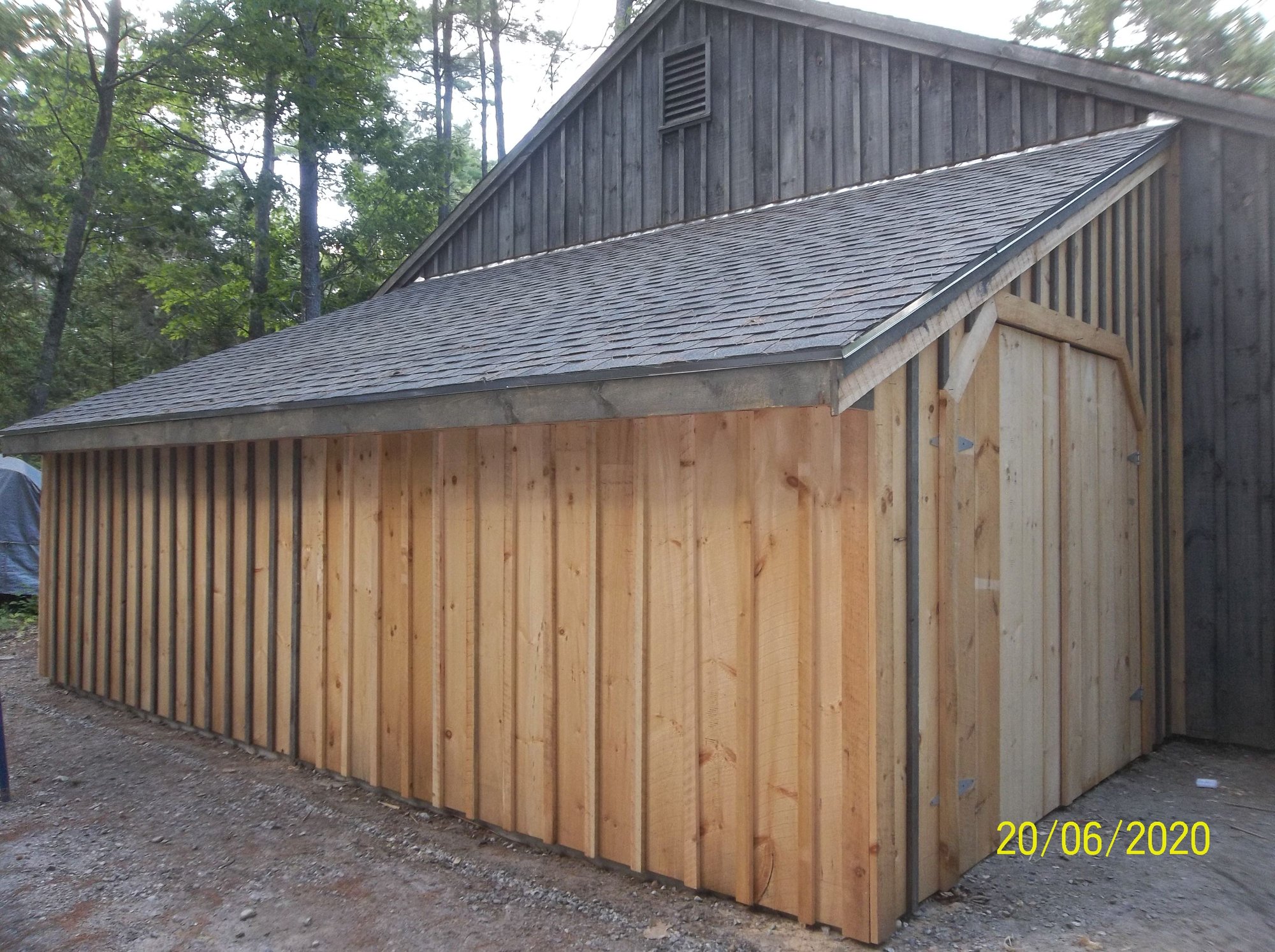

I did a 12 X 24 addition to my barn last summer before prices took off. I did all of the work myself except the offload and polishing of the concrete, btdt not doing that any more. All of my framing and the exterior board and baton was native lumber. The final cost was just over $6K, or about $21/sq. ft. As an example, the 7/16 OSB, (OSB painted white is the interior surface rather than sheet rock) in late July cost $12/sheet. Last I looked it was $30/sheet.
Picture was before staining. The total price was everything including final staining. It is the new "home" for Willard, my 49.

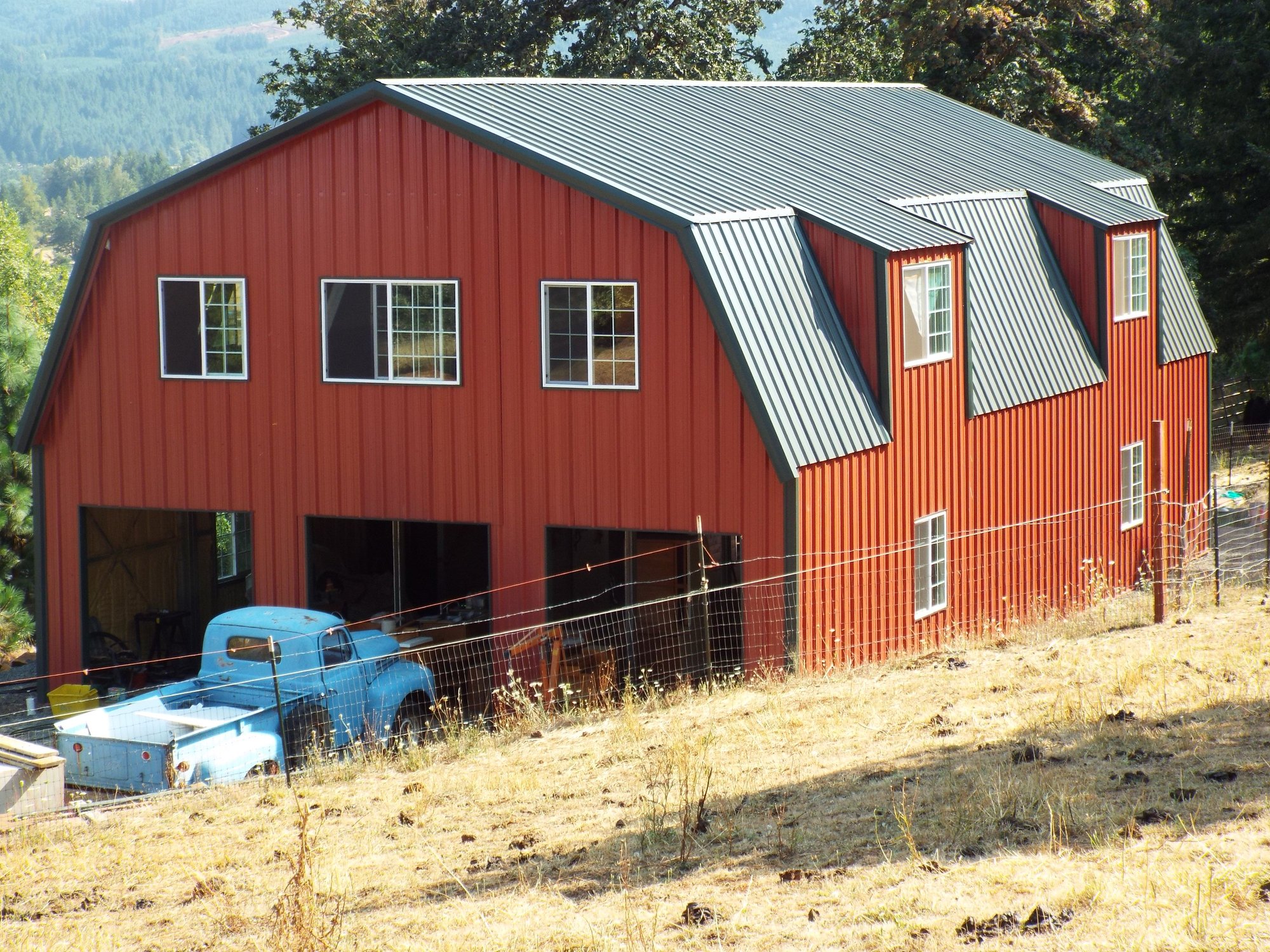

Wow, can't believe prices have jumped that much. I built mine 9 years ago, all steel kit $32,000, 4000 sq ft. including second floor. Did 90% all by myself with no equipment, just scaffolding, come-along and industrial magnets.

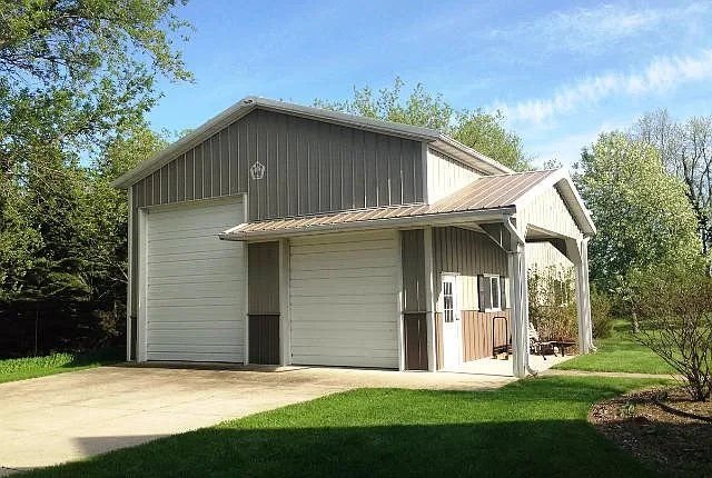

Just curious, what is the benefit of a steel frame structure over a wood framed building? Obviously it's a stronger structure but how many of us are going to need to hang things from the steel beams. I have a wood frame pole building that we insulated and heated and it's great. I suppose if I operated a business that had to have equipment attached to steel beams that would matter more.

I have a wood framed pole building with corrugated steel siding. I have the inside fully insulated and heated. The building, well just the shell was on the property when we bought the place about five years ago. I'm very happy with it. I don't know about wood rot. On the farm they have three pole buildings like this, one is 50+ years old, one is about 40+ years old and the one in the back 40 is around 30 years old. They are all just shells, the 40 year old has a cement floor, the other dirt floors. All are in still good condition with no real maintenance. All are build with treated uprights. I don't plan on being here another 30 years so as long as mine outlives me is all I car about.

As I've already mentioned elsewhere, Bob has a beautiful property. His shop picture above gives just a hint of what his yard is like.
