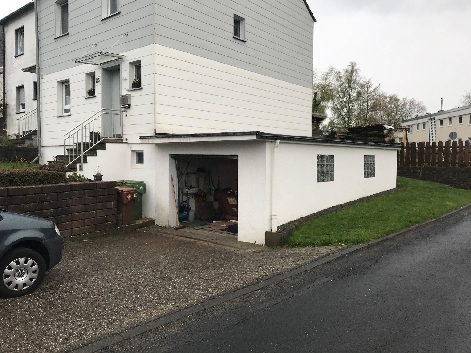

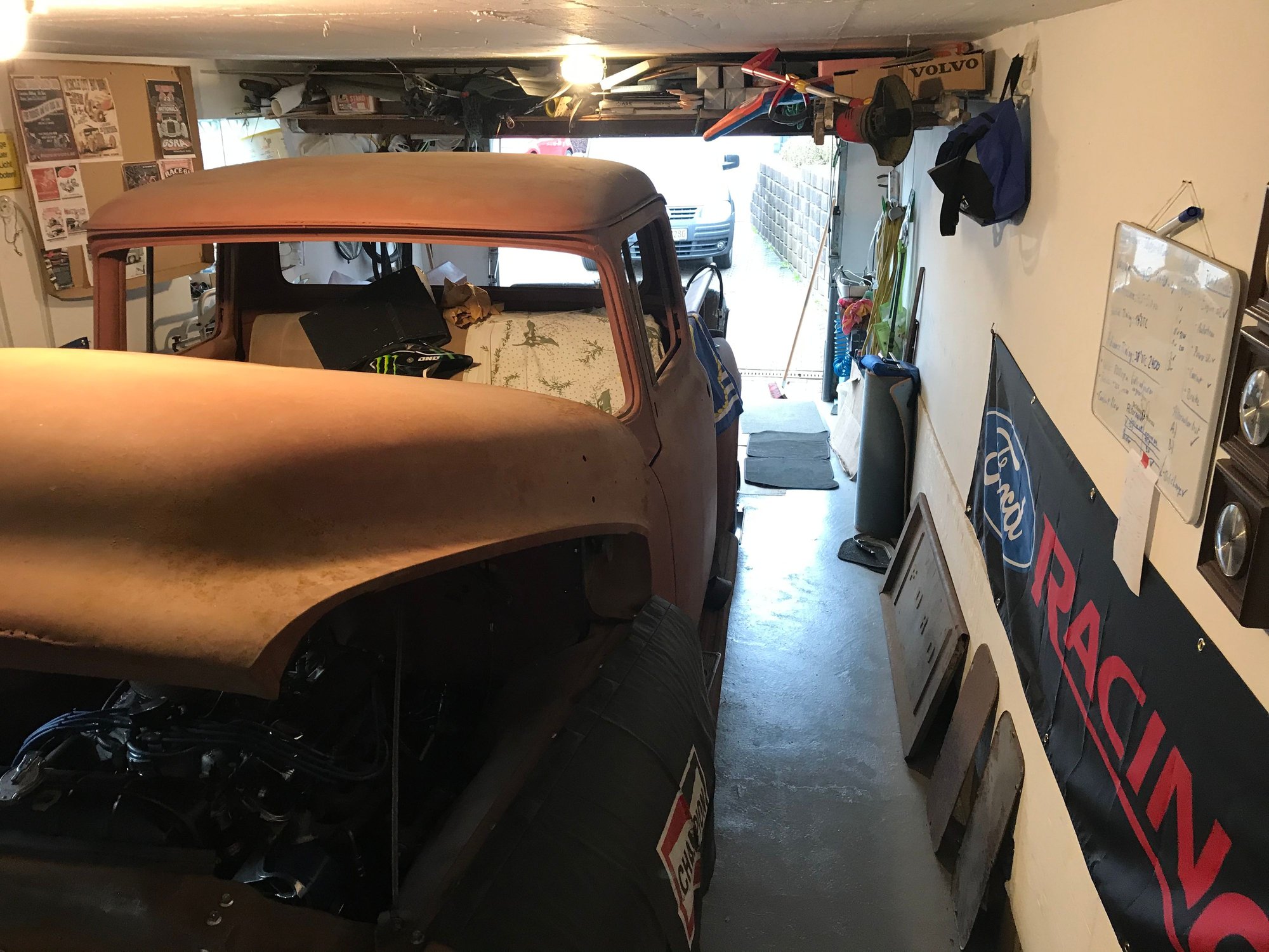

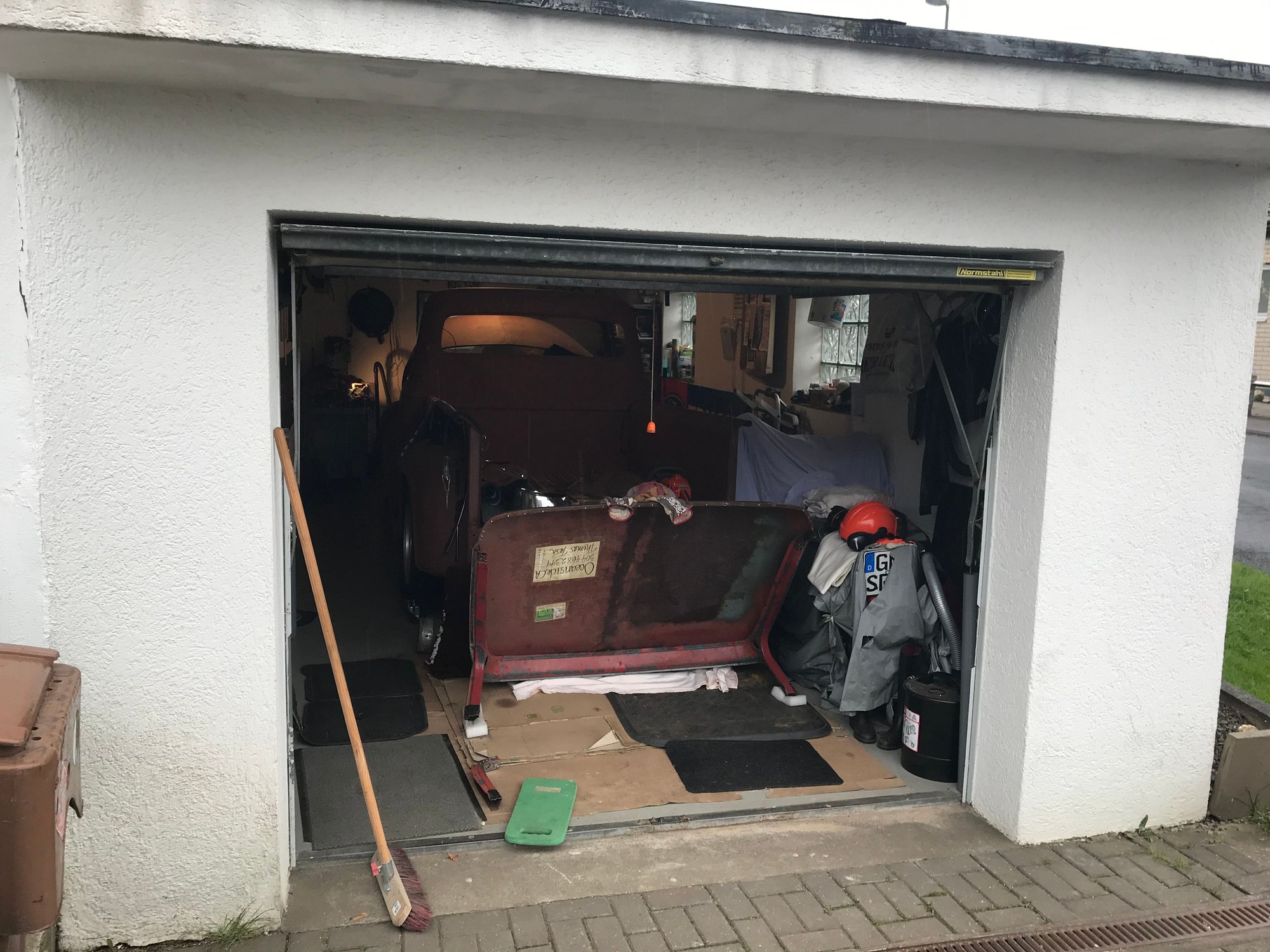

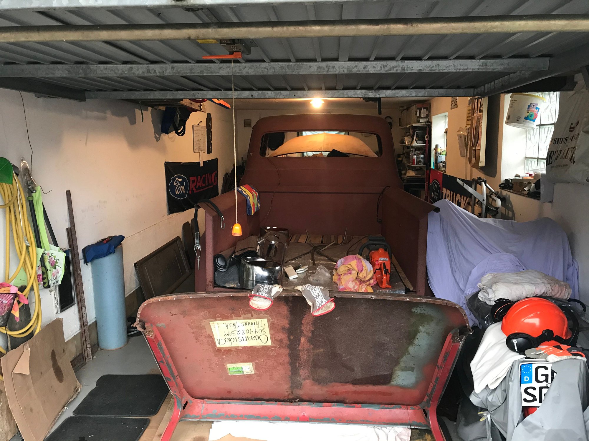

Crazy most of these shops, garages or barns a twice as big as my house.
My little garage in Germany 😉.
My garage.

Wow! That is a tight space to work in.

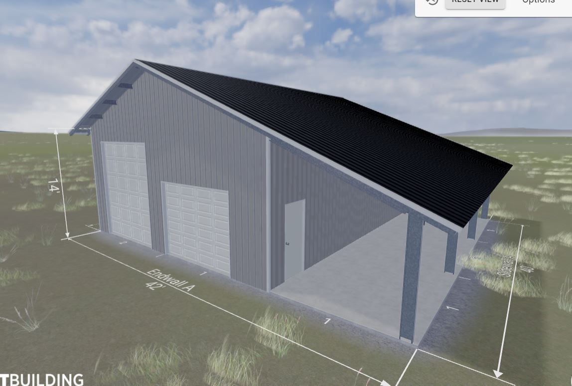

Joe,
Any progress on the shop?
I've signed for a 30' x 40' Pole barn back in May. Hope it will be built by February. See attached.

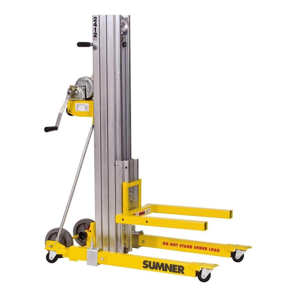

Yeah, I will study tools that I need closer as I study more and see my plans. If I could find a professional to install the building that would be the way to go. But that seems next to impossible these days.
It has 12' side walls with a 3/12 pitch. Peak height will be around 15'.
I think I got the name wrong. There is a contractor lift that I was thinking of. Not sure if there is a place to rent something like that though. Just weighing my options at the moment.
A telehandler would be awesome and there is a rental place less than a half mile from my house. But, I would want to make the most of the time with the equipment to save cost.

I would not use this in your installation, they are highly unstable on anything above 10 feet. We used these for lifting air handlers into the attic, even with the outriggers they have for them it was a very tricky lift above 10 foot. I would plan on a small gradeall forklift and two 16 ft scissor lifts, more bang for your buck.

Excellent, thanks for the info. Just what I was looking for. It seemed like it would be very handy, but the stability issue is important.
