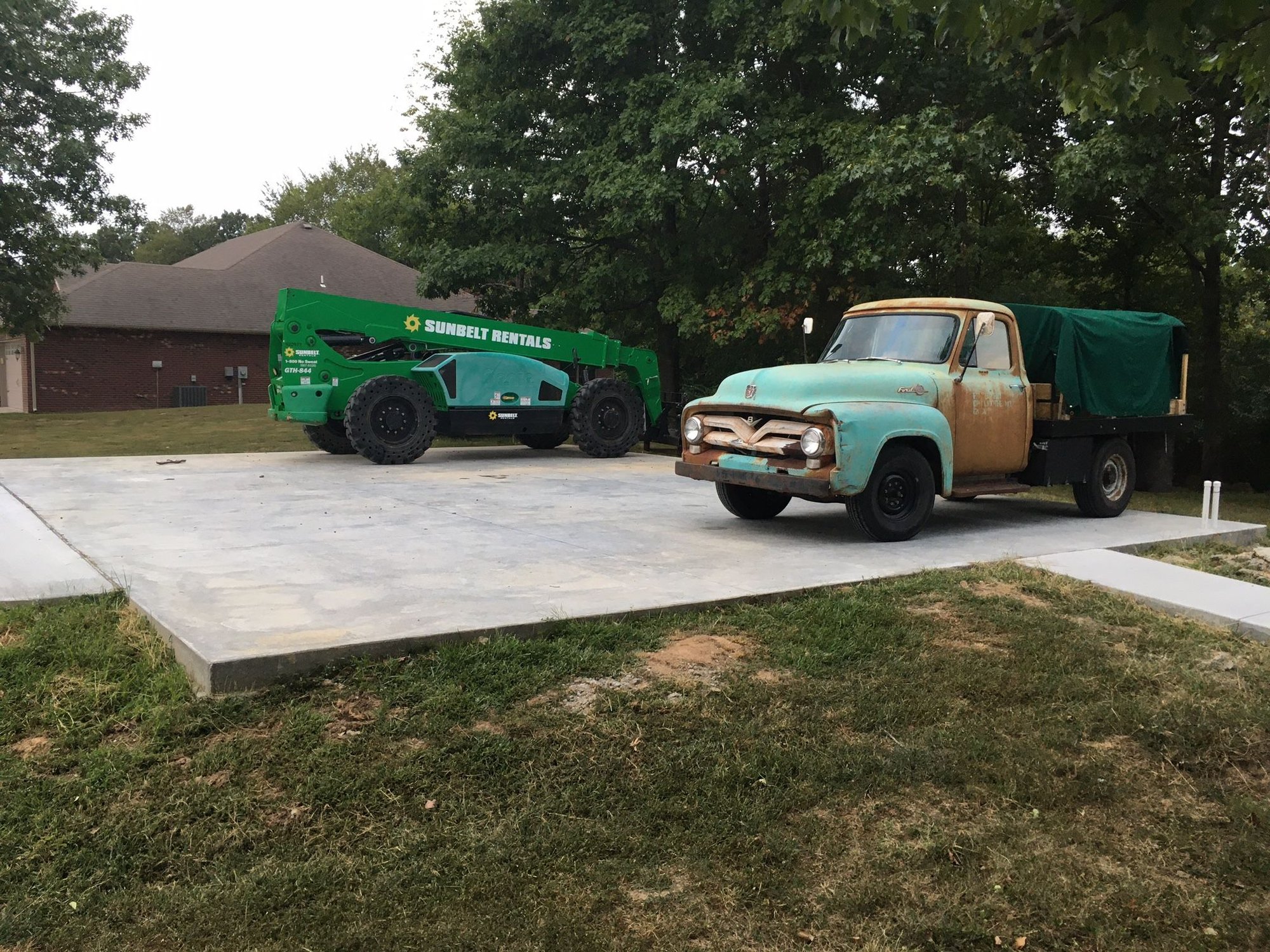

My forklift got delivered today. The truck is arriving Tuesday morning. Since they are closed for labor day they delivered it today.
Now I need to practice with it some. Unfortunately it will be raining tomorrow.
This one is way to big for the construction work. I'm not sure what they have that would be smaller. My largest semi load will be just under 3000 lbs. But for install, the largest I will lift will be small. Unless I assemble a wall on the ground and lift. I don't think that would be wise though.
They wouldn't let me drive it to my house. The rental place is half a mile from me. The wheels are solid to keep them from puncturing at job sites. But those wheels are $10,000 for a set and driving on roads wears them out.

Those lifts are great. Not hard to use. Key to learning is to do one action at a time, Lift only, extend only. etc. Your brain will figure out quickly what lever does what so you don't have to look at the pics above the sticks.

I think you'll find this will do a great job for you. These can not only be used for lifting but you can use it to support other sections while bolting things together, you can throw a chain or a strap on it to help square the building, you can also build a 4x8" platform (2x6 base with 4x8 sheet of plywood over it) over the forks and you have a great work space to stand on while up in the air.
Don't let the size bother you, they are very versatile. I used one of these once to roof our two-story walkout house (3 stories from the backyard) and it was awesome, everything went so much quicker knowing I had a safe piece of equipment.
