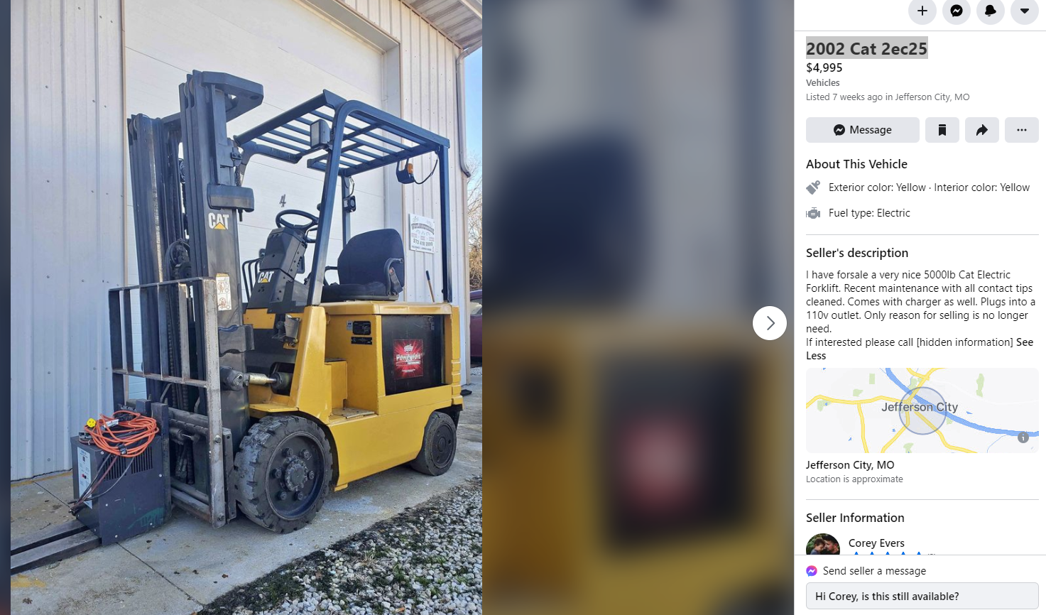

I'm wondering if I would be better off buying a forklift and then selling it when I'm done. Even if I sold it for $1000 less then I bought it for, I would be ahead.

The fork lift would be handy. A scissor man lift or boom lift would be very helpful too.

The forklift you have shown is not suited for off road use, it is a warehouse lift. Getting steel columns from drop point to and onto cement slab may be an issue, because of soil and site conditions. A gradall forklift is ideal
2005 Gradall 544D Telescopic Forklift; Details at ContractorAssets.com - Bing video
The task you are thinking about doing is huge and I commend you for thinking about it. Metal buildings take a whole new set of tools, thinking, logistics and equipment. This job you will normally see a gradall forklift , 1 to 2 man lifts on site, and an occasional crane. Get certified column anchor drawings. Anchors that are not preset to inbedded rebar may need a pull test, over half have to meet the pull. Column and sub purlin bolts all need to be torqued also normally. I have not seen to many, in fact none who have erected their own metal building of this size and I believe it is because of the equipment needed and the difference style of construction than the stick frame.
Sorry if I seem negative but I really do respect your thoughts, and if you decide to do this on your own, I do believe in the end it will be an experience to remember

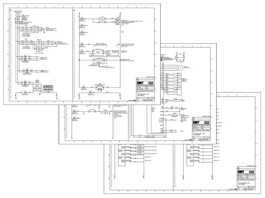

I agree, I build industrial controls which I find fairly easy, all I have to do is follow a wiring "road map", simple, just make sure the wires go where they are supposed to go.
I find it pretty easy but I've worked with a lot of very good electricians that can't do my job. The drawings I follow can be from three pages to 100, all depending on the size of the job. Simple.
