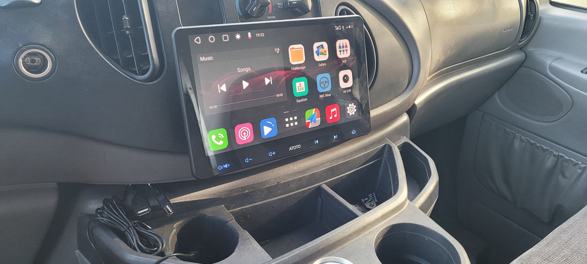

I've decided to join the ATOTO club and just took receipt of a 10" S8 Premium today. I took the advice of some other posters and found a great deal for a refurbished unit on eBay (paid $220) that looks to be brand new. I think it must have just been an unused Amazon return.
I'm still waiting on the harness to get here later today, but I do have one question before I tear into this thing. For those who have installed the 10" ATOTO units, are you using a dash kit to install these? The hardware ATOTO provided looks pretty useless for this application. I see some of you installing the smaller units have used the Metra 95-5817 kit - would that be a good solution even for the bigger unit? I feel like I'm going to need something to get it to snap in there.

Mine was only a 7", but from the pics of the 10" it's a double din chassis with a screen mounted an inch or two from the dash.
I used the Metra kit you mention, and it would work good for the 10". The screen would hide those stupid handles that stick out of the dash.
Edit: I don't have a van nearby to look at. I'm not sure how the radios mount in the van, but I would assume it's similar to the pickups. I had to cut out the radio opening some, even though my truck was stock with fords version of a double din radio.

I got the S8 Premium mostly rigged up today, but I can say that the Metra 95-5817 dash kit does not work with the larger head units. The little "handle" pieces on the end won't fit flush against the housing of the larger unit. It's in there for now, but it's not really holding on to anything, so I need to come up with another solution. If it's any consolation @kbeefy , I spoke to somebody at Metra before buying these who acted like I was an idiot for even asking if they would work on the head unit I described...
I haven't had much time to mess with the head unit itself, but it seems pretty sweet. It's way faster and more responsive than I had hoped. I'm not getting wireless Android Auto, so I'm hoping a firmware update will fix that. But between the ATOTO and the Edge CTS3, the van is starting to look a little high tech now!
