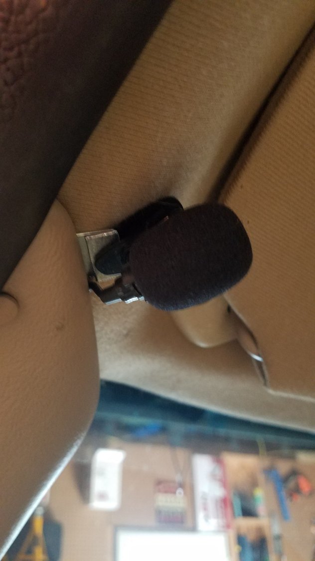

I made a little metal clip the attach the microphone plastic clip to out of some scrap sheet metal. Folded it over a couple of times to give it strength and field the sharp edges down.
It clips to the headliner and the lower leg sticks of the clip sticks out of the pillar cover. That little bit is what the microphone plastic clip attaches to. I can send you more detailed pictures via text if you like, just let me know.

The images below are what I sent to BWST via text today. I thought for the sake of 100% transparency I would upload them here too. The visor clears the microphone by about 1.5" and swings over to the door with the same clearance.
^^^Picture taken with rubber seal removed looking in at level from outside the door.
^^^Picture taken from directly below the microphone.
^^^Picture taken from just below and toward the driver seat.
