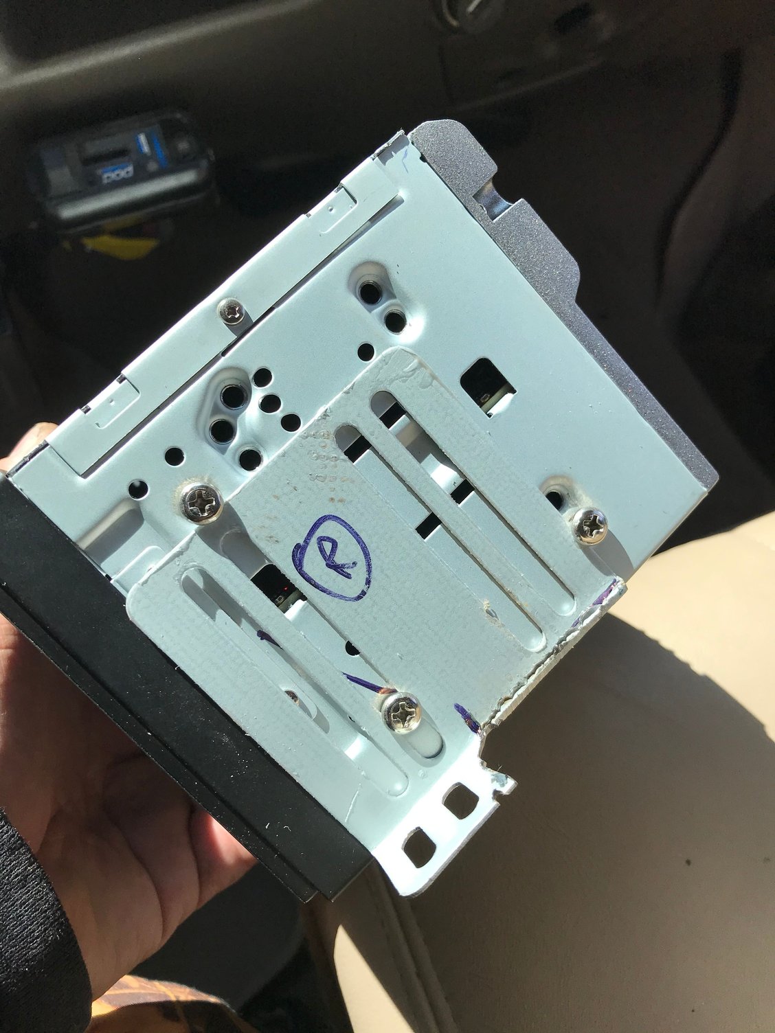

I’ll be sure to specify the model number the next time I recommend this unit. I prefer the hard buttons. Install was smooth and easy this time!
Here’s a couple pics of how I modified and used the brackets that came with the A6 Pro.

Thank you for providing additional pictures for the install.
I too prefer the physical buttons, hopefully your customer preferred the soft buttons. Either way, the head unit is a hit in my opinion and is very useful.
