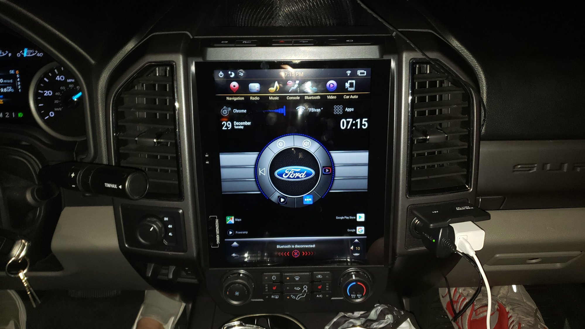

Went full send on an Android head unit in my 2018 F350.
@schlepprock250 , did you install a custom UI loader or is that a function native to the display? If you installed a custom loader, can you share with us which one it was? That screen is huge and looks nice.
I saw a video on YouTube recently where the owner of a 6.7L changed the "boost" gauge at the top right of the the cluster to the "DEF gauge". This tells him the level of the DEF tank. I thought that was a cool feature.
It comes as a complete stand alone head/entertainment unit with its own launcher, but I'm in the process of setting up my own added launcher. It's called Car Web Guru. This is what the stock launcher looks like.

Oh, so that was not a factory display? You added that yourself?
Feel free to post up information related to the install here if you like. I saw that custom launcher when I was looking around a bit at options for the ATOTO I bought. I am always looking to broaden my knowledge base and this may help me make a decision down the road if I ever need to replace the 7.3L.
Yeah this was a Christmas gift from my wife. 12.1 inch display Android entertainment unit. This particular unit has quite a few bad reviews. But after researching for quite some time before she purchased it, my opinion is most of the bad reviews are from user error and lack of understanding Android. Apple IOS is a good system, but it's simplistic and minimal compared to Android. Meaning if someone that's solely been an Apple iPhone user gets this Android unit they won't have a clue about setting it up and operating it. It's VERY complex. Add to that, it's fully married to the Ford Sync system so it retains all oem functionality. My wife and I did the install, took about three hours, and since then it's been flawless without any of the issues I've read about. One thing I will mention about issues people are having. I've seen so many posts in different groups I follow about this issue or that issue. The one thing they have in common is that the vehicle they are running it in has dual climate control and auto hvac. Mine is an XLT premium so I don't have that, I still have the ***** for the fan and temperature. The auto hvac and dual climate controls are married in digitally with this system, and I believe they don't quite have it right.
