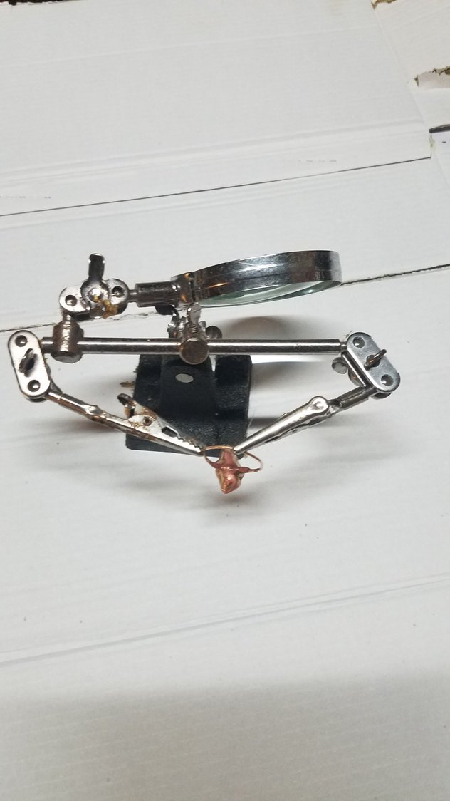

Used my Thing A Ma Jig like seen above to repair a rose gold crystal ring for my wife.

Tip: If you are working on free-hanging wires inside your vehicle with no place to rest the base, you can remove the base and use the arm with the crocodile clips from the Thing A Ma Jig to hold two wires together inside your vehicle as you work on them I will take a pic the next I do this.

I had not thought of that Leonard, thanks for the advice. I am sure that will come in handy in the very near future.
