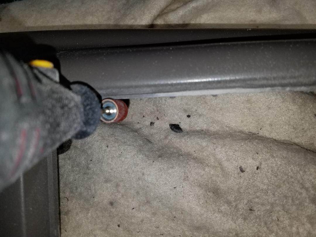

Here's where I put the WIFI and GPS antennas. WIFI is over the radio, and GPS is near the vent - hoping these spots will work without interfering with each other.
The Scosche install kit from the video ended up not working for this radio. I used the mounting brackets it came with. Here is a pic trimming the dash bezel top and bottom lips with a sanding bit. Finished with a flat file.
The S8 was catching on the center support. I had to fight it a bit to get it to go the first time. Needed to be able to test fit and remove several times, so took a couple of taps with a punch and mallet to bend it down just a little to allow the headunit to slide in.
The metal mounting brackets were trimmed as shown and mounted so that they help tilt the radio up a bit, and allow it to be installed to the correct depth.
The screw location marked above is set about 1" down and 2" back from the front face of the radio. It will eventually get a spacer between the radio and the dash opening on each side, so the screws can be tightened securely.
The lower brackets probably need to be secured in some way, but I'm leaving them as is for now - will eventually pull it again to install the backup camera.
There are small gaps on each side of the radio, but it's small enough that I can live with it.

Jeff, I would not worry about the WiFi antenna and the GPS antenna interfering with each other, for two reasons. First, I had them set up nearly on top of each other on my kitchen table and the GPS antenna was still able to pick up 9 satellites inside the house, in a valley with tall trees surrounding us and with the WiFi antenna right next to, if not overlapping it a bit. Second, smartphones may have some shielding between the WiFi and GPS antennas, but they are so close to each other that this scenario lends to the idea of no interference. I know that some devices will use WiFi as an alternate or additional means of acquiring a GPS location (GPS-A), which also tells me that the antennas play well together.
@BWST Jeff, your installation images and description are invaluable and will do a fine job of being a visual aid for years to come. I had the thought of making a video about the installation and accessories I/we have selected. Would you mind if I used your images in order to provide a second look in the video? Of course, I would provide credit to you as I have provided credit to the appropriate parties in all of my other videos.
For the spacer between the plastic and stereo, do you plan to use another large fender washer as you did on the outside? Coincidentally, I have a fairly large collection of these washers...
As for the lower brackets, due to the HVAC controls being there, perhaps a flat head screw came up up from the HVAC cavity and secure the brackets down with a nut and locking washer.
Is the thin black bezel around the S8 the one that came supplied from ATOTO?
I really like how you brought it forward toward the seat a bit, I think that is the same approach I will take.
I must admit, the S8 looks sleek and very clean. I just didn't feel comfortable with soft buttons though and prefer the use of the physical buttons. Good thing we have the ability to make the choice for ourselves.
