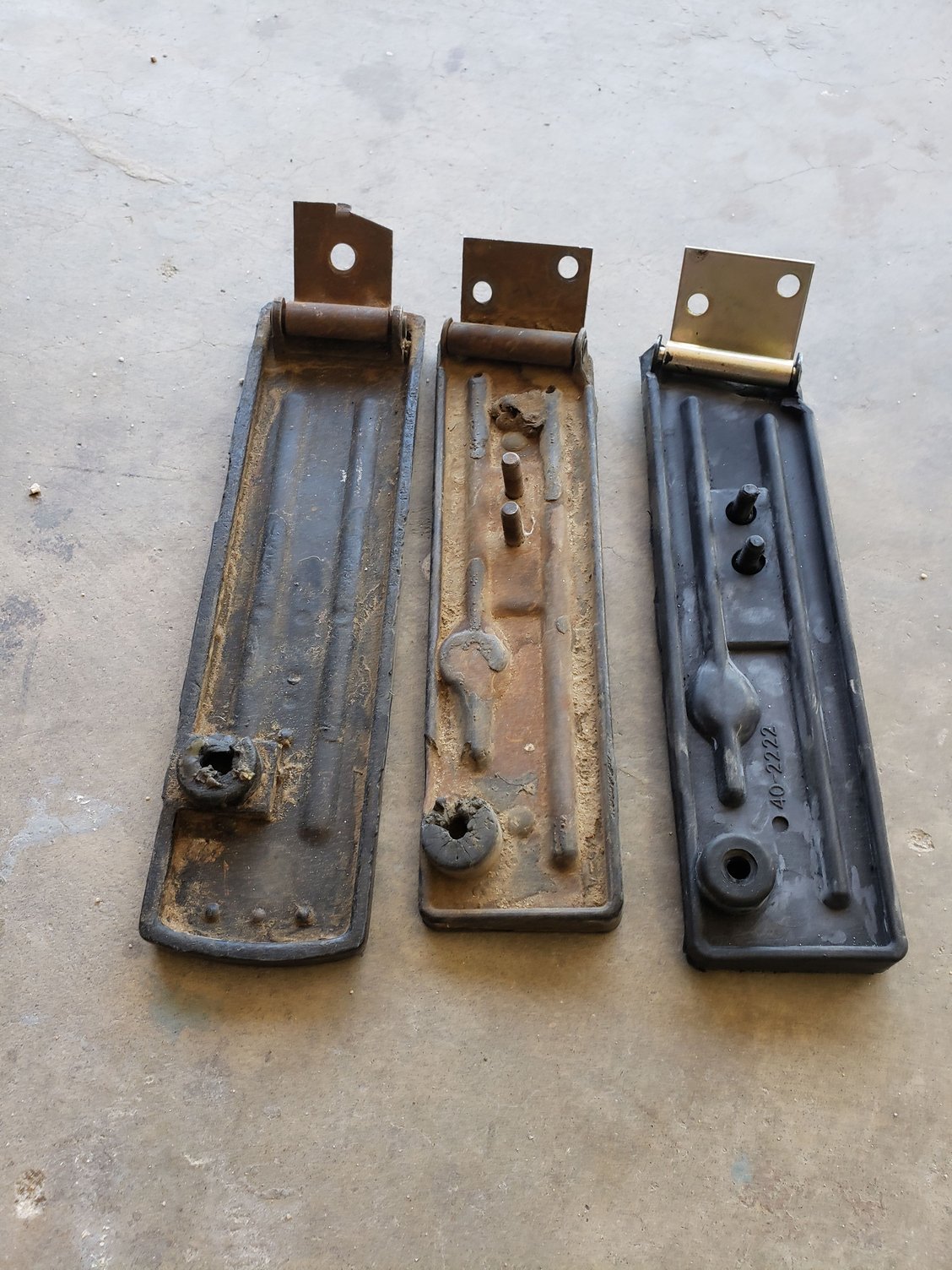

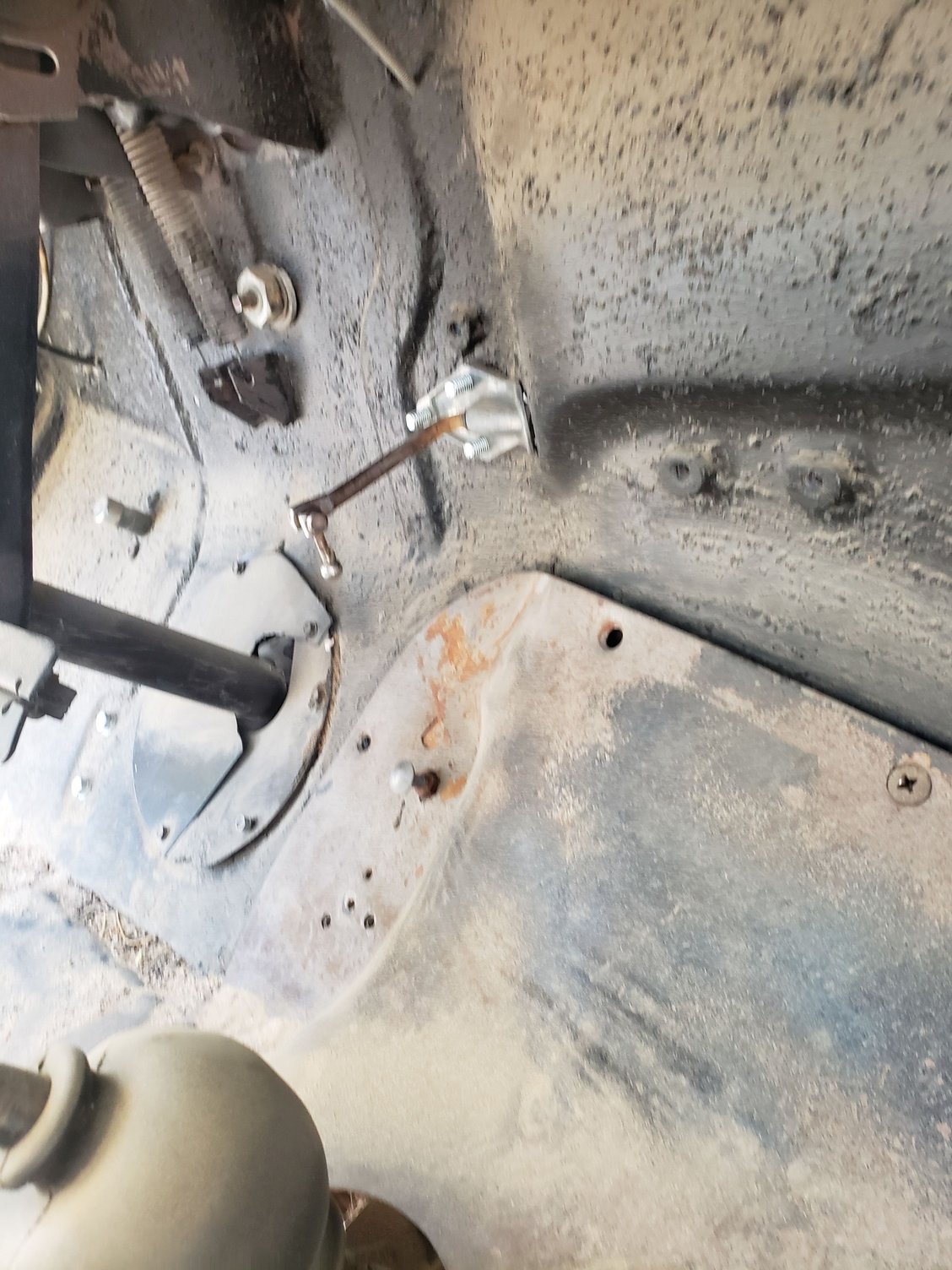

LMC has the holes correct. I need to lengthen my throttle linkage to install mine. Neighbor that gave me the Carter adapted my linkage but looks like rod is too tall to connect pedal. Can't find old pedal or pedal from f600 donor. One of them had three holes. Tried both but neither would stay on. Anyone know what height it should be with throttle pedal up?

Found my old pedals. Two holes iffset was on f600 donor. Big hole with tab was from my f350 cab Trans cover has holes for either. Now to figure the linkage length.

when I did mine it was based on full throttle being bottomed out synchronized with the throttle plate rotation. I think the measurements can vary based on application and geometry.

I think I'll have it. I started from pedal. Pedal down, throttle full open, connect linkage after tweaking a little.
