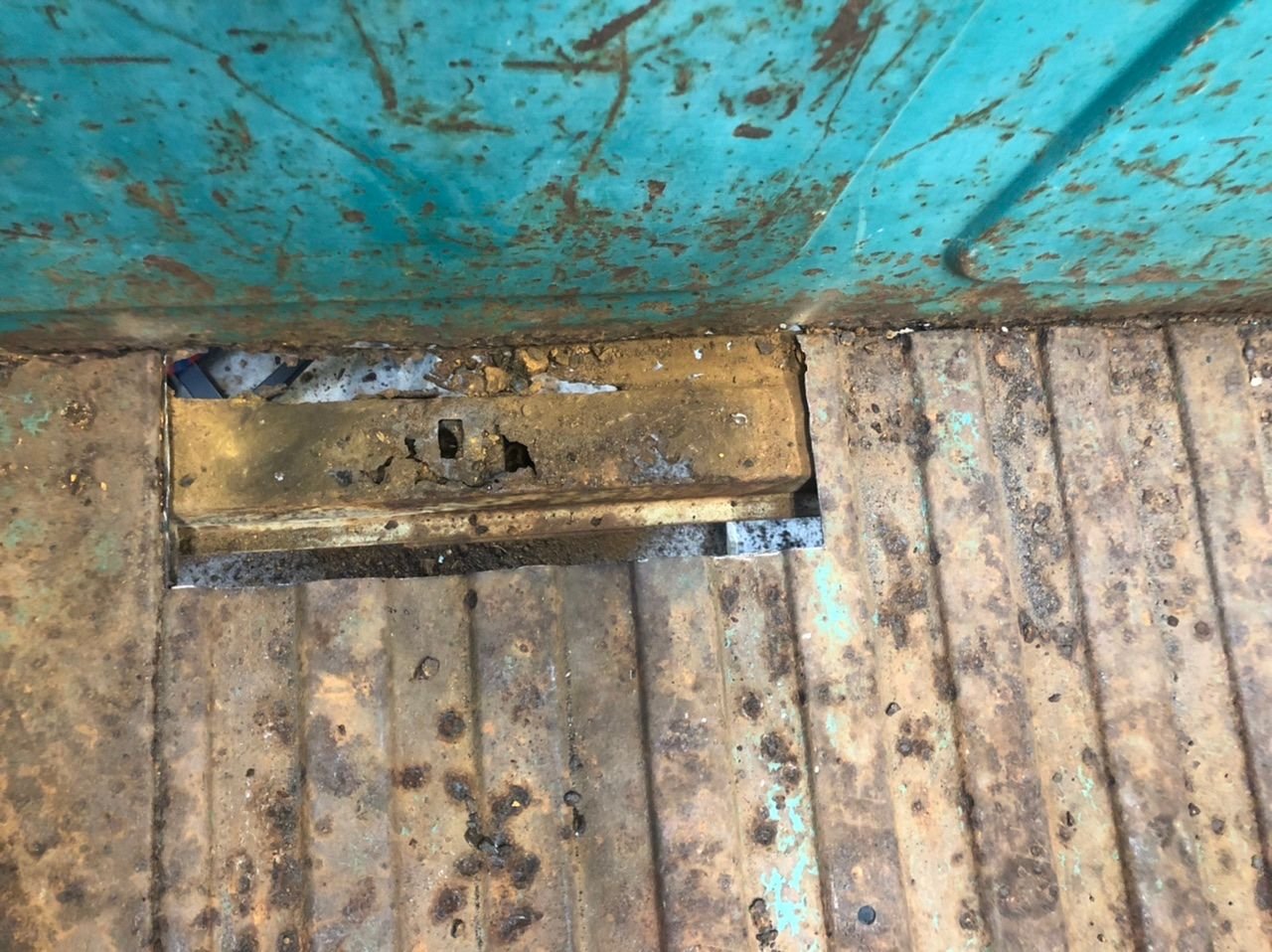

The bed repair is uglier than I had hoped! Its one of those “Where shall I stop” situations.
The bed was left with fir needles and debris in it for years before I acquired the truck. The front seam was ruined...
How does the rest of that brace look from the bottom side? Road sign post are pretty good replacements, at least that is what the big boys tell me.
brace is solid except where I exposed it here. I will repair it before replacing the bed floor.

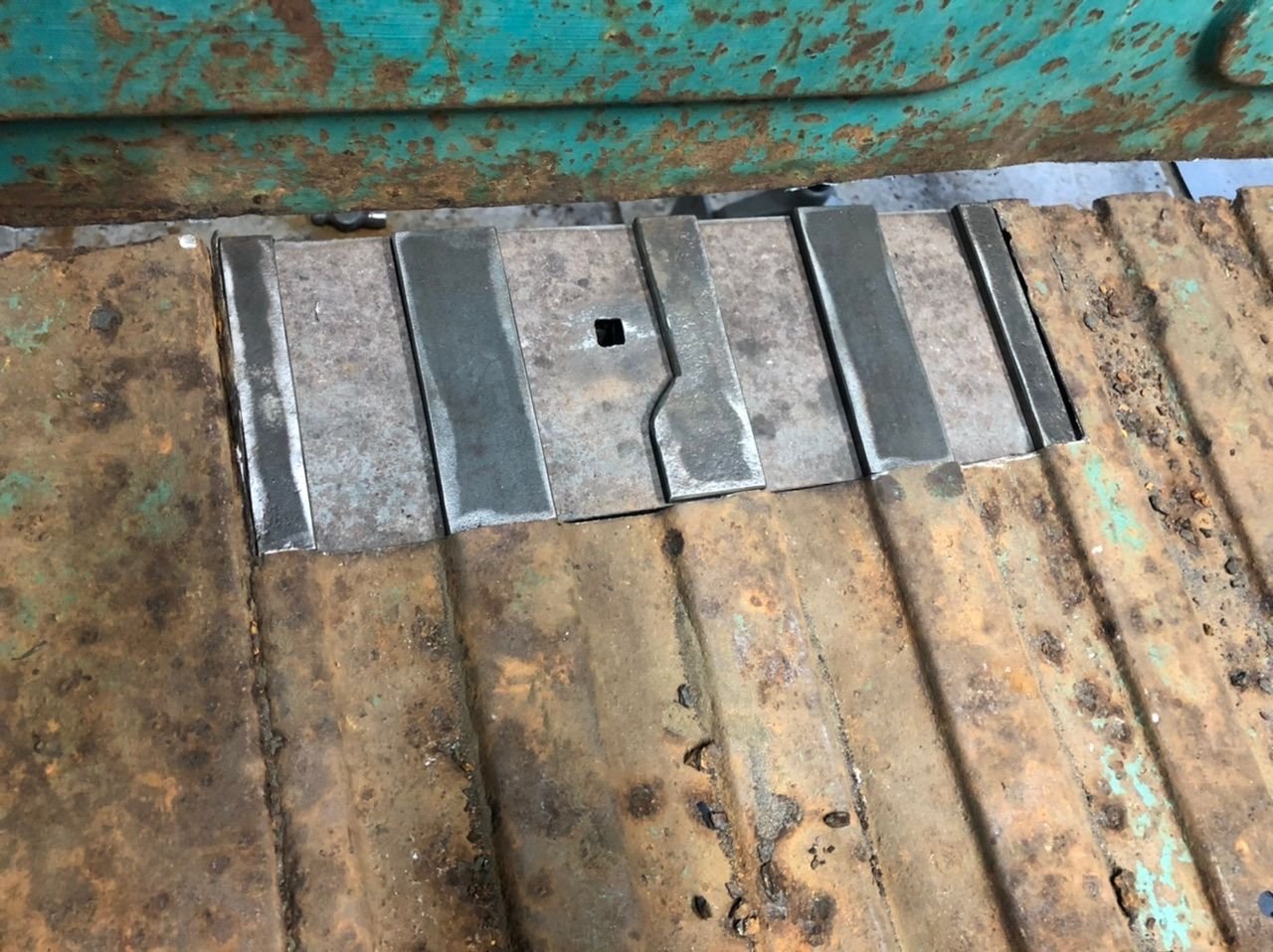

Thank you, all encouragement is helping keep me motivated! I am building my dream truck to my specifications and sometimes they are very hard to achieve. Home stretch!
Todays layout for bed repair. I didn’t find easy replacement panels so it will be solid steel. The top and bottom “ridges” are 1 5/8” with 1/4” rise. I will fully weld in the bar stock on top of 1/16” plate and clean the welds to fix the hole.

Hand made bed floor. Now that is awesome. You are not scared!
