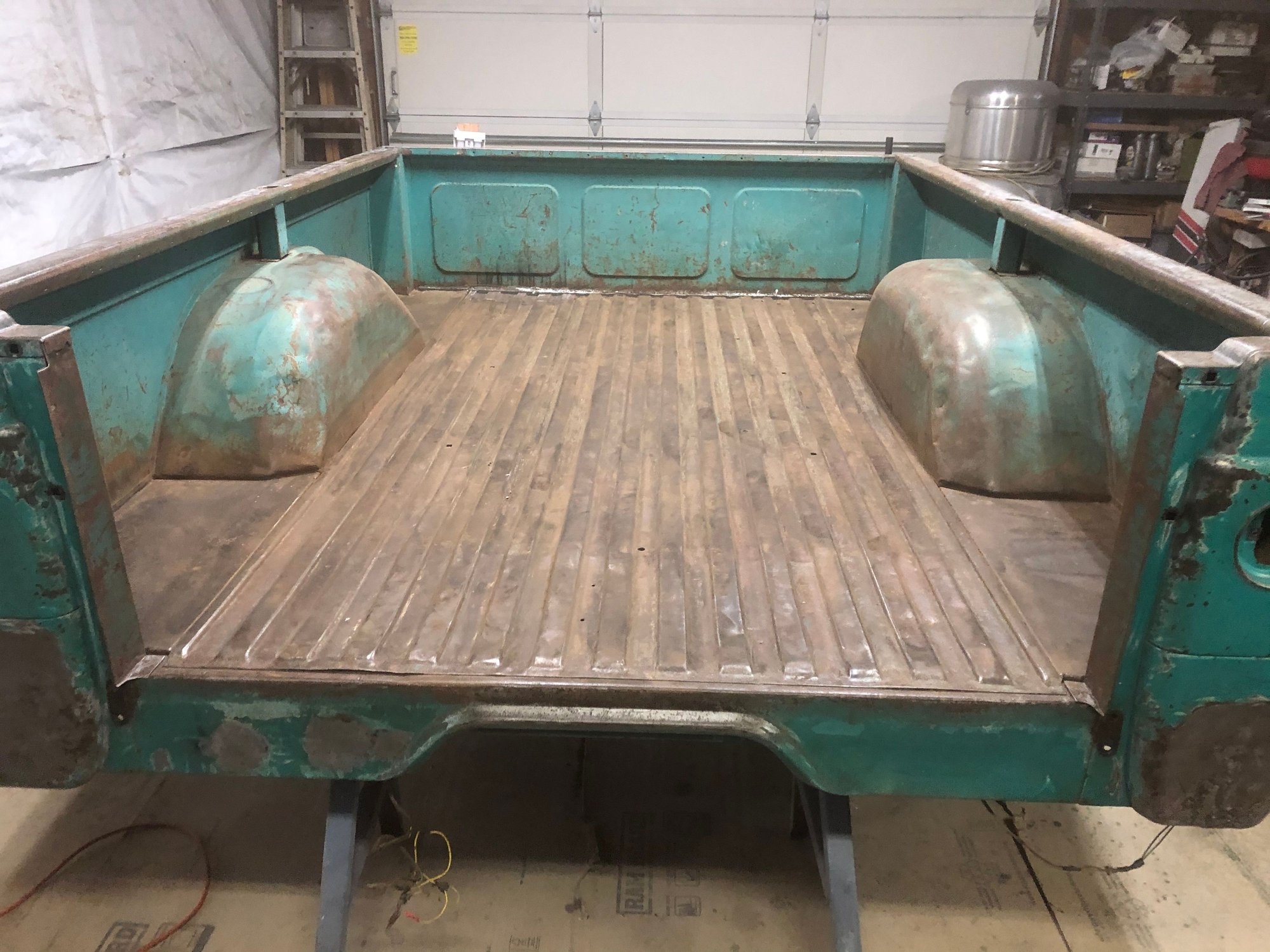

First pass on bed rust removal. The anglehead grinder with the brush is a heavy man-eater! One hour manhandling the grinder and I am whooped for tonight!
1st pass is done WHEW!

You can tell a difference for sure. You might want to stand that thing up on it's end to make it less back breaking.

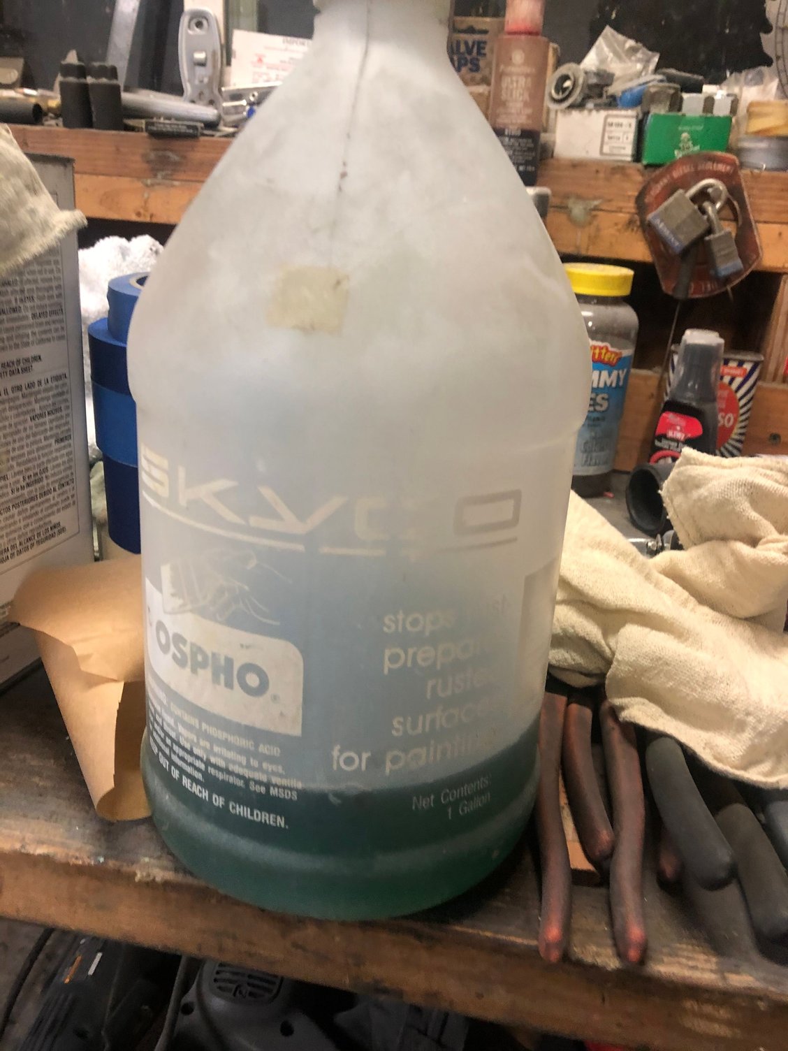

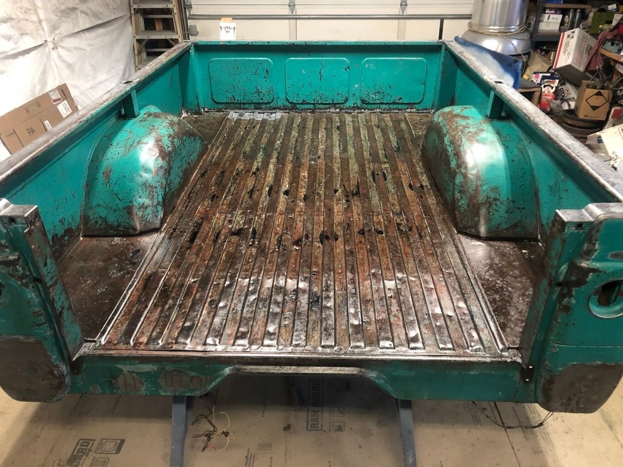

I am impressed with the OSPHO phosphoric acid rust converter! It turns the rust you cant brush off to iron phosphate (inert and can not rust further)!
After a degreaser wipe-down the bed is ready for bedliner.

That rust converter is impressive. Where did you purchase it?
I got it from Ace Hardware but see it online too.

Does anyone remember "Naval Gell? It was thick and you brushed it on rusty metal. I think you left it overnight then rinsed it off. The Ospho looks better.
Pretty impressive transformation. Will it get duller or is it wet? Pretty cool stuff.
