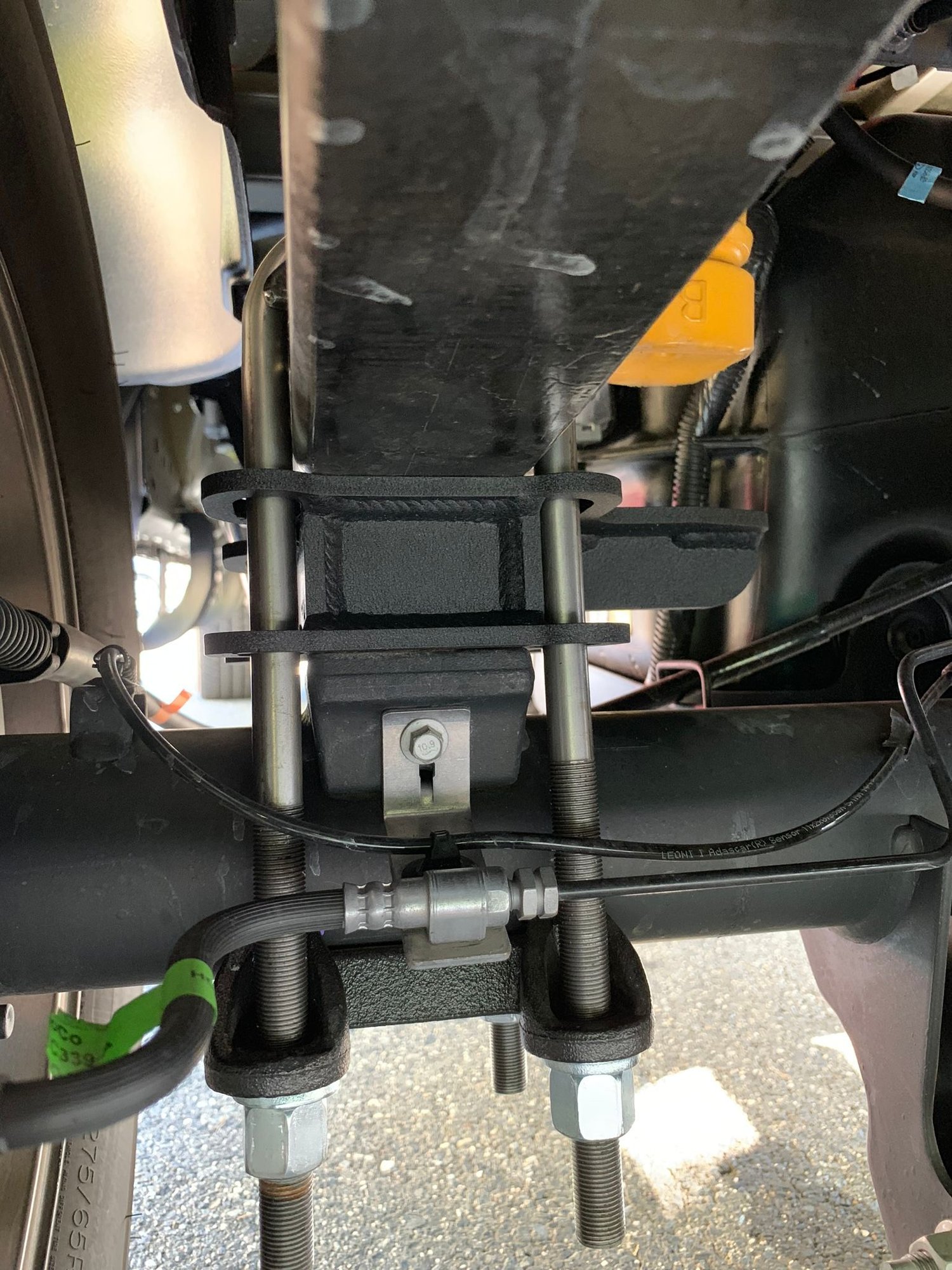

I lowered my rear yesterday. Went from stock 3 1/4" blocks to 2" blocks from pmfsuspension.com (with new u-bolts & nuts). Happy with the results. Stance is still raked, but not as extreme. And as others have mentioned, there does seem to be some minor ride improvement.
Thanks to cficare and his awesome write-up with pics. I already had a 3-ton floor jack and 6-ton jackstands, but not the pedestals. His write-up helped a bunch. I built pedestals similar to his (only one pair) and they were needed. My pedestal dimensions were 12"x10.5"x6.5" and used all of a single 8' 2x4 for each one. The 12" length fit my Big Red jackstand dimensions well. Also from his write-up, I had a 24mm deep socket, but it was a bit loose on the nuts, so bought a 15/16" deep socket and it fit better.
https://www.ford-trucks.com/forums/1...l#post17607426
Took me a bit over an hour and half to get it done. Before breaking the nuts, I spent extra time trying to figure out how high to jack the axle before settling onto the jackstands leaving an inch or so with the tires off the ground, for lowering the axle to remove the current blocks. Had to get the wheels a good 5 or 6 inches off the ground. Jackstands were positioned under the forward leaf spring bolts. Seemed a better spot than on the box frame or further back on the hitch frame. Big Red jackstands were 6 teeth showing, and on the pedestals, reached a height of 27". Jacking under the pumpkin (I know), I used just about all the 18" height the floor jack was capable of. I added a block of 3x3 wood to the floor jack pad to get the axle high enough to release the jackstands when done.
Breaking the nuts wasn't too bad with my 18" breaker bar. I don't think they were torqued to 185lbs. After a few turns with the breaker bar, I switched to my 12" ratchet for faster removal (I need air-tools). Everything went smoothly following cficare's write-up. It took a bit of muscle to get the new nuts torqued to 185lbs.
After the job was done, the sun was going down, so I found a clean wall to pull up to to adjust the headlights. Also per cficare's notes, I positioned the front axle 160" from the wall, chalked the headlight beam on the wall, and used a 6mm hex on the white nylon bolts to lower the headlights roughly 1 1/4" to counter the rear lowering. Haven't driven at night enough yet to know if that was good enough.
Will add before & after pics of stance when I get a chance.
Thanks cficare!

You'll find those wood pedestals come in handy for all sorts of things around the garage. I even helped move a neighbors small sailboat with them. Inverted the pedestals atop a moving dolly and the transom rested neatly in the gap of the (normally) bottom 2x4s. I also use them to raise the height of a trash can when cleaning / sharpening chainsaws at my workbench.
You broke the nuts loose with only an 18" breaker bar? You must be one strong dude. With half of the jack handle slipped over my breaker bar, I was having a tough time using almost 4' of leverage. The torque wrench I bought for reinstallation is about 30" long (I don't recall the exact length).
FWIW, I have since installed a pair of Torque air-bags for when the loads get a little heavy.
