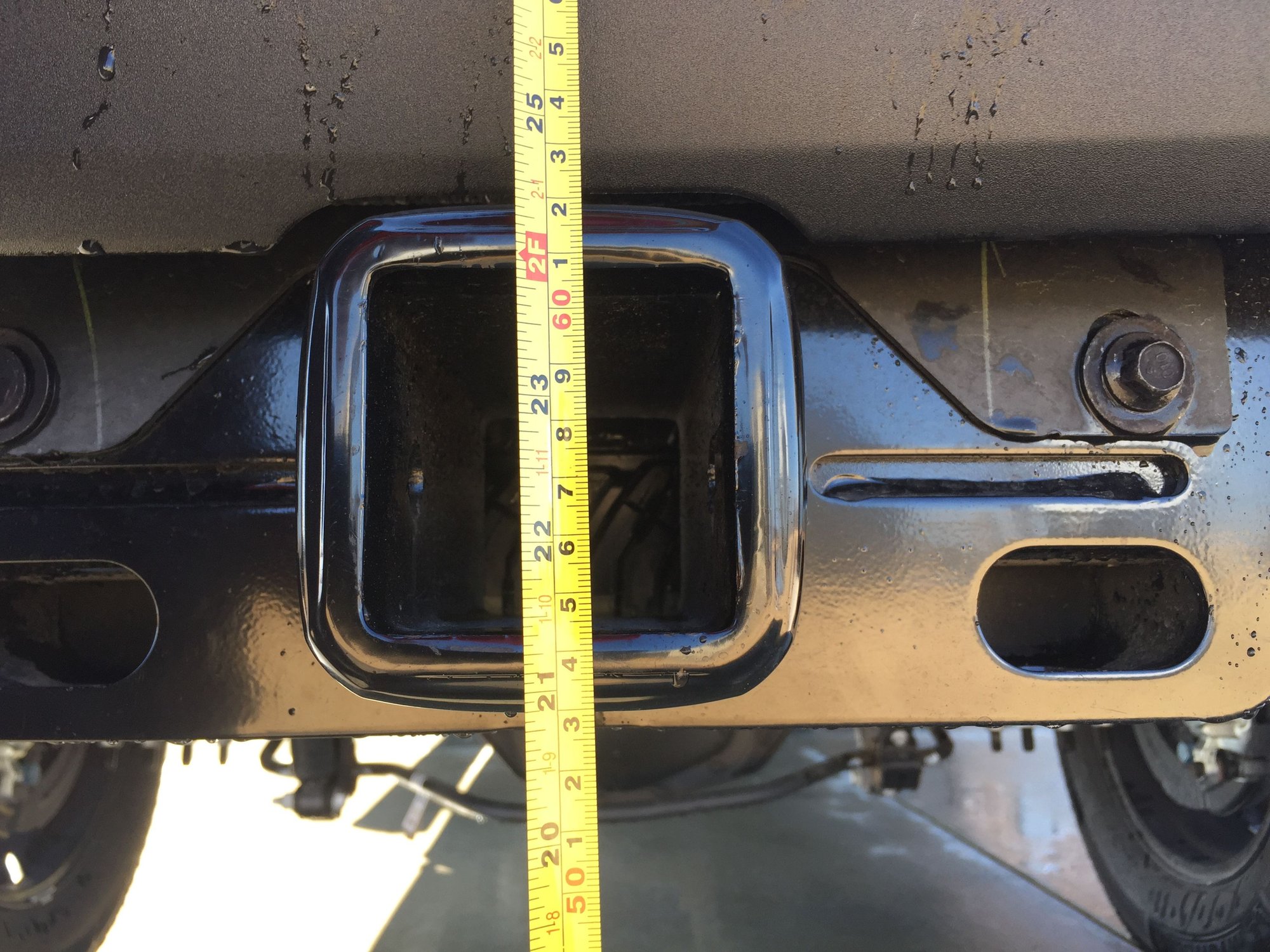

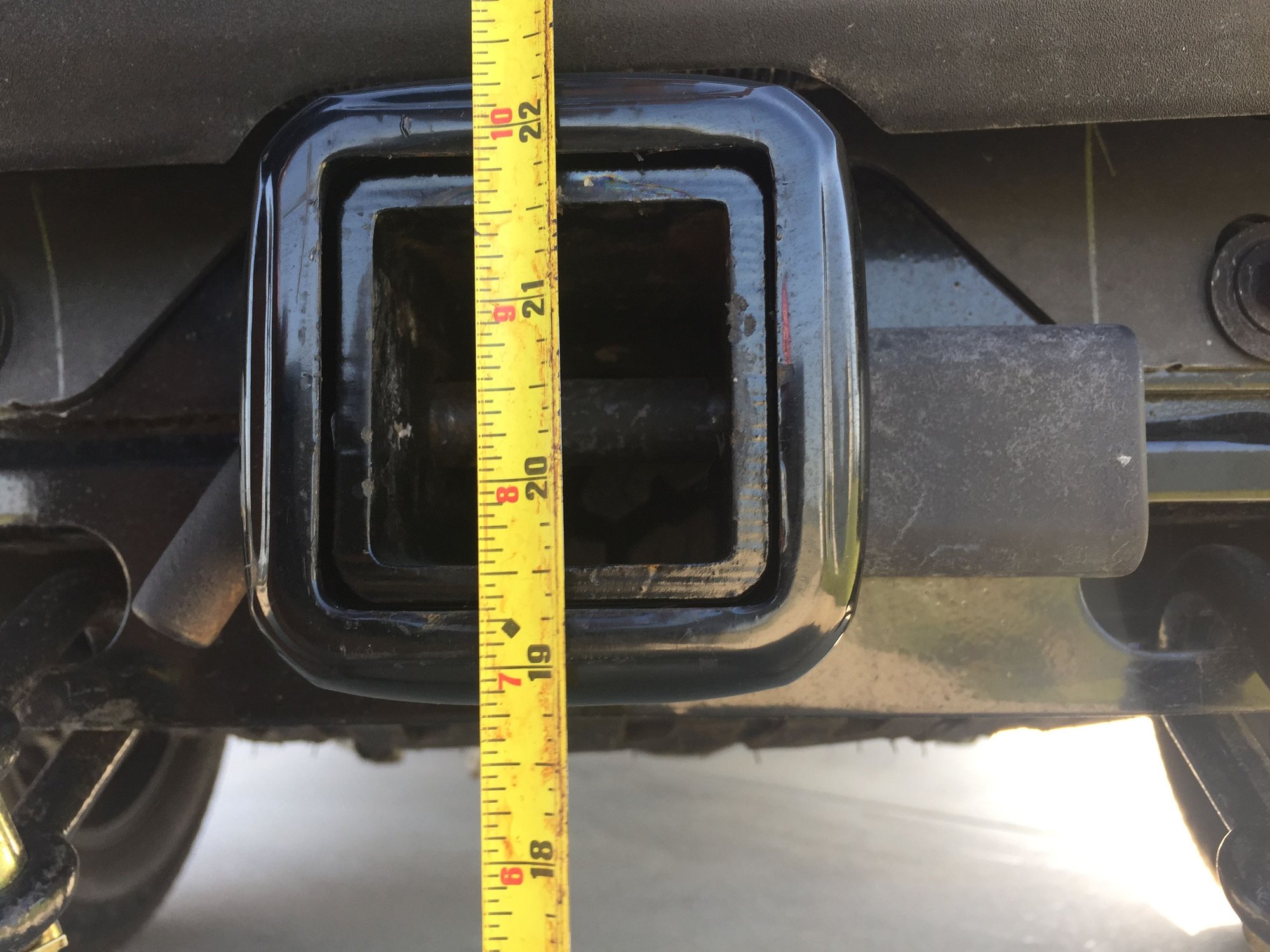

Stock spacers
Lowered with 6C3Z-5598-A
Ever do something and wish you didn't?
WELL I lowered the rear utilizing the spacers from Tasca Parts Ford (6C3Z-5598-A) https://www.tascaparts.com/oem-parts...acer-6c3z5598a and let's just say THIS IS NOT ONE OF THOSE SOMETHINGS!!!
Before and after pictures with and without the horse trailer attached soon but here (see pictures) is the result as measured at the hitch.
The ground to lip of wheelwell measured Premod front 42.5 rear 45; POSTMOD 42.7 and 43.5 so still have about an inch of rake. Tire pressures at tow PSI of 80 for all measurements.
I may be crazy but I think the over all feel of the truck is much better; the wife even made a few approving comments. I will exercise it a little next week to truly see but it is pretty amazing the difference in appearance as well as functionality (rear view mirror) and being able to see into the bed.
No driveline vibration but will keep track for as long as I remember to.
The shop that made the swap used new u bolts/nuts for those so interested in that conversation...
