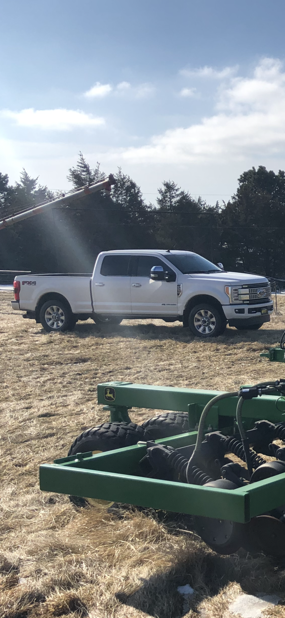

Here’s mine with 1,300 lbs placed on the very back of the bed. I have the 2” PMF blocks. Sorry the picture isn’t the best, it just happened to be in the background of another picture I took, but I figured it did kind of answer your request.
Originally Posted by Retiredout
Looks nice leveled with no additional weight added to back of truck. What does it look like when you add 1,000 pounds of weight to back of truck? How much will it sag below the current leveled position? Have heard a lot of discussions about leveling the truck and seen a few pictures of after it has been leveled. Let’s see some pictures of the leveled F 250’s with a 1,000 pounds of weight added to the back of the truck so we can see how much sag in the back there is? Any pictures that can be posted about this for comparison when loaded after doing the leveling modification?
