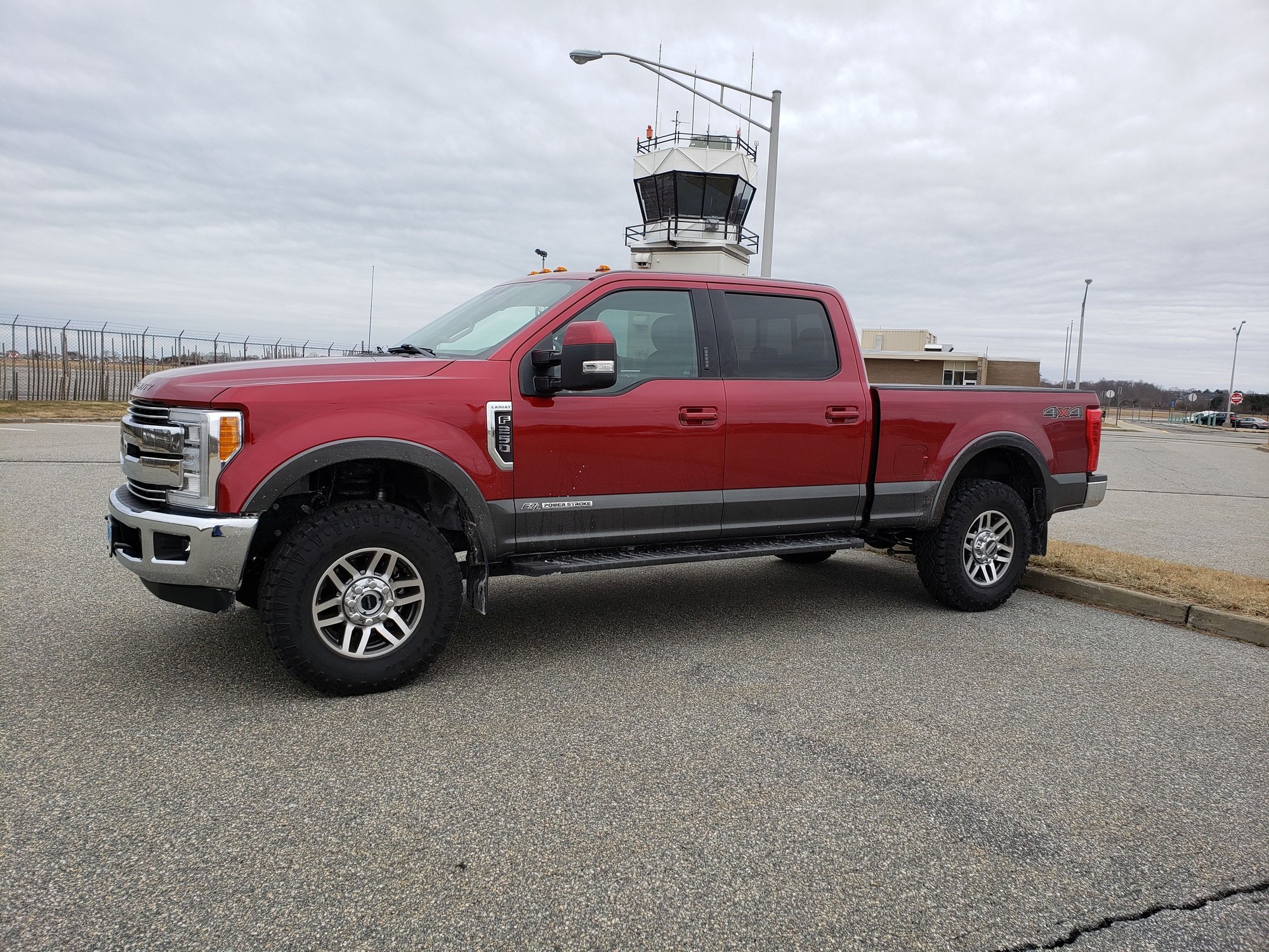

Got a few pics at work. Wish the lot was level. I Re-read my post above. I did have these 285's on before I lifted the front an inch and had no rubbing. These 18's are my winter set. The truck came with 20's.
