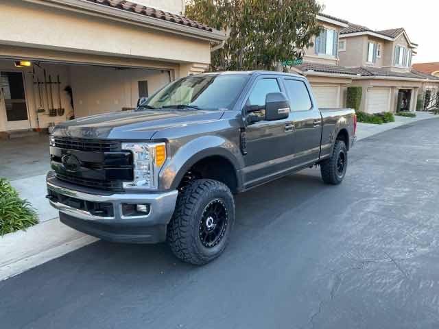

Put the new blocks in last night. Bigger pita (by myself with floor jacks) than I thought it would be but got it done. Stupid pins didn't want to line up.
Still has a little bit of rake which I wanted.

Thanks, the difference is subtle but it looks much better imo.
I used PMF blocks with their air bag brackets. Very happy with them.

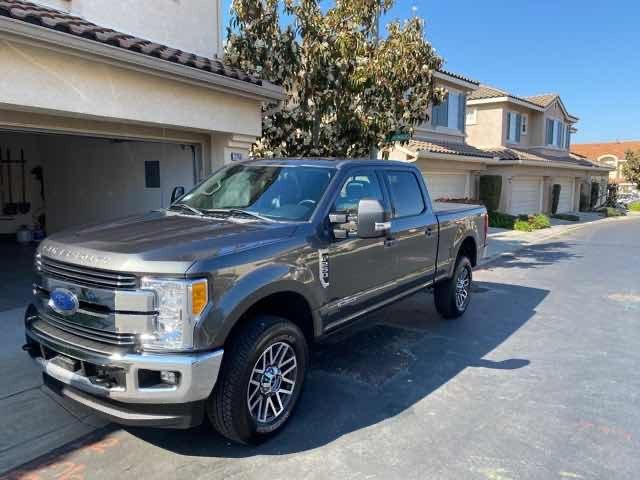

I went with 2016 4wd lift blocks, which lowered the rear about 1.75”!
Love the stance now!
Oh, also added a level kit from camburg
Before:
